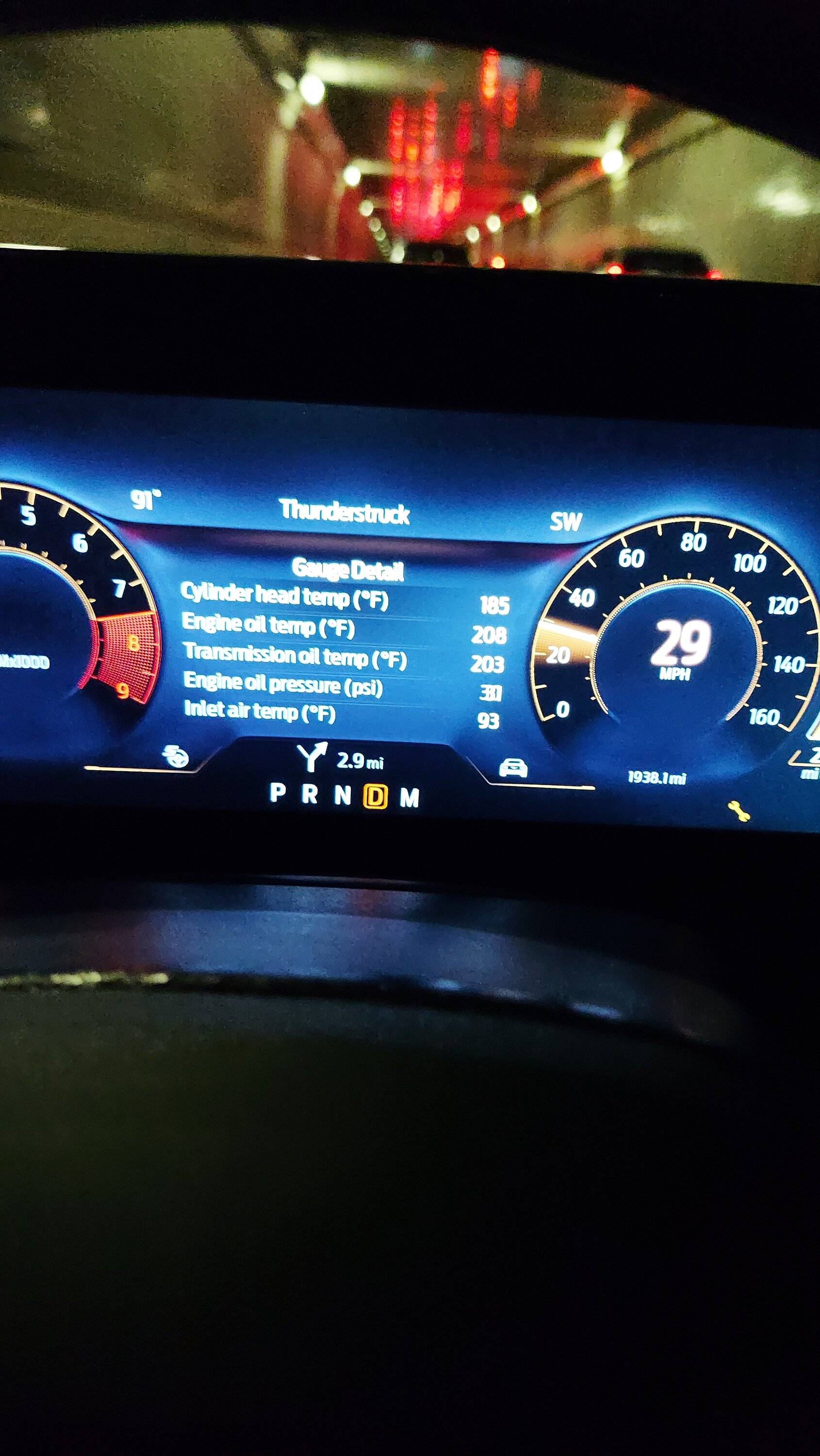

Happened on the highway. Powertrain malfunction. Put me in limp mode but it cleared as soon as I parked. Should I take it in to get looked at? Seems fine now. I've been beating on it a little bit and no more issues.

Wait a minute, I see the picture and noticed that you went through the tunnel and wondered if that was causing the problem? Would pulling off to the side to restart the car after getting out of the tunnel would work?

It wasn't in the tunnel. It was on the highway just went in limp mode while driving. As soon as I stopped and restarted it went away.

What were you doing when it happened? All your temps look fine.

Just gave it a little gas to pass someone on the highway. Only doing 55-60. Nothing ridiculous. Seemed like a transmission hiccup on the downshift. 10A car.

check your fluids; IDK about coolant, I’d not heard of that one before, but Ford is pretty aggressive about motor preservation strategy and oil level is definitely one that will send you into limp home mode. Definitely hit up @roket and see if you threw a DTC.
or check with FORSCAN....

Interesting. Going into limp mode without a CEL seems weird to me. I'm glad it's back to normal. But if my car when into limp mode I'd definitely bring it into the dealer and at least have then check the trans fluid. I'm sure they can dig up some data on the event as well. These cars record everything.

I've had other cars have similar incidents. Could have been a traction control incident. Get those in my jeep sometimes on sand dunes if I forget to disable traction control. If no repeats I'll be okay until the first service. Trans temps are normal and everything is under warranty so no real worries.
