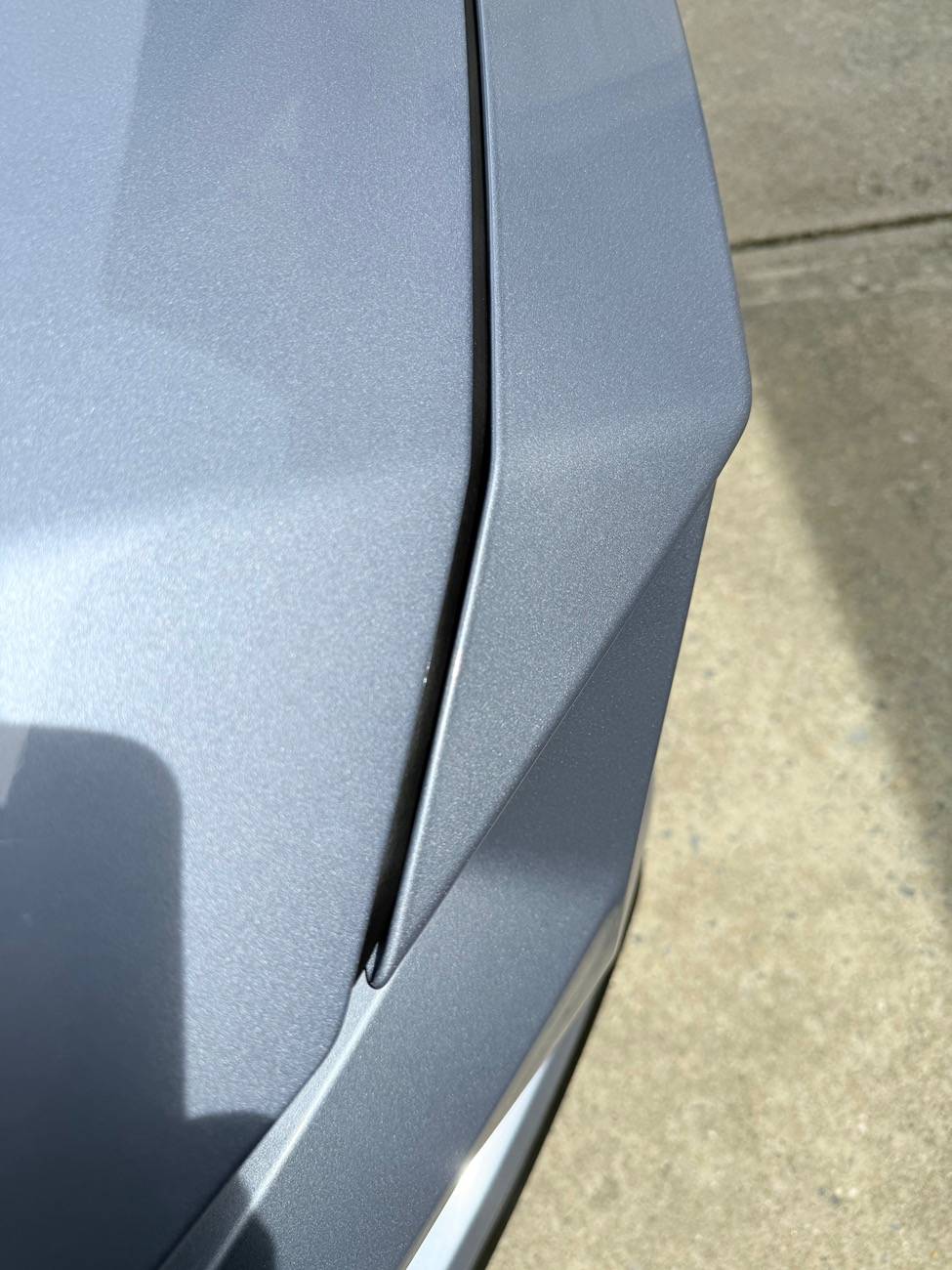

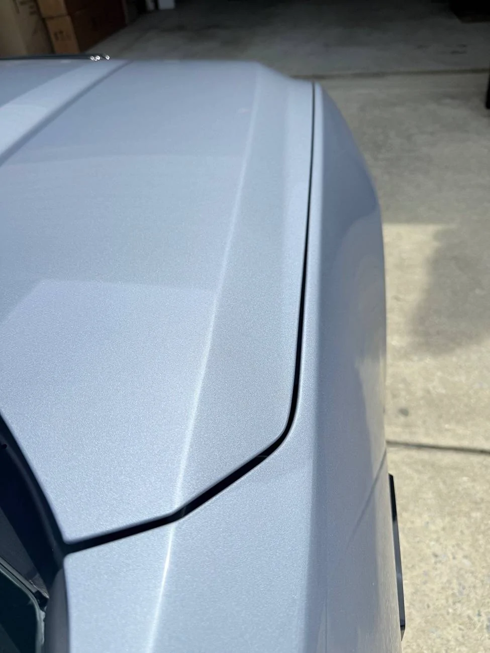

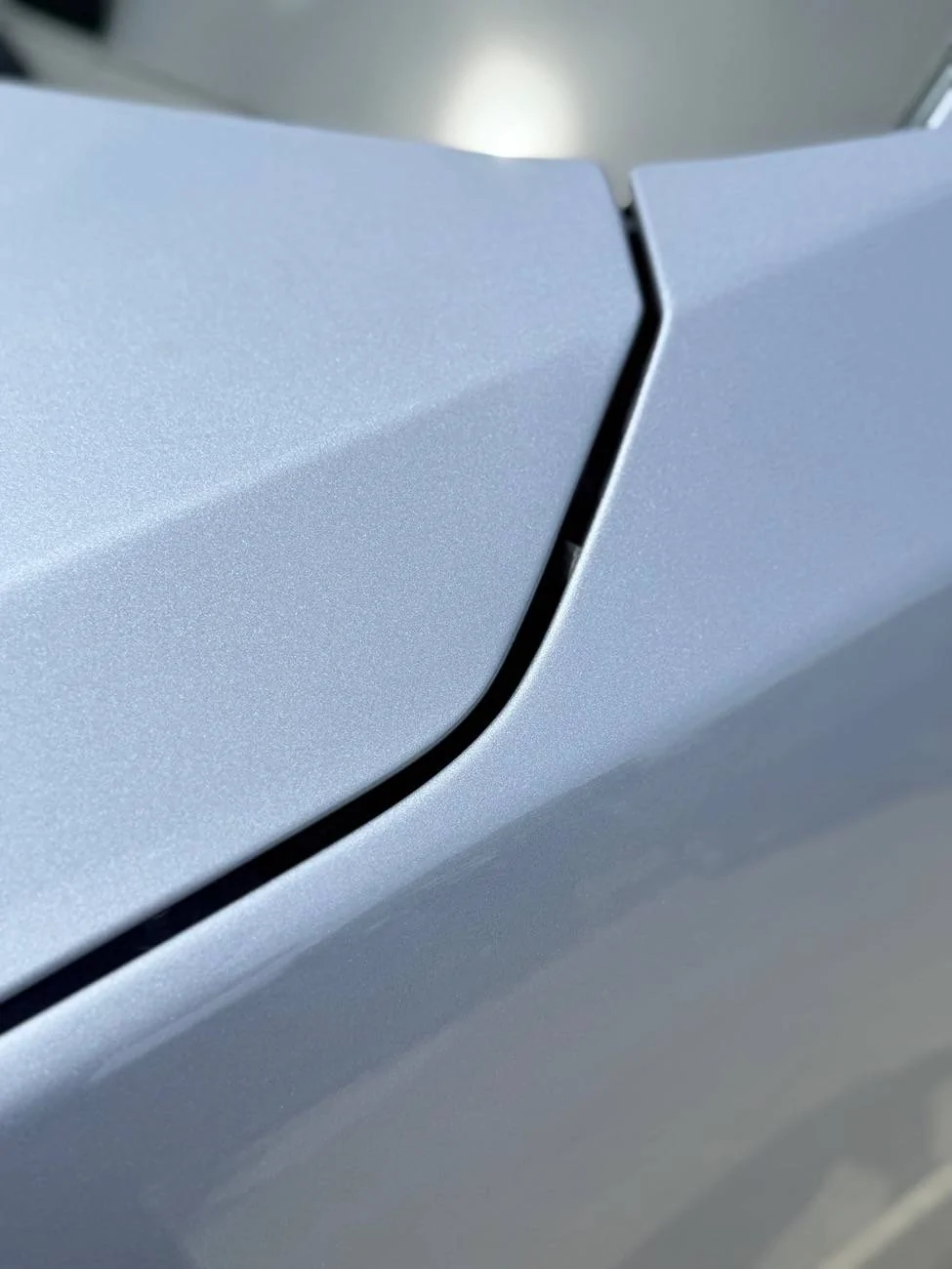

The gap widens approaching the windshield (the close up is the driver side and the larger view is the passenger side). The third pic is the front by the bumper.
Let me know what u think.

dusman59
Mar 8, 2023
890
911
AZ
2011 GT glass top & 2024 GT
That can be adjusted. It needs to be towards the windshield.

From the factory I noticed my hood shaking at interstate speeds, which is about 75mph. I adjusted the hood stops, and now there is very little hood movement. Fastest I've had my car is 146mph, and no concerns with the hood now.

Looks like a couple of adjustments need to be made. The drivers side windshield corner doesn't line up.
I’m taking her to a restoration body shop in a couple of weeks. I’ll ask them to adjust it.
Bringing it to my dealer is an effort and I’m not confident in their work. They are not performance oriented and aren’t focused on what passionate Mustang owners are looking for IMO. They should have separate Ford Performance shops for interested Mustang owners.
Jekyll_Hyde,
I am quite sure your gap needs adjusting. I wouldn't spend money, since you are still under warranty. Make sure you take many pictures from many angles before you take your car in. You definitely want proof of what it looks like before they get involved! Glenn
You can adjust it yourself. It's not overly difficult.
