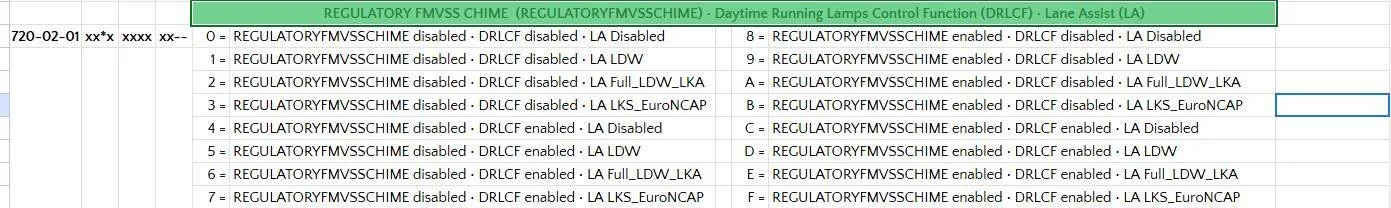

I know 100% sure that this is somehwere in Forscan to disable it permanently. There is a German company who knows how to disable it through Forscan, bur they don't want to share their knowledge without paying them.
I've read it on the German Mustang forum.
Auto-Hentzschel GmbH: Amerikaanse autospecialist sinds 1995
This company said that they can turn it off through forscan. If they can find it, we should find it as well in the spreadsheet.

According to the spreadsheet there is a option for Lane Assist. For mine it is set to 8 which means "LA_LKA_EuroNcap". But this will most likely lead to disabling the Lane Assist completly (at least on the Mustang Mach E this happens with similar settings): https://www.macheforum.com/site/thr...ument-cluster-display-requires-forscan.39240/
As I never did any "coding" before I will might give it a try, after I understood working with Forscan a bit better. If somebodys already more intermediate, please try it and give feedback here :)

But what if you disable only the "CHIME" and/or you use another LA, like "LA LDW" or "LA Full..."?
LDW: Lane Departure Warning
LKA: Lane Keep Assist
LKS: Lane Keep System/Support (same as LKA?)
PS: yours is set to "B" you mean... not "8".

Correct, it's B not 8. As I have no experience working with Forscan and I dont wan't to break my car I will not try it for now. Need first to gather some knowledege in general.

Eheh.. what do you think we're doing every time we start the car? :)
It doesn't disable the "alert", it disables the whole lane assistant! :blush:

Yes but didn't some say that the alert still pops up anyways? I'll have to try it 😇
