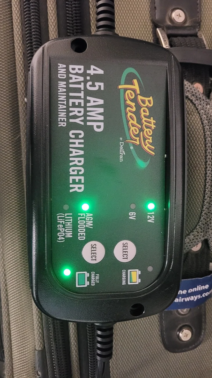

No idea what the charge rate is. But I'm only 2 hours in and its charged. Solid green light.
The charger has modes for AGM and lithium.
Lol, 4.5 amp...

Ryan: Wow…4.5 amp! Mine is 1.25 Amps. You condensed 8 hours of charging down to two…lol. I didn’t even know Deltran made a 4.5! Oh well, that’s a time saver.

I went down the research rabbit hole when I saw Ryan‘s 4.5 amp charger/Tender. Research showed my 1.25 amp was more of a maintainer, and a 3-5 amp is much more recommended for auto use. seems Ryan has a better maintainer than I do…lol.

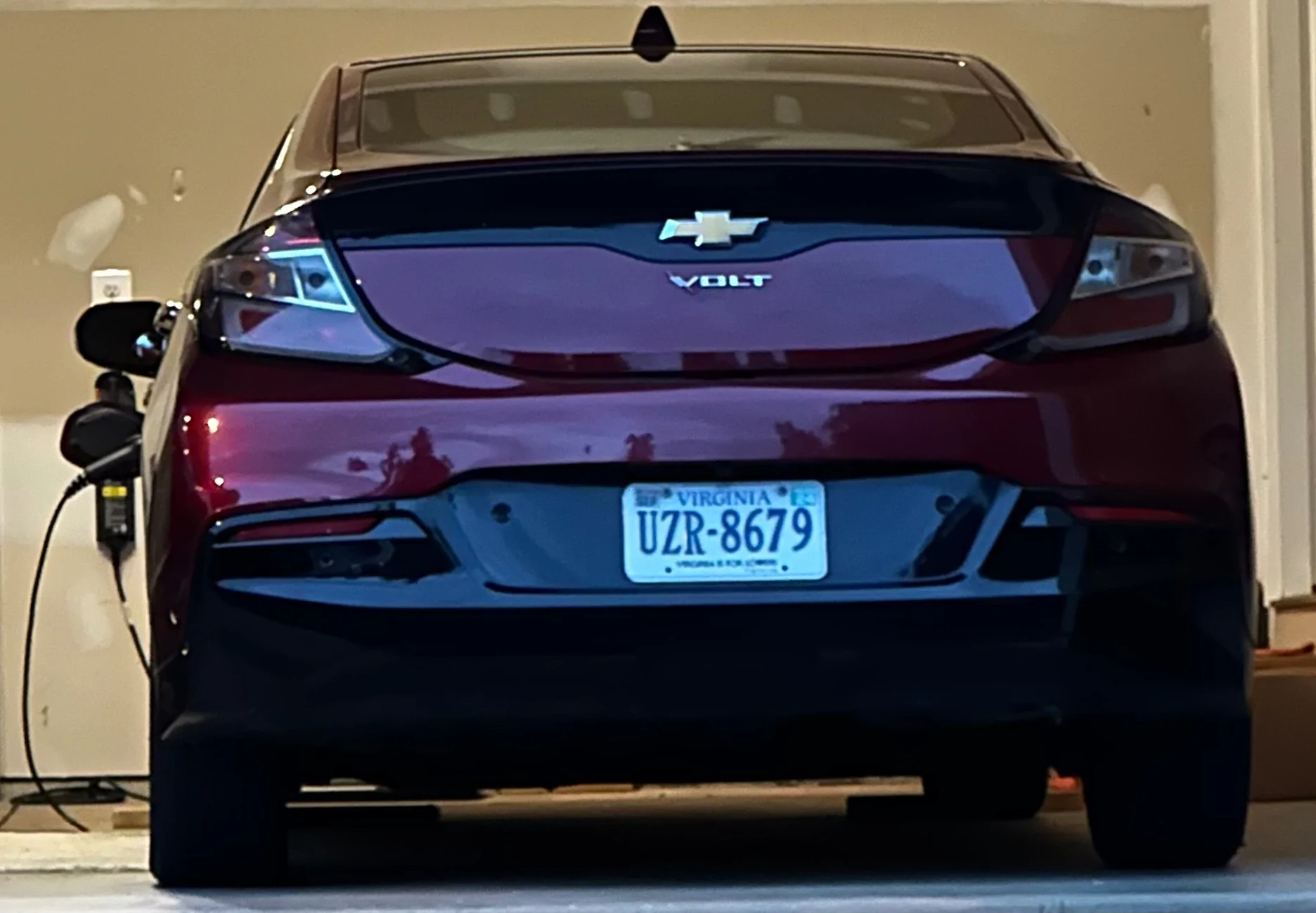

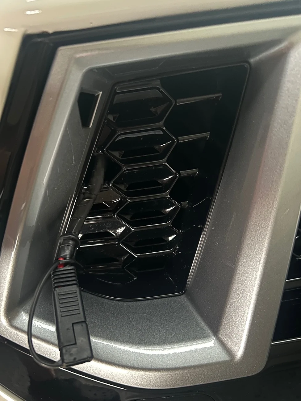

If using the Deltran Battery Tender, with the state of your battery, the first few times expect a full red charge light for a solid 14-20 hours! Then it will go into flashing green final charge for about 3-4 hours, then solid green. After you do it a few times, expect a full red light charge for only 6-10 hours, easily a good overnight charge if using daily.
Note the charging times and as you see progressively shorter charging periods, you know you are seeing a healthier battery.
Now for me I’m topped off in 4-8hours…..
When I first put the trickle charger on my wife’s brand new Lincoln, it was full red-light charge for like 48 hours the first few times! Now it tops off in about 6 hours.
I also highly recommend making a reminder card and put it on the driver seat. I did after absent mindedly starting my last Mustang and backing out of the garage only to see in horror it was still connected. 😬
