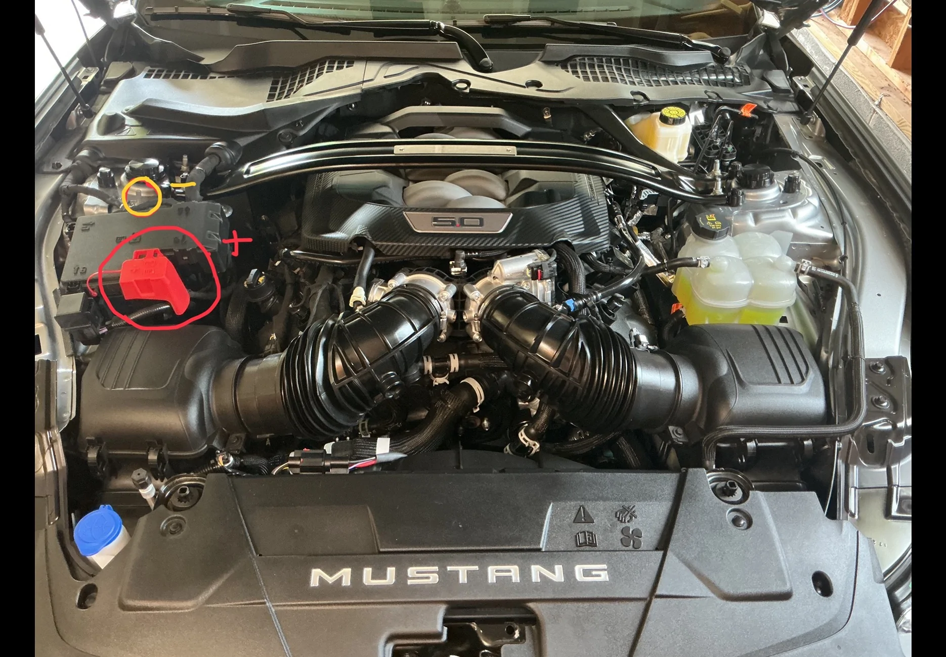

I broke out my battery tender that I use on my classic. Is it safe to use on this car without removing the battery?

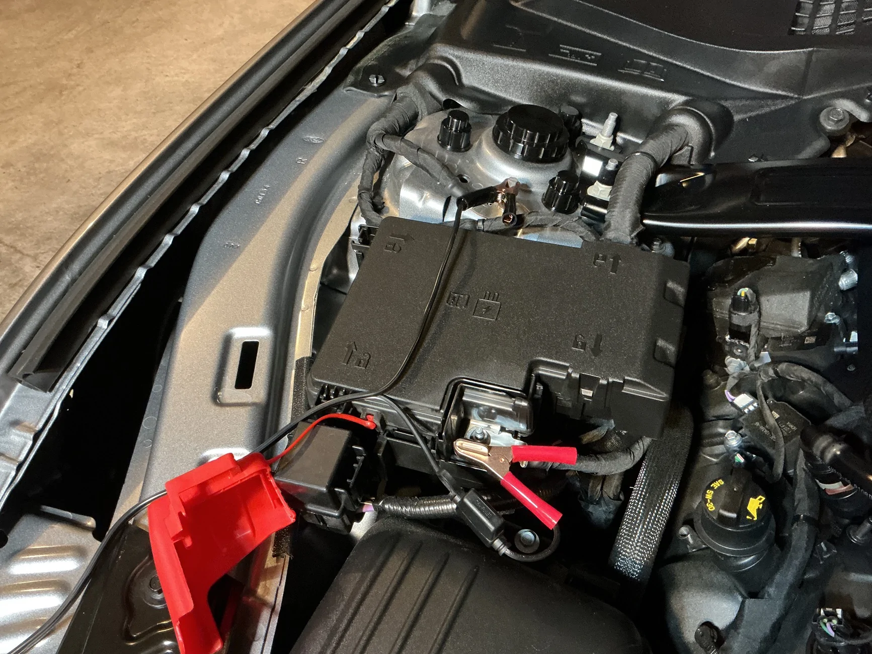

Absolutely! Just remove the red protective plastic cover and attach the pos. To the flat blade underneath, and slightly back and to the left is a ground post sticking up. I just attached mine…took 4 seconds. I put a folded towel over the hood latch receiver and just set the hood on top so it doesn’t close all the way and possibly pinch the cord.
Look, I agree…. in a perfect world we shouldn’t have to do this. But we do. And your Arizona heat is really hard on a battery on top of everything else. I can virtually guarantee if you put your battery on the Tender regularly, even one night a week, you will have a healthier battery and even have retrained a weak one.
Good luck! :fingerscrossed:
Thanks for the help. I was all set to connect it to the main battery terminals like a moron.

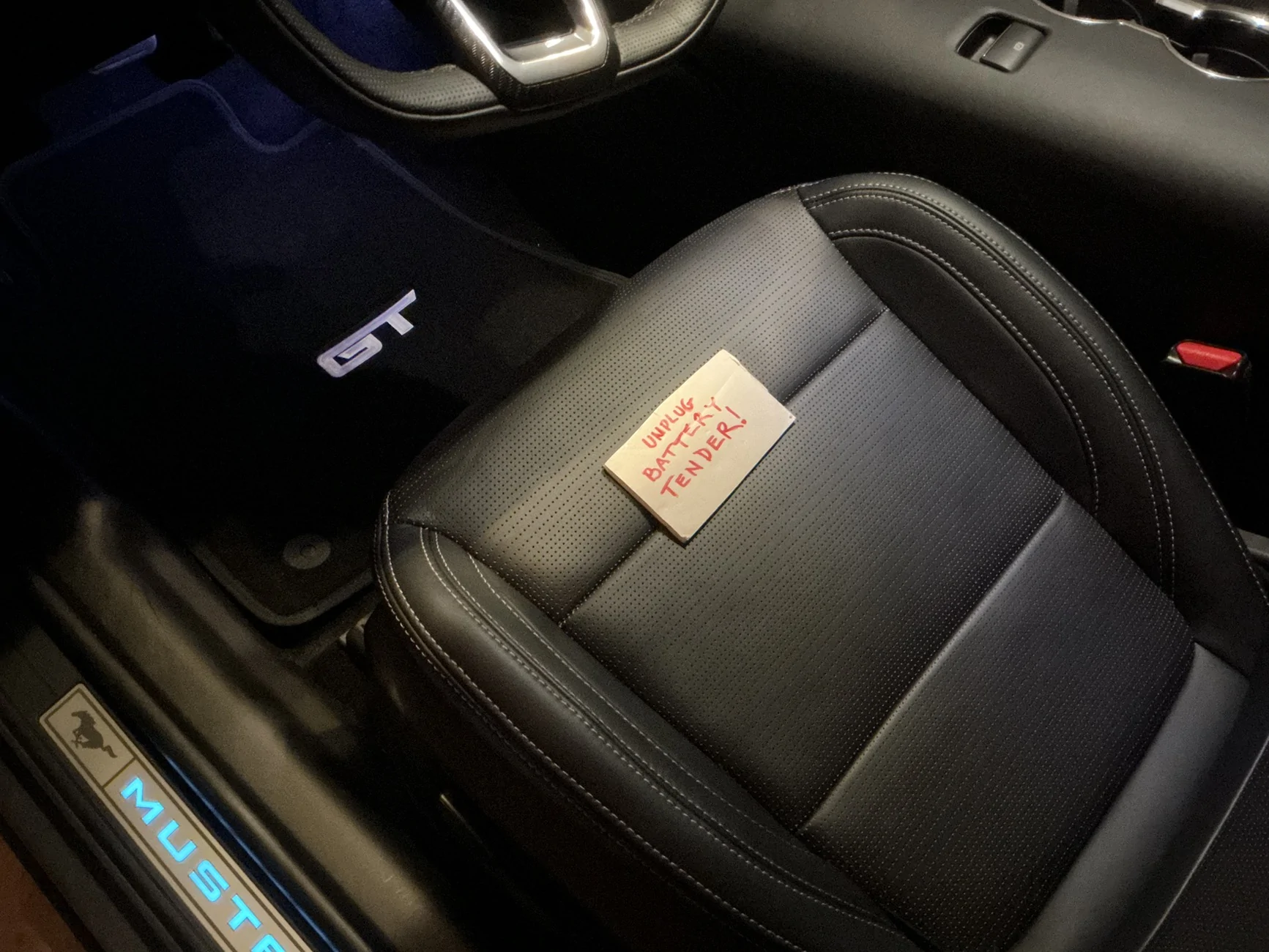

I also highly recommend making a reminder card and put it on the driver seat. I did after absent mindedly starting my last Mustang and backing out of the garage only to see in horror it was still connected. 😬

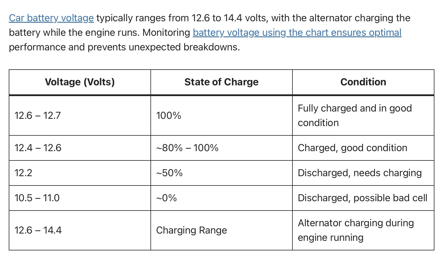

Well I know from wrenching that a fully charged battery should be 12.6v or more. When running you should be above 13.5v.
I googled 12.3v, and it says that is about a 70% charge. 🤷‍♂️

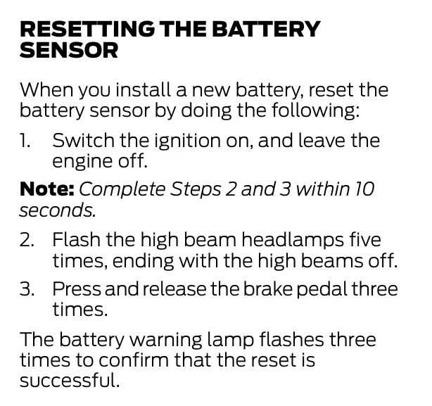

Maybe after getting a full charge on the battery perform a BMS reset. This might only be needed if the battery was very low or a weak battery needing replacement.

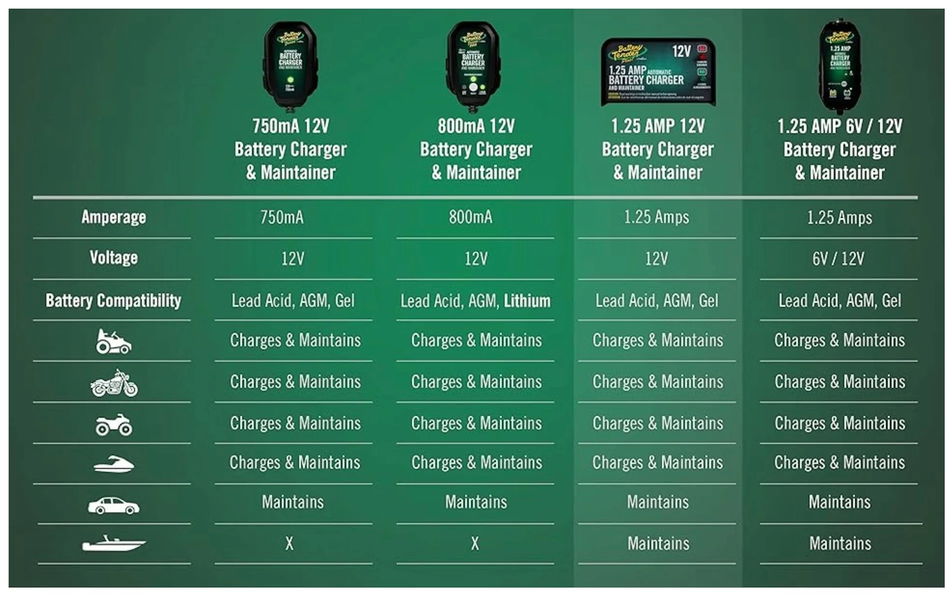

Make sure tender is for AGM
The Deltran battery Tender is OK for AGM. As long as the charge rate is 1.25 amp But newer charts also show the 800 and 750 mah working for AGM.…so go figure…lol. Though there has been some worry about anything lower than a 1.25 amp charge being too low for the AGM to recognize properly.
But you brought up a good point to look out for in inferior chargers. Ryan’s instruction sheet mentions an AGM, so it must account for it.
Ryan, what’s your Tender’s charge rate?
