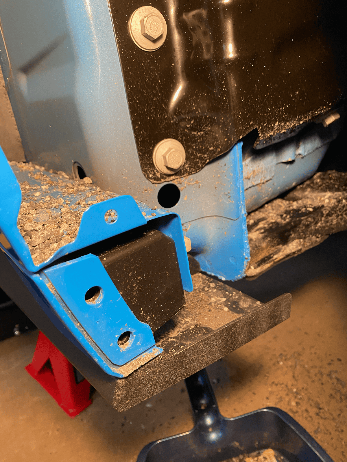

if you are driving on clean roads and no gravel drives or roads then there shouldn’t be much In there, but I can tell you what ever rail yards our car went through in transport were gravel because ours was full of stones and they were not from our driveway. This picture was taken an hour after the car came directly from the dealer. It was the same amount on both sides

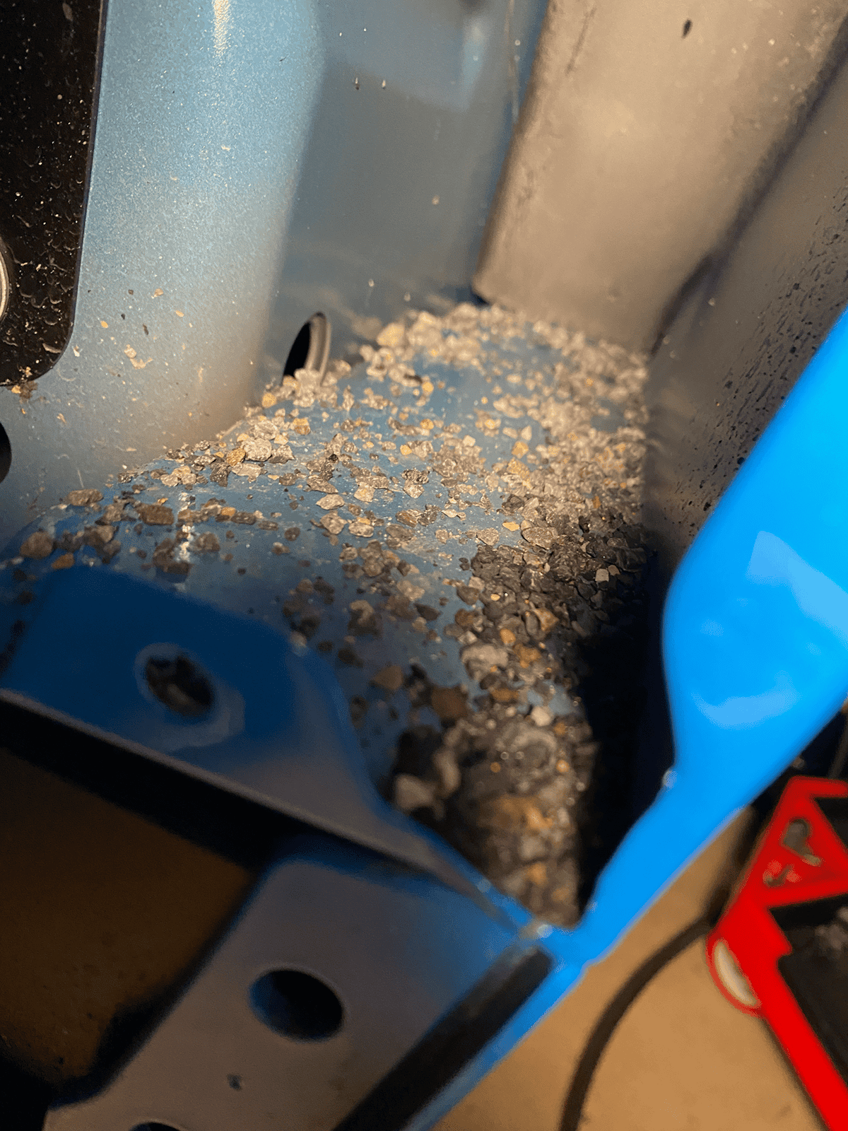

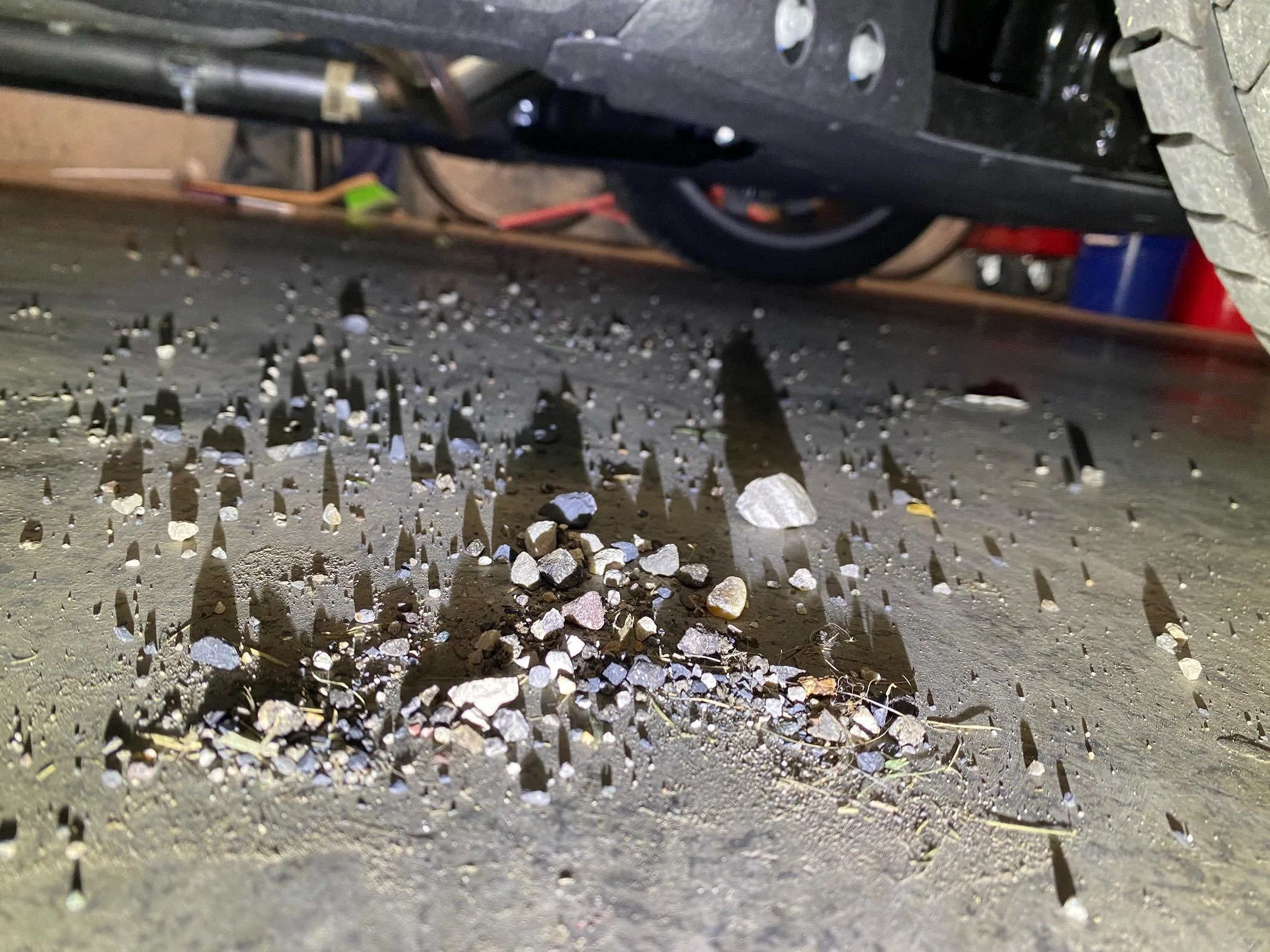

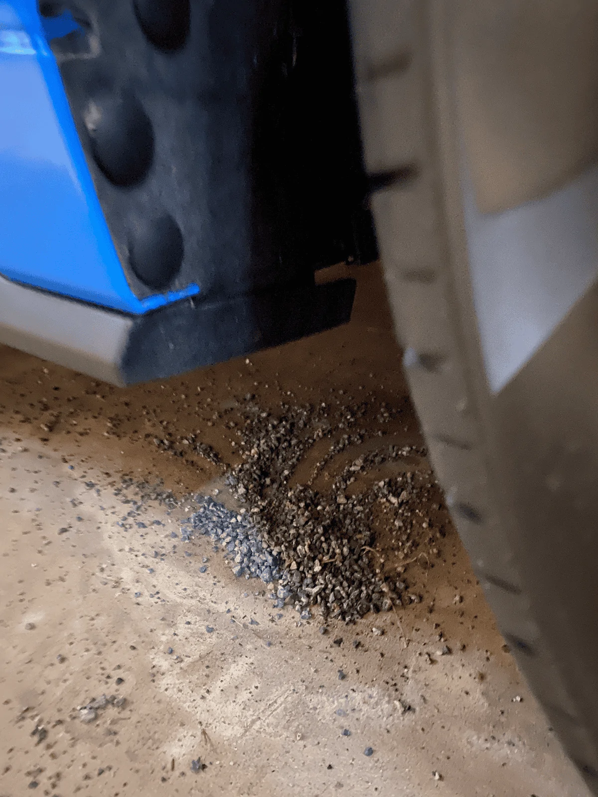

I had a 20 mile trip home from the dealer after my car was delivered at the end of January. Now, they did cinder the roads earlier that day but there was no snow or icing on the trip home. Below is what I had to clean out from behind my wheel wells. At this time the car only had 42 total miles on the car.

This is what dropped out as I tapped the side plastic skirt.
S650 Mustang Front inner wheel well issues IMG_1964
Driver side inside fender.
S650 Mustang Front inner wheel well issues IMG_1990
Passenger side inside fender.
S650 Mustang Front inner wheel well issues IMG_1979

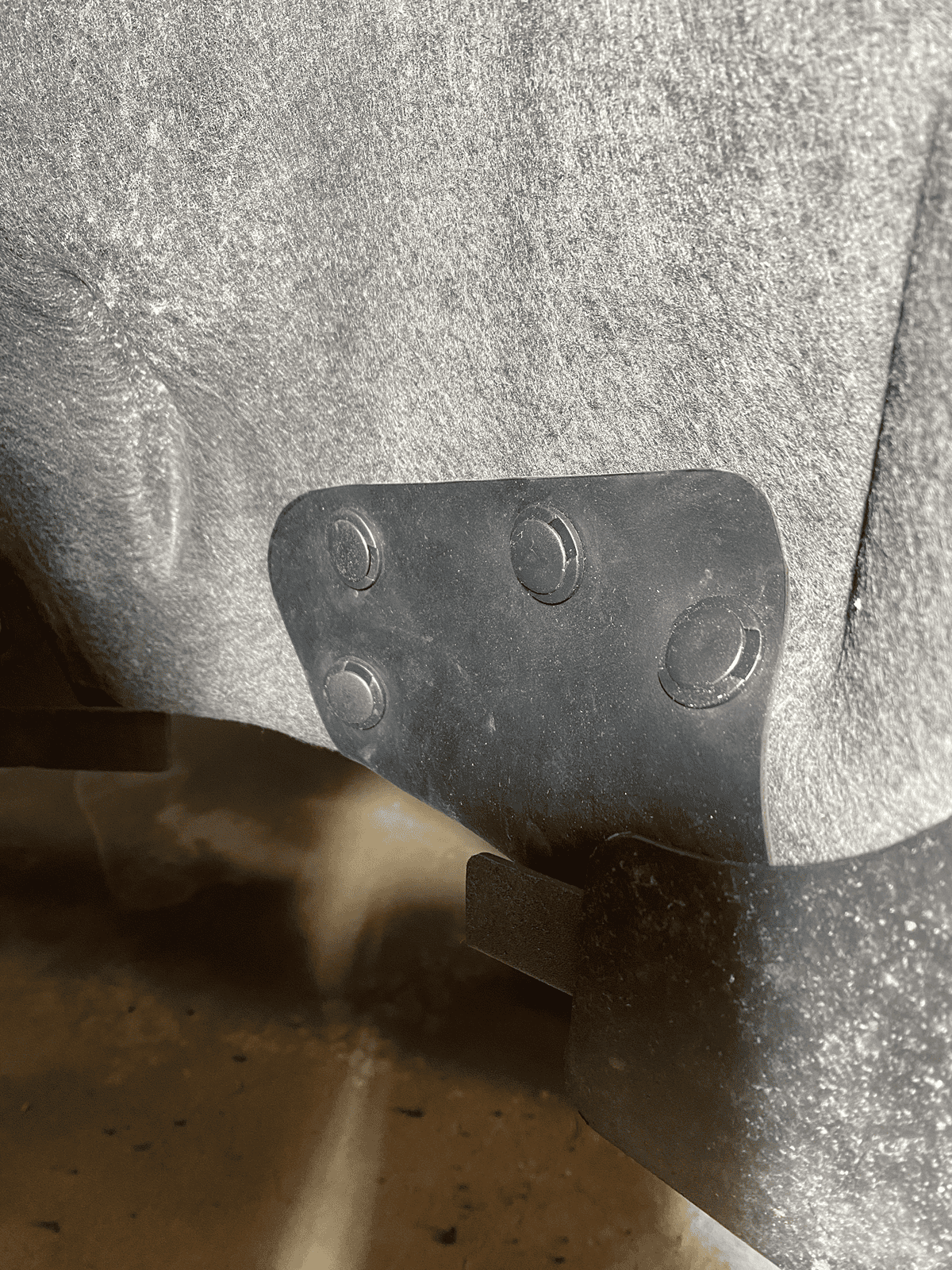

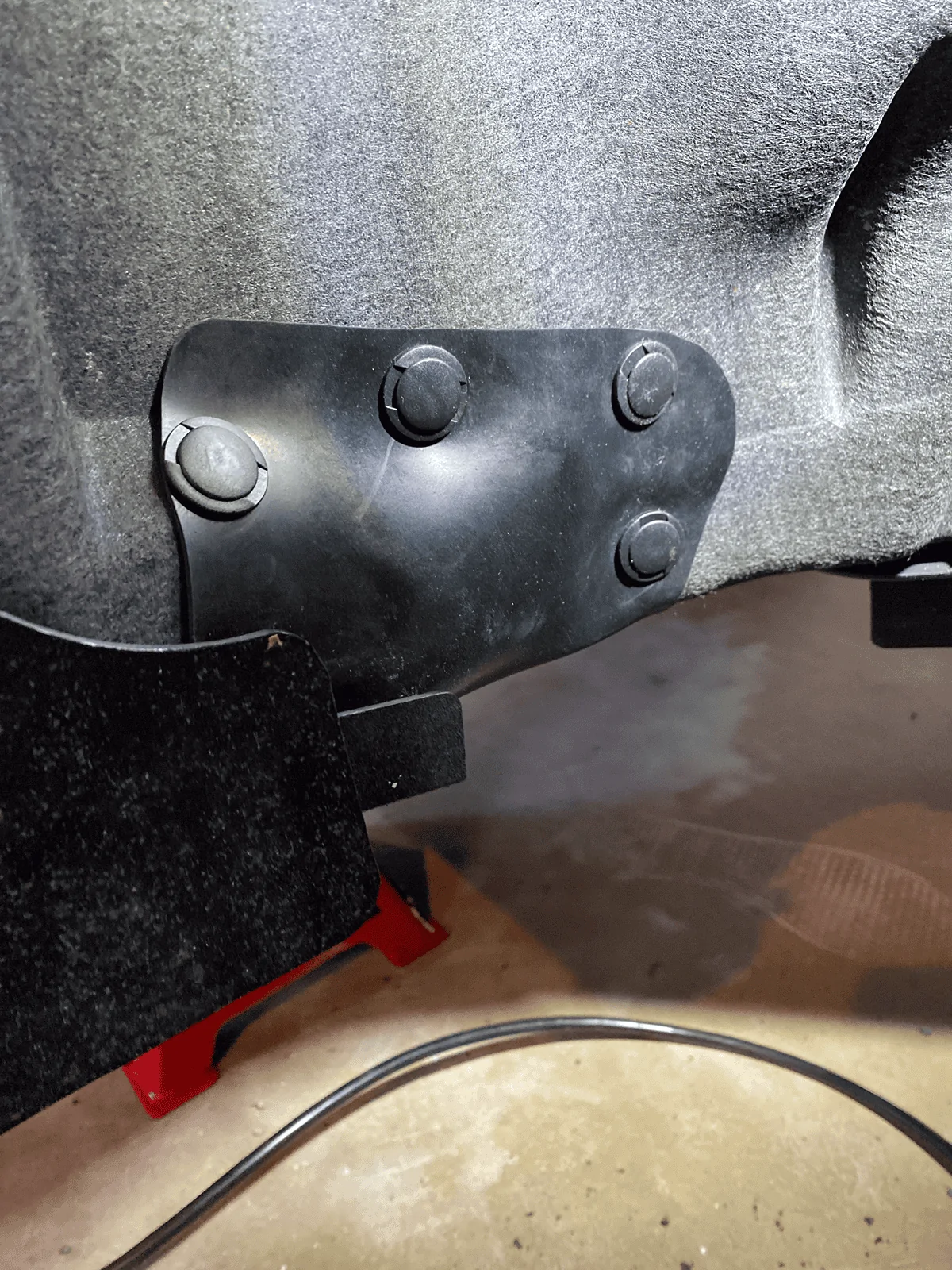

My fix driver side.
S650 Mustang Front inner wheel well issues IMG_2041
My fix passenger side.
S650 Mustang Front inner wheel well issues IMG_2046
