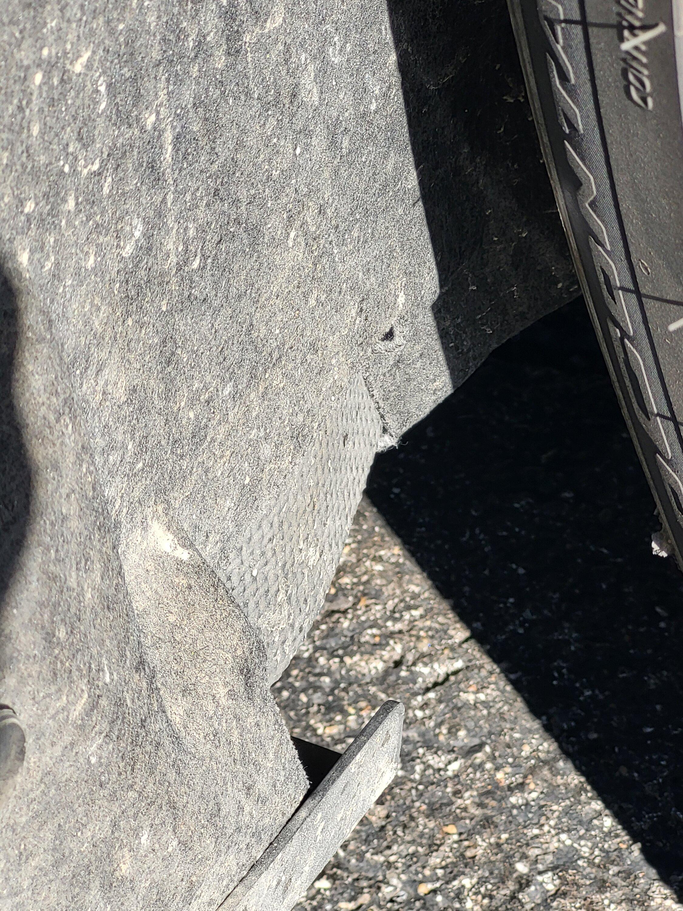

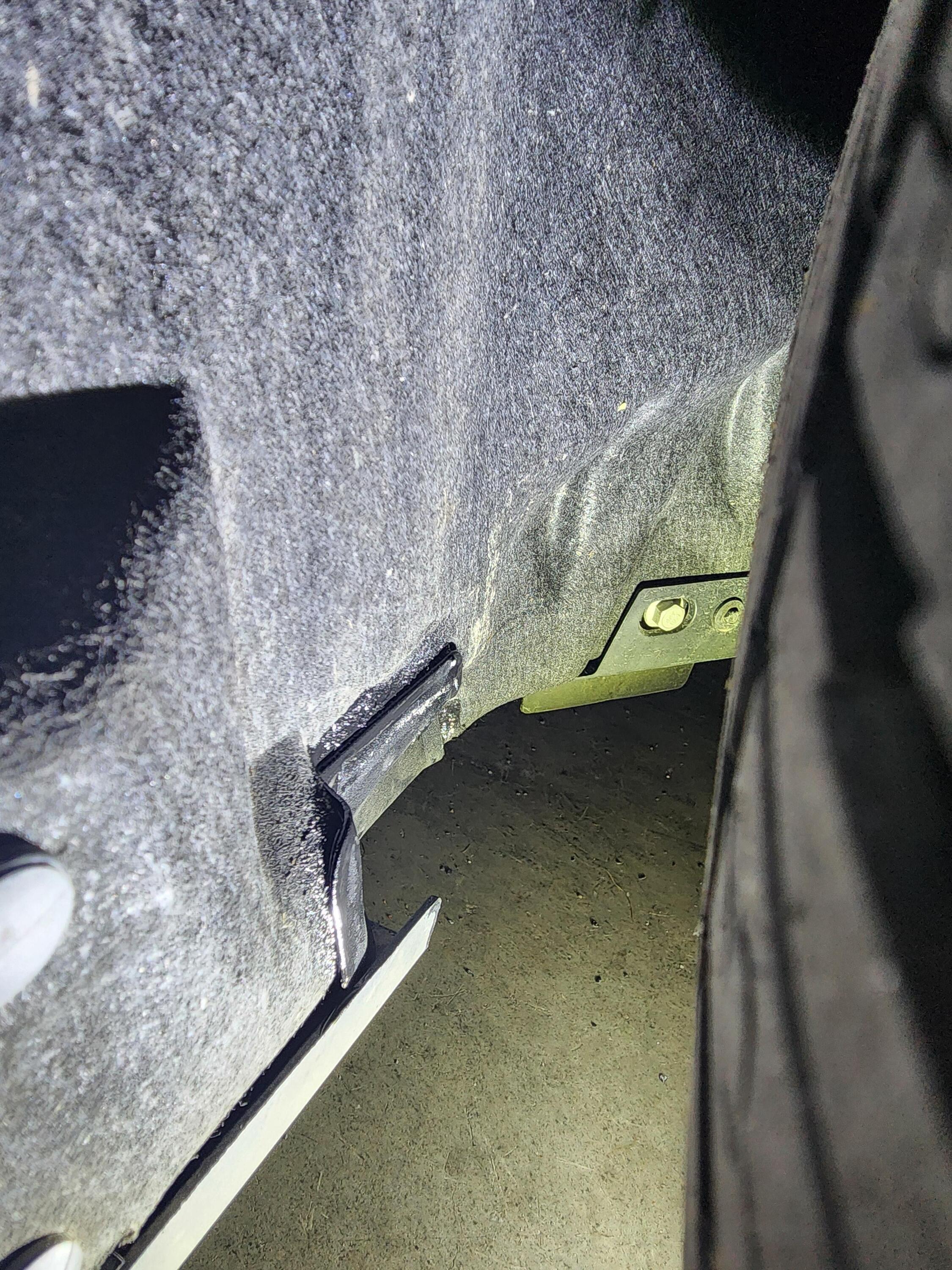

All, I have posted this in some other threads regarding the 2024 mustang front inner wheel well openings. For those of you who are not aware, there is an opening directly behind each front wheel where stones, dirt, sand get tossed into. Once it goes in, there is no way for it to get out unless you clean it out. The stones will work their way between the outer plastic rocker molding and the pinch weld where they etch their way through the paint. The opening also exposes the K member as well as the body sheet metal. So as you drive your car, you are damaging a place that under these circumstances becomes VERY vulnerable to rust and corrosion. I have never seen such a poorly designed inner fender well? Ford as well as the dealers need to hear about this so hopefully they can get a new design for this half of the wheel well.
Here is a video put up on youtube. If you have seen it great, but if you have not and are not aware of this, please watch this or go look at your wheel well, you will see what I'm talking about. It is much easier to see on a lift, but I discovered this the first night just laying down looking under the car.
Either this winter or this spring I plan on making something to cover this. I'm curious to hear others' thoughts on this.
Thank you

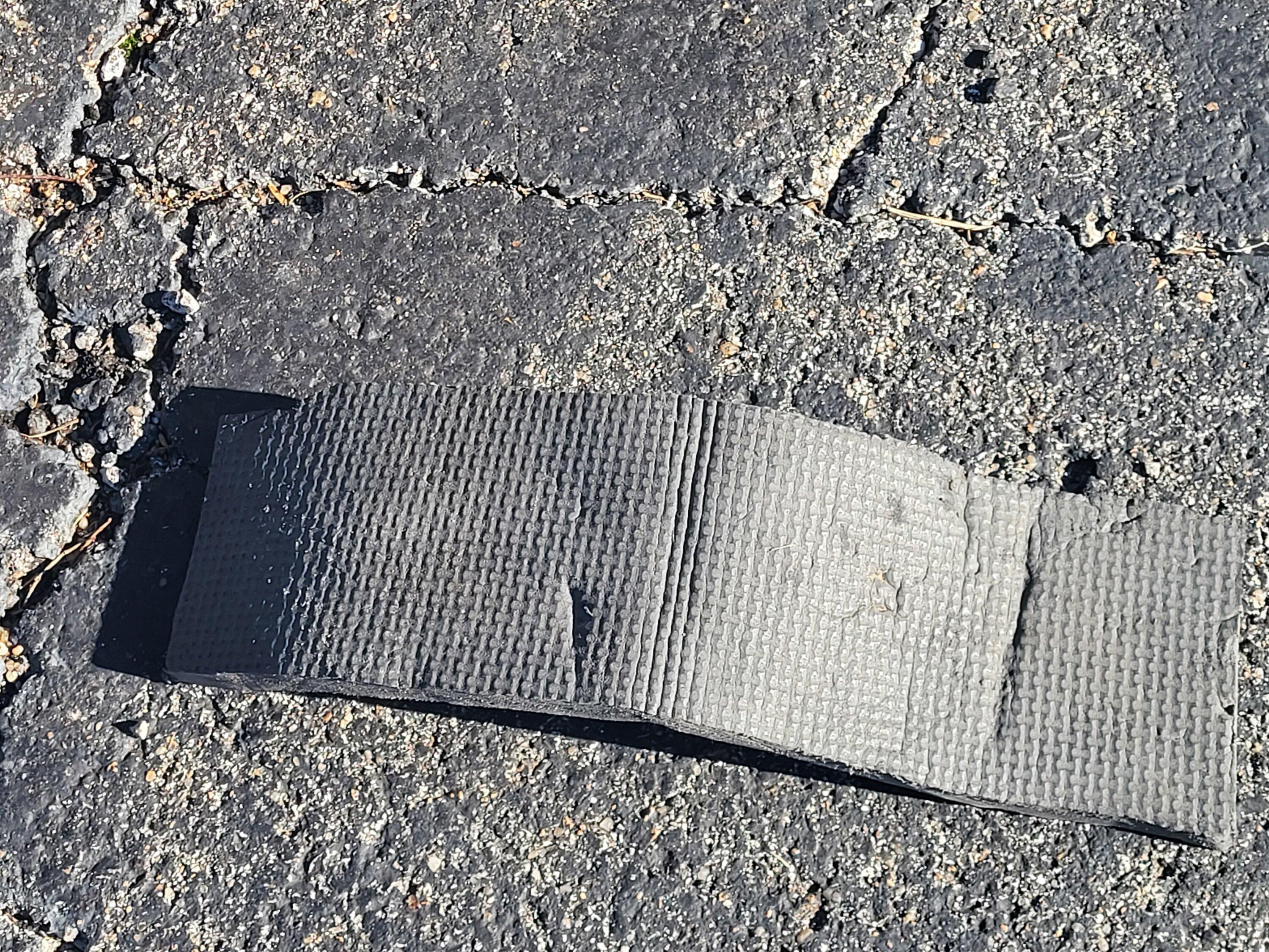

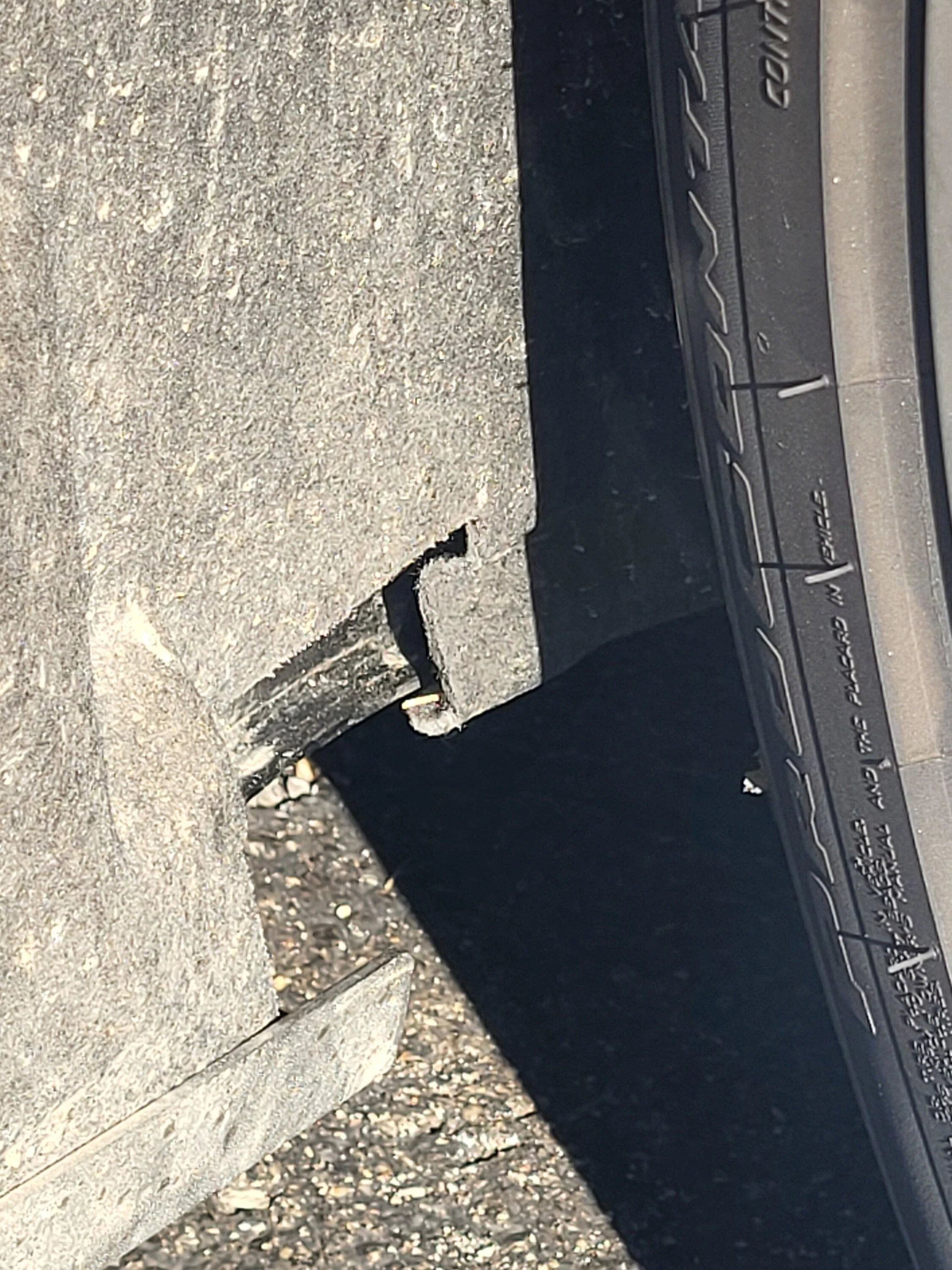

I looked at mine and the holes are there, found a few small pieces of gravel, asphalt etc. Terrible oversight by engineers who decided to leave the opening!!! I "fixed" this with an old foam garden knee pad I had lying around. Simply cut a rectangle about 4 x 8 inches and slid about Âľ of it into the opening towards the center, then pulled it towards the fender until it's centered in the opening. Frame held it in place, albeit loosely, hasn't moved or came out at after driving 70+ mph! Bonus is the gray color blends quite well with the rest of the well cover!
UPDATE: instead of cutting foam 8", I cut it about 15" and folded it half for a much tighter fit. Attached pics
Foam will hold water in there worse than leaving a hole!
GTSteve
Jan 19, 2024
Tulsa
Not if it's closed cell such as the foam is made of, besides it issue is debris not water. Also the foam is in front of frame not inside the frame.
