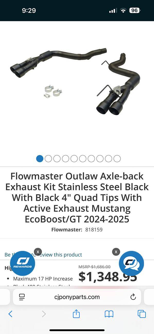

First time owner and looking for a deep tone exhaust
yimmy_s650
May 20, 2025
san antonio
mustang gt 2025
So my car doesnt have active exhaust system on it but i was looking into buying this flowmaster and it said it have active exhaust on it but i dont see any remote control for the active exhaust in here , so my question is if this doesnt come with the remote control for the car , can i still put it on my base gt without active exhaust option or i have to go with the one that said without active exhaust? Thanks!
There’s a reason these are named Outlaws, they are loud. I had them on one of my 18 GT’s. They sound good and not raspy, but the drone inside was horrible. They do not sound like Flowmasters on a Fox body, I haven’t seen or heard any exhaust on these Coyotes that sound that good and deep.
