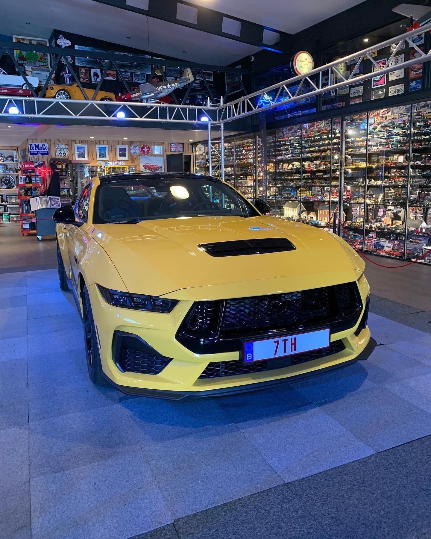

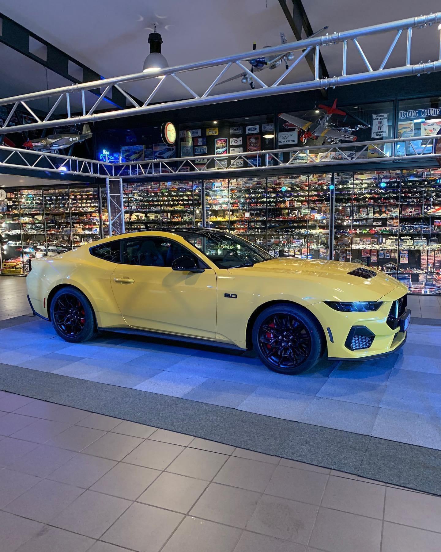

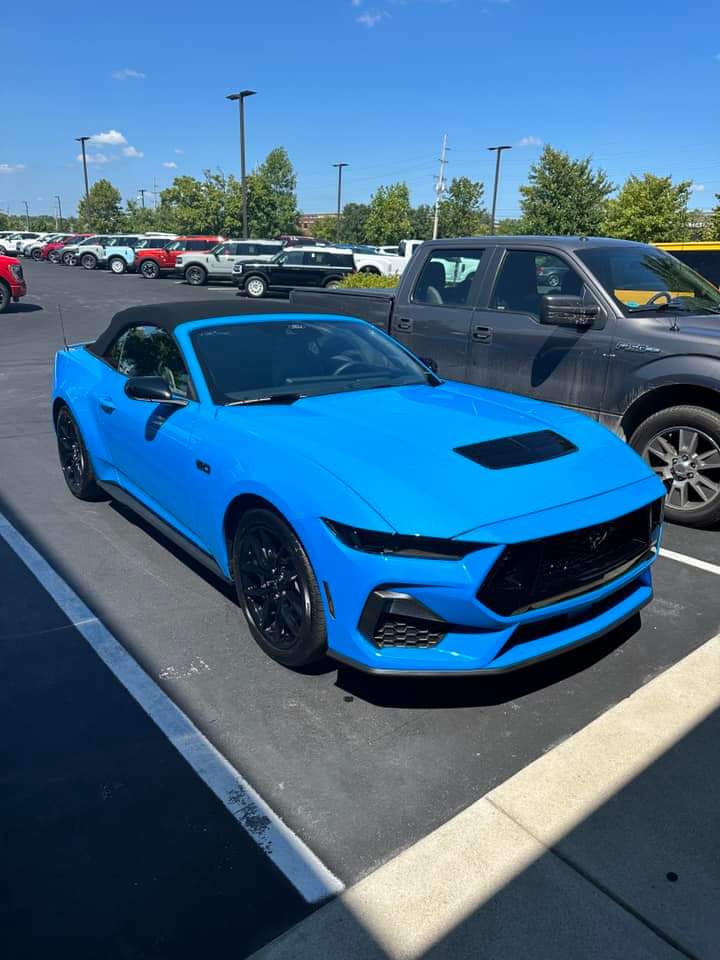

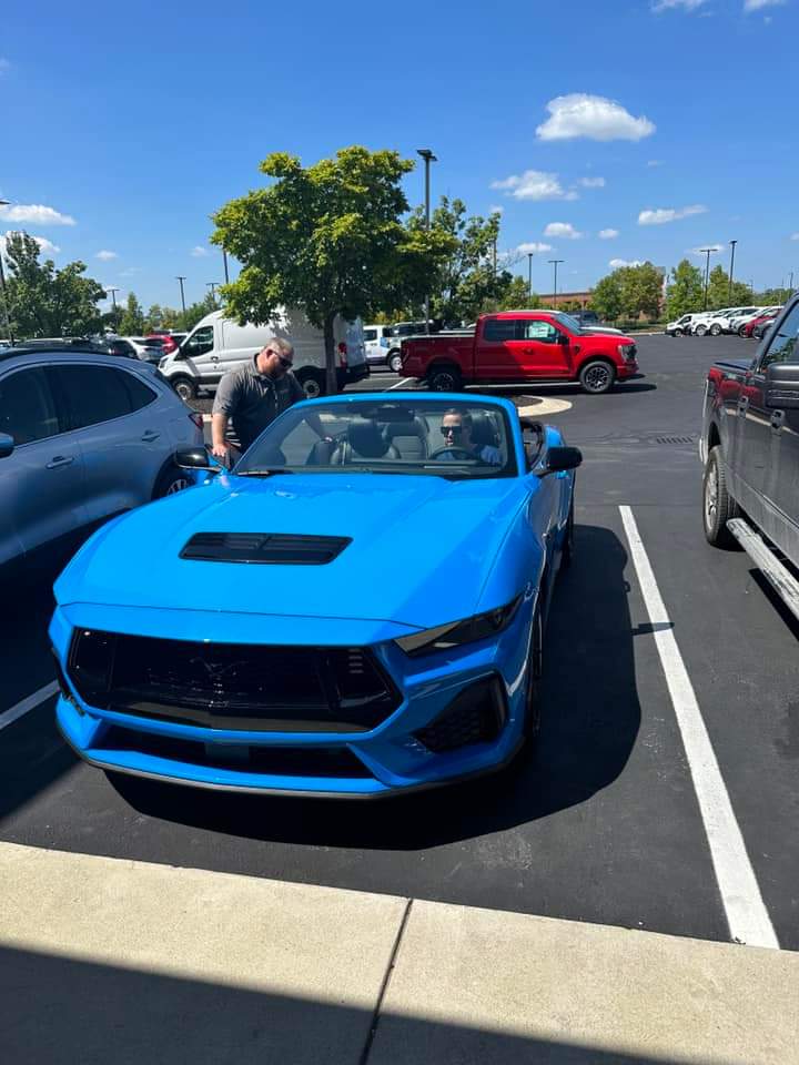

There is a color difference on some panels on the new S650.
You can notice this flaw very well when comparing the color of front bumper with the hood.
The first time noticing this was a few months ago, when the European Yellow Splash was presented in Belgium and later on was sent to Germany as a show model.
The Belgium Mustang collector said that the reason of color difference is that the front bumper is made out of a different plastic, and the hood is made out of metal. That makes the same color look differently when painting it on different material.
He also stated that Ford will fix this issue for production cars.
Well, unfortunately it is not fixed and people with especially bright colors like Grabber Blue and Yellow Splash will notice this the most.
At first, I thought it could be the lights/shade/sun etc. make this look like a color difference on the picture, but after seeing more vehicles like that, it is not an optical illusion.
I was thinking of going with Race Red, but after this I think Vapor Blue is the more safe color.

That's why Ford did not fix it and allowed this "small" flaw. Because not everybody sees the difference.
As someone who ran a paint company it also can be caused by different paint batches. All the parts should have a primer that the paint adheres to so the underlying material would have little to do with mismatched color beyond a mixing of batches or poor quality from the application (not equal layers)

Unfortunately, there isn't anything they can do for it, I work at a Honda assembly plant where the Civic Hatch and CRV are made, in the Paint/Plastics Department. The reason I say this is because we have the same exact "issue" on our cars, especially the White and Dark Grey. The paint for the bumpers is a water-based paint whereas the body paint is a solvent-based paint. Thats where the discrepancy lies. It's kind of an industry standard for painting plastic with water based and using a completely different type of clear coat on plastic as well. If they were to use the same for both, they'd have bonding issues.
I can see it on the yellow car, but that's a negative on the grabber blue
If the grabber blue was inside at a mid-light level, it would be really easy to see it.

I saw the yellow GT in Belgium as well in real life and I can confirm that the color difference between the hood and the front bumper was massive. At the time I thought is was just due to it being a prototype that had perhaps been through a manual partial respray.
My guess would be that it has to do with the fact that Yellow Splash is a metallic. Metallics are much harder to match between different materials than solids. I have owned two different 2016's in Triple Yellow which is a solid paint and their match between painted plastics and metals was excellent.
