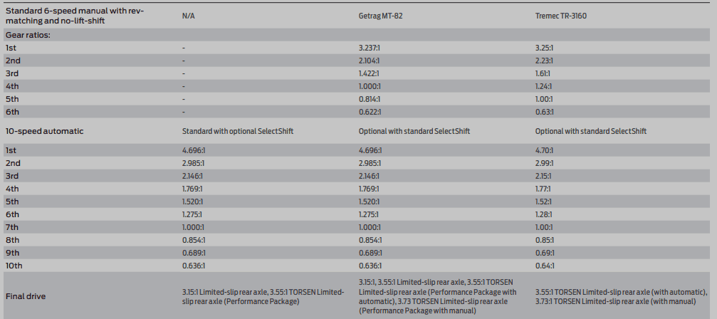

I recently read a post where he discussed the fact that Ford changed the gearing in the MT sometime after 2015 when my current car was built and now 1:1 is in 4th instead of 3rd gear.
Can anyone speak to this? What changes should I expect in drivability because of this?
I have 5:55s in my 2015 GT Vert now and I can start in 2nd gear if the road is flat. Just not very up on gearing and differences caused by the change.
Any info would be fantastic!

Thanks Grey One! That confirms the 1:1 at 4th on the new car.
Now I just need to find the similar chart for the 2015 S550 and maybe someone can comment on what the difference in driving experience is because of the changes.

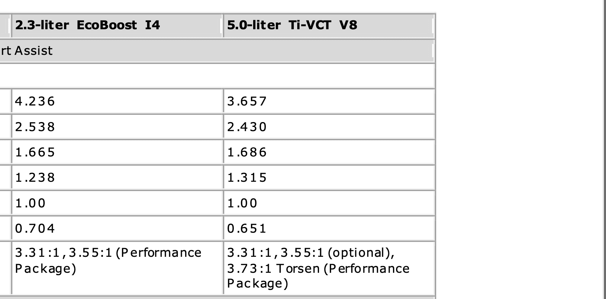

Thanks Dena, looks like that info is still for the newer S550s. They changed sometime after 2015, not sure when. The newer S550s have the same gears at the S650 does.

So it looks like the 2015s actually went 1:1 in 5th, not 4th like the new ones. I just don't know how that affects shift points, not so good with math.
S650 Mustang Difference between early S550 MT6 vs S650 MT6 gearing Screenshot 2023-12-27 at 3.54.17 PM

It really doesn't affect the shift points very much. The big difference was when ford got away from the 4 speed with third as the 1:1 gear. The original 302 had low end grunt were the the 5L needs RPMs to show it's stuff. To compare, what you probably want is
Old RPM/Old speed=New RPM/New speed OR
Old Speed/Old RPM=New Speed/New RPM
Algebra would allow you for example to rewrite the second formula as
(Old Speed*New RPM)/Old RPM=New Speed
This is assuming that you are using the same rear end. It's not difficult adding the rear end in but I am trying to keep it simple for now. No I am not exactly a math wiz but I had some Calculus and after that, brain rot sets in.
