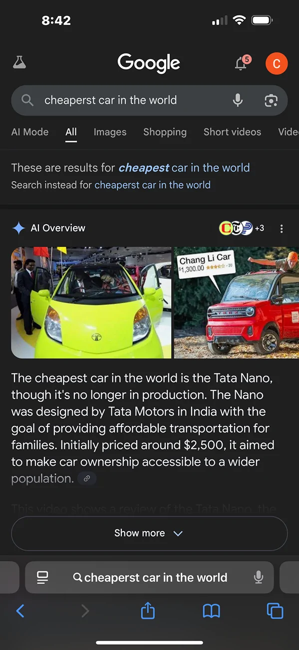

The EPA is there FOR US automakers, they have to have ridiculous strict guidelines to meet or other countries would be able to undercut them with lower cost vehicles…
Everyone would be driving brand new $2k tata nanos
S650 Mustang Carbon Filter RWHP? IMG_3633

But purchase $1k phones? Odd how quality quantifies
