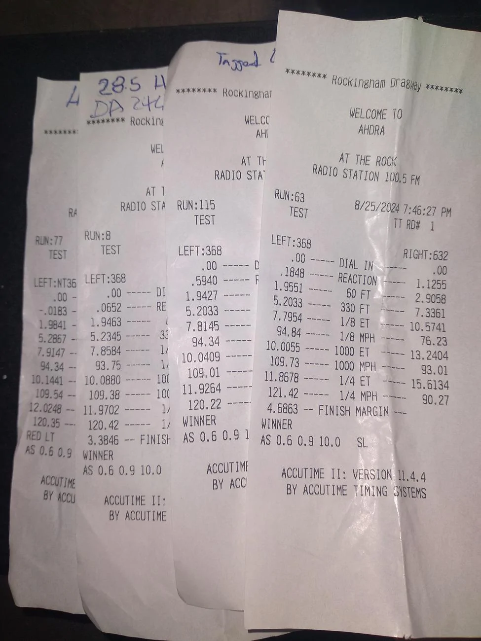

There are gains to be had from carbon trap removal and running the lids off, but no there's nowhere near 20hp, 5/6 perhaps.
Full weight, 1/2 tank of 93, and on a worn out and dry rotted M&H 275/45-18 DR mounted on a heavy 18x10 S197 wheel. I ran [email protected] in 2400-DA at Darlington.
I bought a pair of Nitto 275/40-18 DR's mounted on the same S197 wheel, That combo adds a 12lb weight penalty over the stock 18x8.5's, and oddly they are 3lbs heavier than those M&H DR's.
I ran at The Rock last night, new THINK air filters, carbon traps removed, the lids off, 1/2 tank of junk E50, full weight with spare tire/jack and another 35lbs of junk in the trunk. I weigh 195.
Upper 80's and DA was 2400 .. I made 4 passes and the car trapped 120+ every pass.
Best was 11.867 @121.4, I launched in D, let it auto shift to 2nd and manually shifted 3rd-6th. I should've left in 5th and ran it to the limiter instead of shifting to 6th. Probably lost a couple hundreds there. I'll try that next time out.
I got lucky the PCM hit the 1-2 and 2-3 shifts @ 7200 instead of short shifting to 3rd @6800 like it usually does ...
That 11.92 pass I tried manually shifting, I caught 1-2 shift@7100, but lightly tagged the limiter on the 2nd 3nd and 4th shifts. I was shocked it ran that.
If we ever get tuning available, these 24's are going to fly shifting them @8k.
S650 Mustang Carbon Filter RWHP? Rockingham_Aug25_90f_DA-2400ft

I’m not talking about gen 4 did you read my post lol Gen 4 is a wash Gen 3 is worth 8-10whp on the Mach 1 and GT but you’re not going to magically make it an 11 second car
I read your post, You said there was no gains to be had on the Gen-4, or it was a wash.
Track time show gains across the board my Gen4 and I doubt it's ever going to see the rollers.
That's why dyno testing is a waste of money unless you wanna see where the power drops to set shift points.
Next up, Negative DA in a Bottle.
