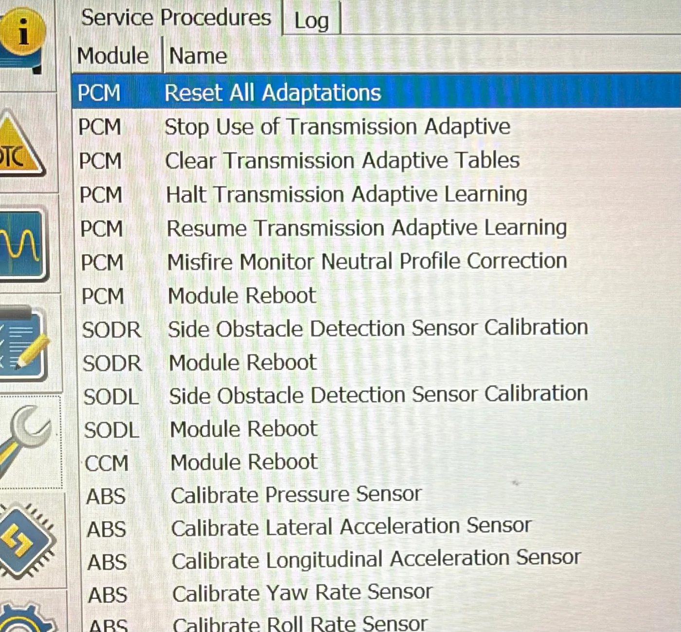

Yes you can reset the learning parameters with Forscan. I just leave the learning function disabled on mine, It shifts the same every time without that soft shift like drawn out effect that it did sometimes when the learning function is on. I like the way it drives with it off. But that's just me.The thing that annoys me most about the automatic gearbox is that when slowing down gently to between 20-35kmh (lots of speed bumps here) it drops down only to 3rd gear, when ideally you’d want to be pulling away in 2nd, so either you have to intervene with the paddles, or by jabbing or mashing the throttle. This happens in both Sport and Track modes.
If I regularly use the paddle to force it to choose 2nd gear will it “relearn” my habits and change its shifting pattern? Can the learnt behaviour be wiped using FORScan?
Did you first reset the adaptation and then remove the learning?Yes you can reset the learning parameters with Forscan. I just leave the learning function disabled on mine, It shifts the same every time without that soft shift like drawn out effect that it did sometimes when the learning function is on. I like the way it drives with it off. But that's just me.
Yes it is pretty simple to do. In Forscan there is a tab for the service functions, on there you will see i think it's called TCU or TCM relearn or something. Anyway yes its easy and you don't need to change any code or anything it's a service function so just click it and then it will say to wait 30 seconds then you cycle the ignition. Trust me its easy. You can disable it or there is i think 3 or 2 options that can be set. I set mine to disabled and it stays off. I too was thinking I dont want it learning because I drive hard sometimes and also just chill sometimes. And mine was doing what it supposed to do but when I wanted to get on it or drive harder it was not up to snuff.I think I'd like that too, especially as the first 2km I drove it lightly for bedding in period, and only approaching 6k now. Also some journeys I like to get on it and others just cruise, so I don't like the idea of the algorithm deciding how I want the car to respond.
AI suggests it's a simple toggle in the Service Functions tab, is it that straightforward? If not, do you have a guide that you followed to do it?
Yes i tried reset but ultimately i ended with it disabled. I didn't like the way it was learning if you will. I think it drives much more consistently when disabled. The tranny will shift with full pressure everytime.Did you first reset the adaptation and then remove the learning?
