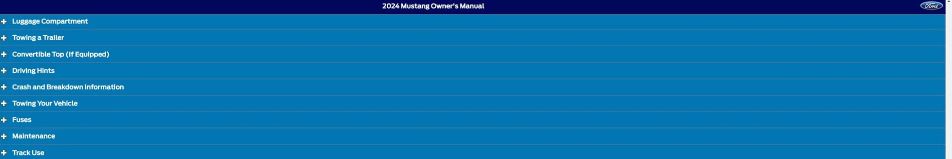

Read the Owner's Manual regarding initial driving and break-in. There are general guidelines and references you can be aware of and follow.

The 2022 manual lists the overall break-in of 1000 miles / 1600 km and offers advice and guidance. It also states oil consumption might not stabilize until 3000 mi / 4828 km.
