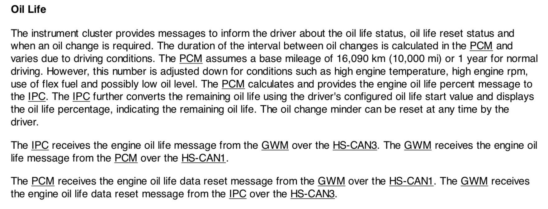

Some additional insight on the OLM.
As mentioned above, if you change the oil and park the car, it will count down to 0% at the end of one year, or 1.9% a week. At the other extreme, if you hit the track or drive the car hard, you'll notice the OLM countdown quicker.
The OLM looks at time, temperature, driving duration of drives, how driven, etc.
S650 Mustang Break in period? oil life monitor how works
Interesting stuff about the OLM.... the consensus I am seeing in this thread is just do the 1k oil change.
