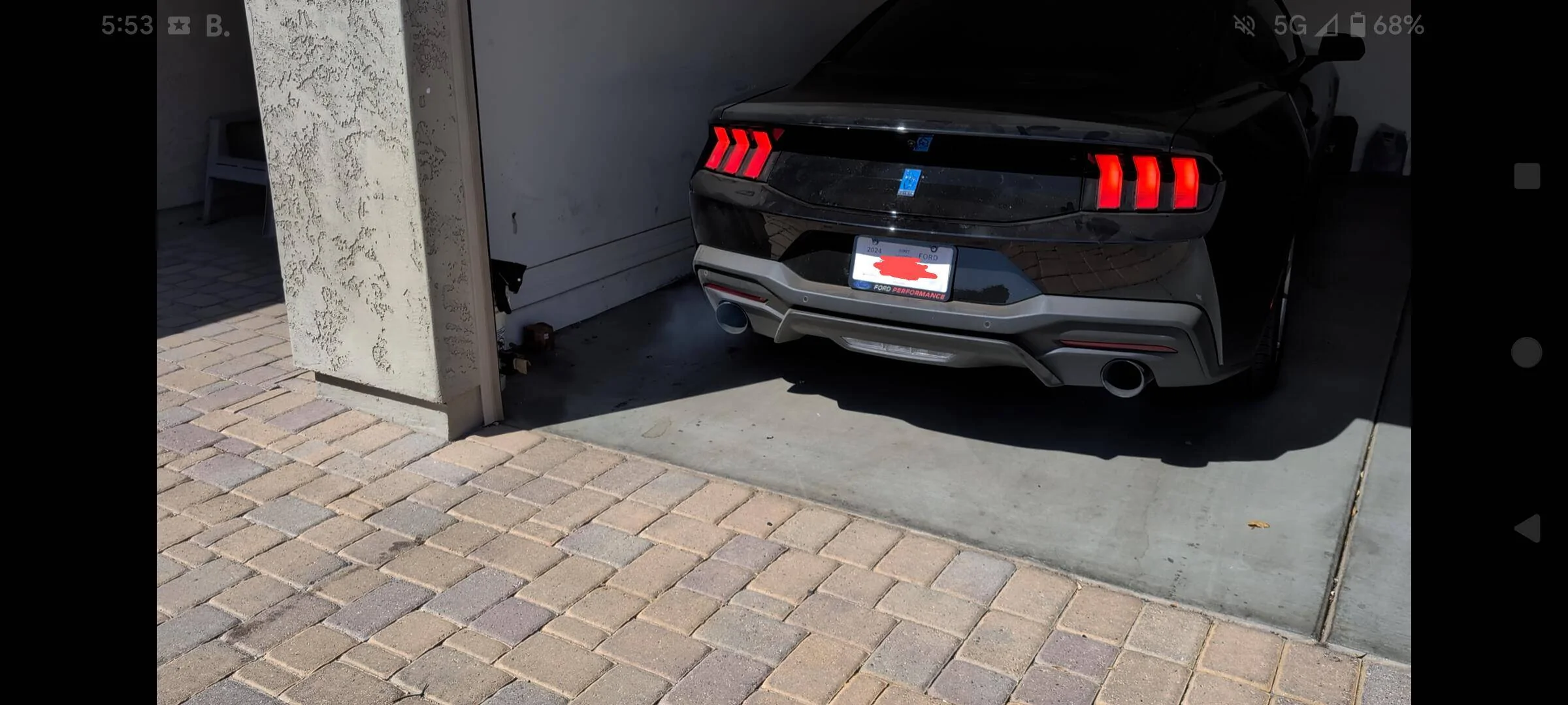

Blue Smoke on start up after the car has been sitting a couple of hours.

Nothing out of the norm. About 1 quart per oil change
OK, that's not excessive, but it is more than mine uses. Type of driving conditions could account for that.
Having said that, it does sound like a valve guide seal issue, which isn't usually a head off matter.
