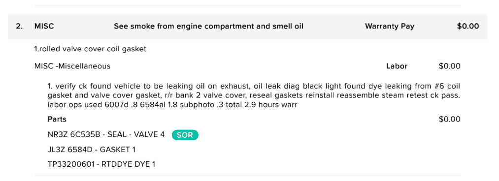

UPDATE: I just got a voicemail from the dealer that has my car. They said they figured it out, but I’m not sure exactly which part they are replacing. The voicemail said, “it’s the spark plug tube that goes in, and theres a seal in there, and for some reason the seal didn’t get all the way on to the tube there so part is on order and should get here early next week”.
Anybody know which seal they’re talking about?
Edit: just researched a little, and I assume they mean the seals between the heads and valve covers in the spark plug tubes got mangled during engine assembly. I guess this is fairly common on coyote crate motors and new cars.

Dealer called and said my car is all fixed up. He said it was definitely an assembly issue and the seal was not correctly positioned. I guess the mechanics were surprised it made it 1400 miles like that. I asked if it caused any other damage and he said no. You guys may want to look closely for leaks around your valve covers. Even though my car was leaking a lot of oil, I never saw any on the ground because of the underbody covers.

I haven’t had any issues since the dealership replaced the seal on mine.

Update from dealership: a new valve cover gasket is ordered, as well as another small miscellaneous part that I didn't yet get details on.
Interesting to have a D.O.A gasket for the valve cover. I guess it will either fail in the first 100 miles, or won't fail until closer to 100,000.

Mine wasn’t a failure. They said the gasket was incorrectly placed during assembly. I think most of these leaks are assembly error at the plant.
