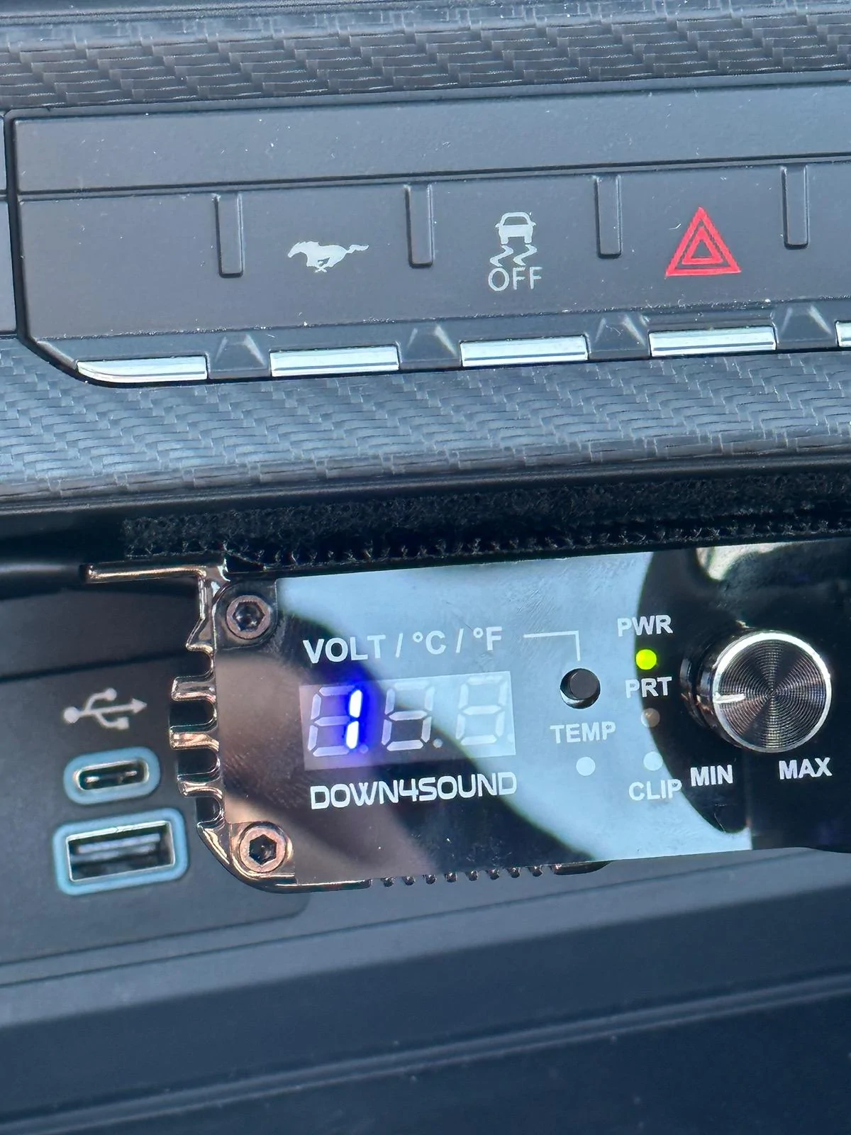

Taking spot readings doesn’t work
I have a volt meter on mine built into my amplifier control and the car can be anywhere from 12.0V to 14.5V and everywhere in between at any random time.

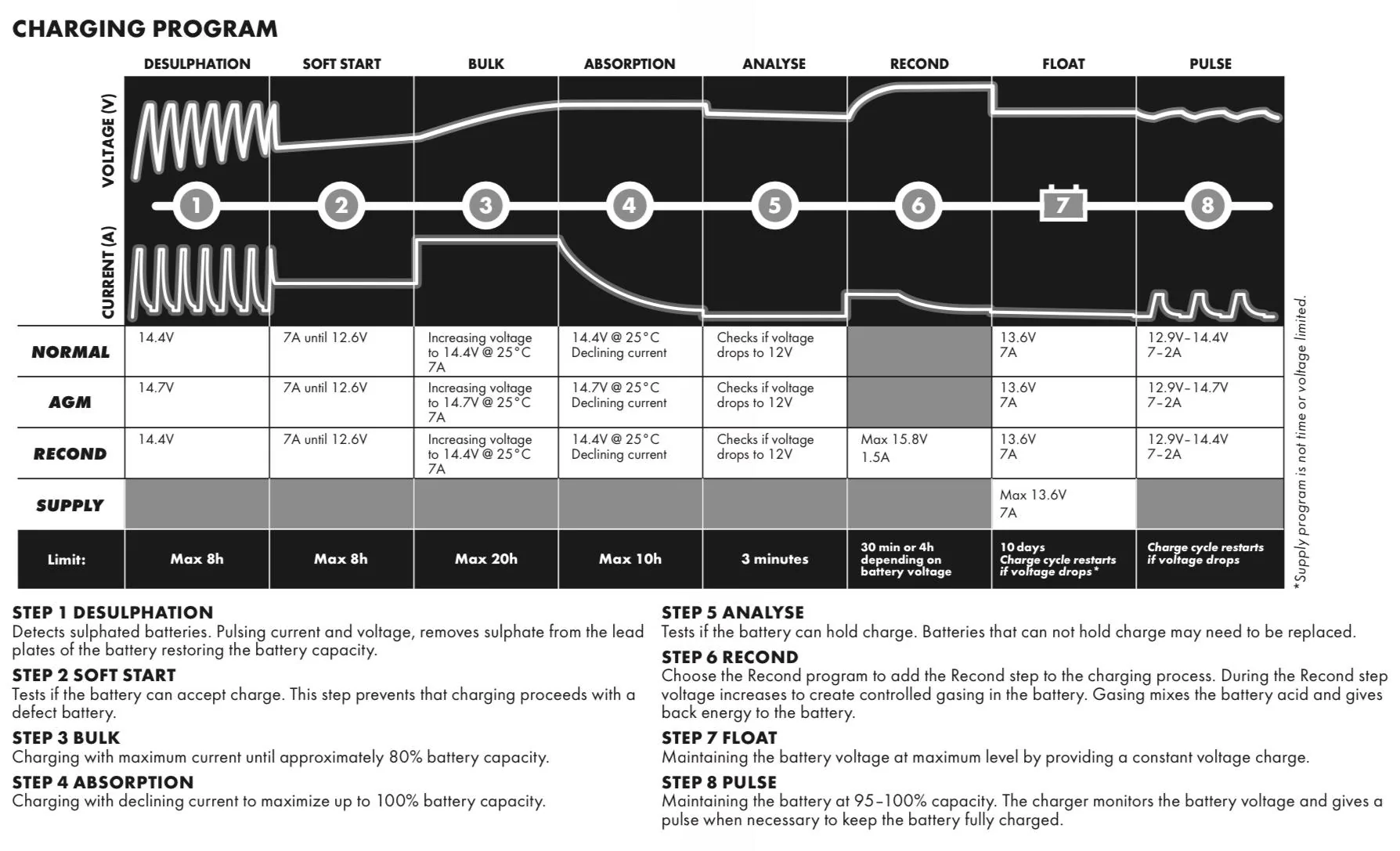

- Ford has a plan as to how batteries will be managed
- There are chargers and there are tenders
While both can charge a battery, the tender "exercises" (my term). IMO, a charger is more blunt, something of a constant force on the unit. I understand chargers can back off once it senses its job is done.
I haven't studied the different product lines, but I'm sure with some vendors, you can both charge and tend.
S650 Mustang Battery Management battery tender stages
