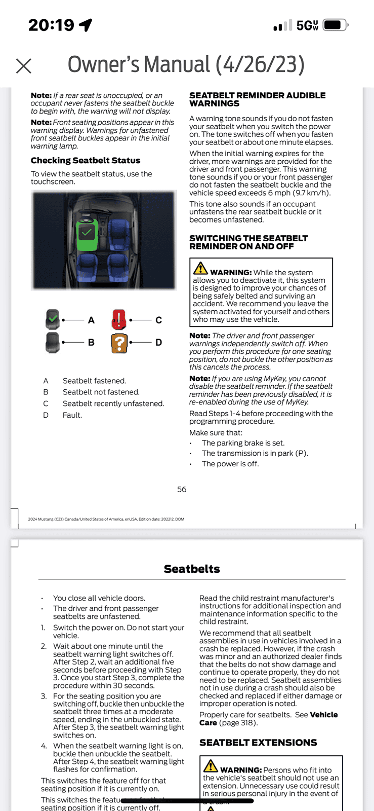

Yes I figured out how to disable all those options, only one I can't figure out is the seat belt reminder chime, I think that one is unavoidable
They have directions on turning off the seatbelt chime right in the owners manual.
It turns off the visual reminder on the screen, the chime is still enabled
