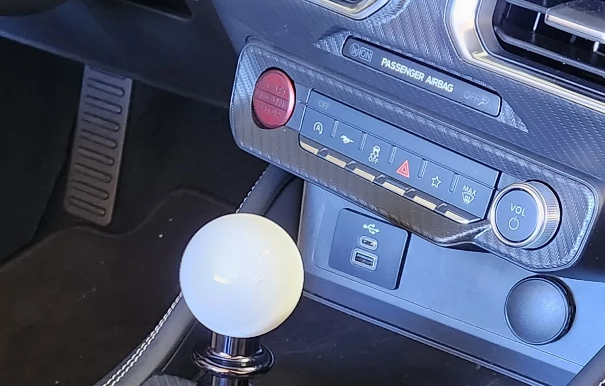

Does you car not have the ASS button - first buitton just to the right of the start/stop switch? This is a picture of my 2026 Ecoboost .........

EDIT: I guess I'm confused ...Does your switch panel look EXACTLY like the picture I posted???
