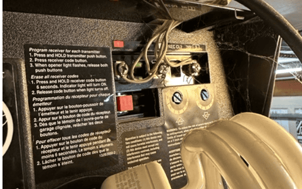

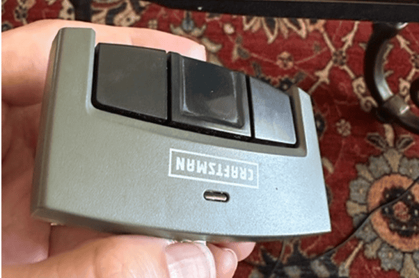

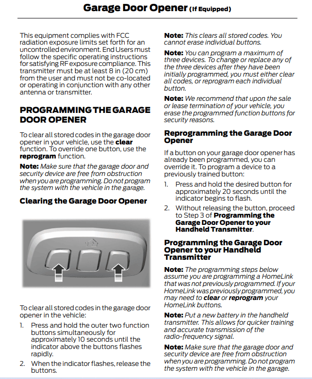

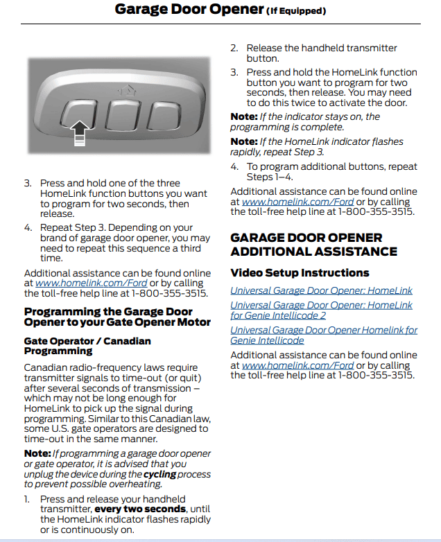

I've been messing with this thing longer than I care to admit and it's the first time I have had this type of opener. The only thing I noticed is that the manual says if you want to clear the codes to press the two outer buttons for 10 seconds but that seems to be more like 20 seconds so I'm wondering if the instructions are messed up in other ways. I tried programming it to both the opener and the transmitter and couldn't get either method to work. I just have a generic Craftsman. I would prefer to program it to the actual overhead motor but I would settle for either method at this point. The closest I could get was trying the transmitter method under "Programming the Garage Door Opener to Your Handheld Transmitter". I could complete step 4 but step 5 never did anything. Maybe my stuff is too old and incompatible or something.

Anyone that has issues programming the HomeLink garage door opener (All Fords are HomeLink) go to the HomeLink website. HomeLink.com It has the specific instructions for your vehicle written by the manufacturer of HomeLink (HomeLink is a common product for all OEMs).
Almost all garage door openers will be compatible, even those that still have the dip switches.
You do need to have a working transmitter for your garage door, the HomeLink in your car learns your garage door by "listening" to your transmitter and then copies it.
