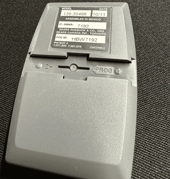

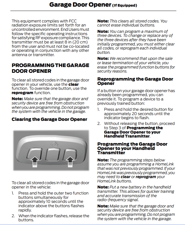

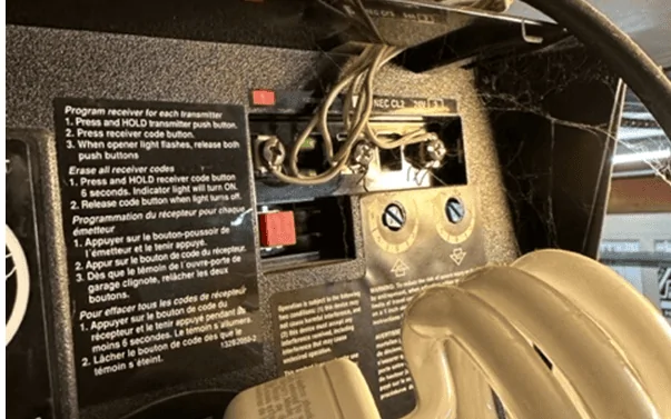

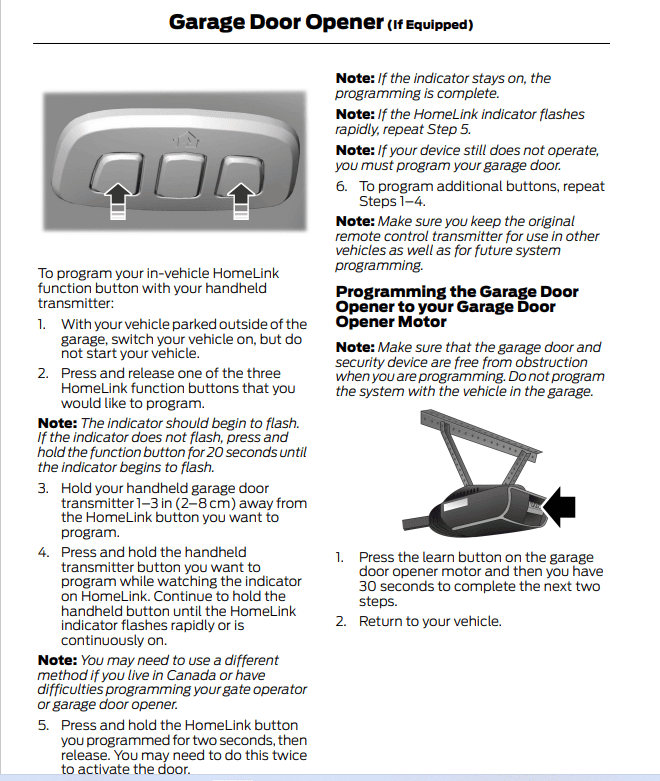

I've been messing with this thing longer than I care to admit and it's the first time I have had this type of opener. The only thing I noticed is that the manual says if you want to clear the codes to press the two outer buttons for 10 seconds but that seems to be more like 20 seconds so I'm wondering if the instructions are messed up in other ways. I tried programming it to both the opener and the transmitter and couldn't get either method to work. I just have a generic Craftsman. I would prefer to program it to the actual overhead motor but I would settle for either method at this point. The closest I could get was trying the transmitter method under "Programming the Garage Door Opener to Your Handheld Transmitter". I could complete step 4 but step 5 never did anything. Maybe my stuff is too old and incompatible or something.

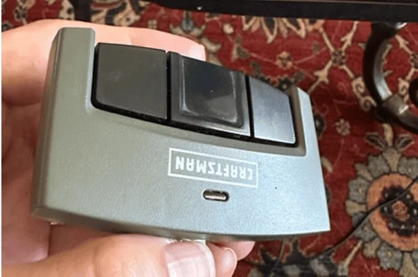

Yea, the hand transmitter still works great. Bought it a couple years ago and it was able to work on my old opener. The opener itself is over 13 years old as I bought this place 13 years ago and I've never replaced it. It has a keypad for the outside and everything still works great so I don't really want to replace the overhead unit just to make this thing work. I might just buy another remote to keep in the Mustang but that's going to annoy me knowing it should be built into the visor. I noticed the Craftsman transmitter has a small program button on the backside you would press in with the tip of a pen but the directions in the Mustang manual don't mention anything about using that type of button and I don't use it when I'm programming the Craftman transmitter to the opener either.

I tried for an hour to program mine and never could get it to work. At one point I erased everything off of my garage door opener by holding its button too long. I had to reprogram all of my openers and keypad after that. Thankfully I had an extra handheld opener to clip on my visor, but I’d much rather use the home link buttons

I’ve had luck with the holding the transmitter close to the home link buttons and linking that way.

Yea, that is what I was doing. The directions indicate to hold it 1 to 3 inches away I believe. What kind of overhead system do you have? Is it old? Did you replace the batteries in the transmitter before trying to program home link? The directions suggested doing this with fresh batteries but I haven't tried that yet. Seems kind of pointless when it's still functioning from far away.
