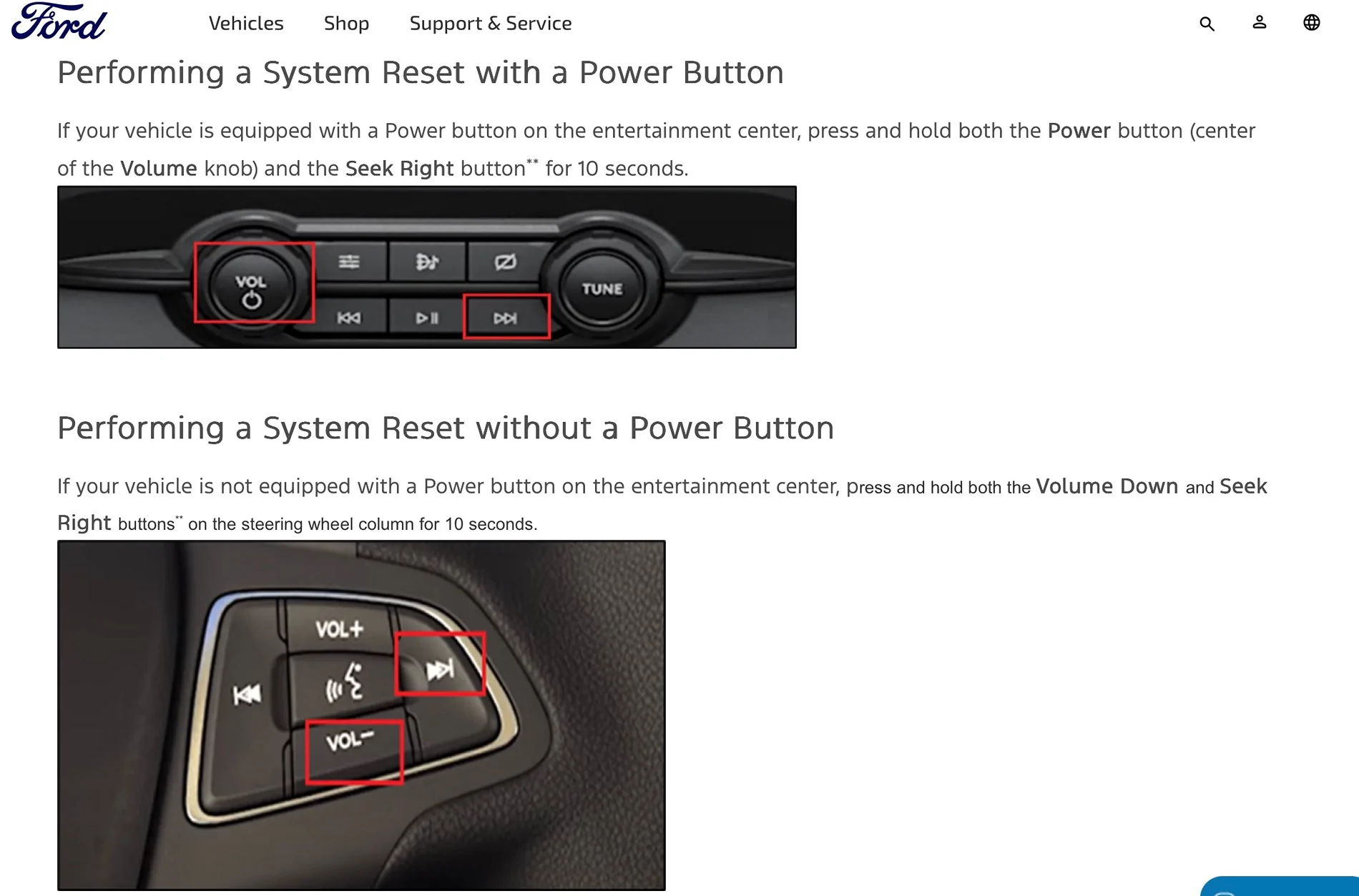

Also try the infotainment reset procedure. The procedure is convoluted because you have to press the stereo power button and the forward seek button simultaneously for 10 seconds. The fwd seek button is digital, So I guess you have to press the console power button and the physical steering wheel fwd seek button.
There is also this procedure to also try. (See below) The dash pictured below is different, but in my 2025 manual, the procedure doesn’t make sense, as it claims the stereo power button is on the steering wheel.
I did try the rest four times. I keep getting a message the battery is low, take a long drive. Then I get a message that the car is now unblocked. Really don’t understand that one. I had a 2015 that I had to keep on a trickle charger even though it was a new battery. If I didn’t, the car wouldn’t start after one night. That was fun. Nobody found anything pulling on the battery.
