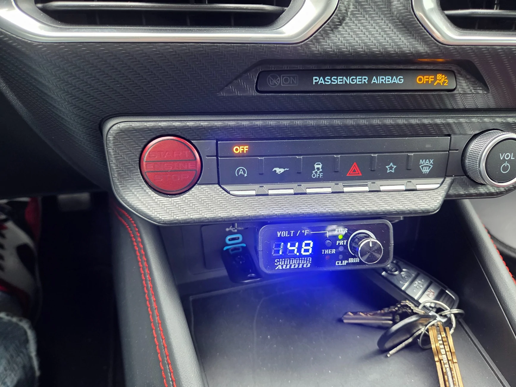

No battery issues here yet. I did get the Big-3 done with 0-Gauge wiring though. Using the factory battery.
Also, the Sundown Audio bass knob has a digital read out on it that I keep on Volts.
When I start up the car it always ramps up to 15.2-15.5 Volts. It can range, randomly from 12.5-14.8 Volts and does so w/o anything turning on or off, and without adjusting the volume.
Usually though it sits at 14.8 or 13.2 or 12.8.
Edit: It's 14.8 NOT 4.8...phone cam wouldn't pick up the 1 well.😂
