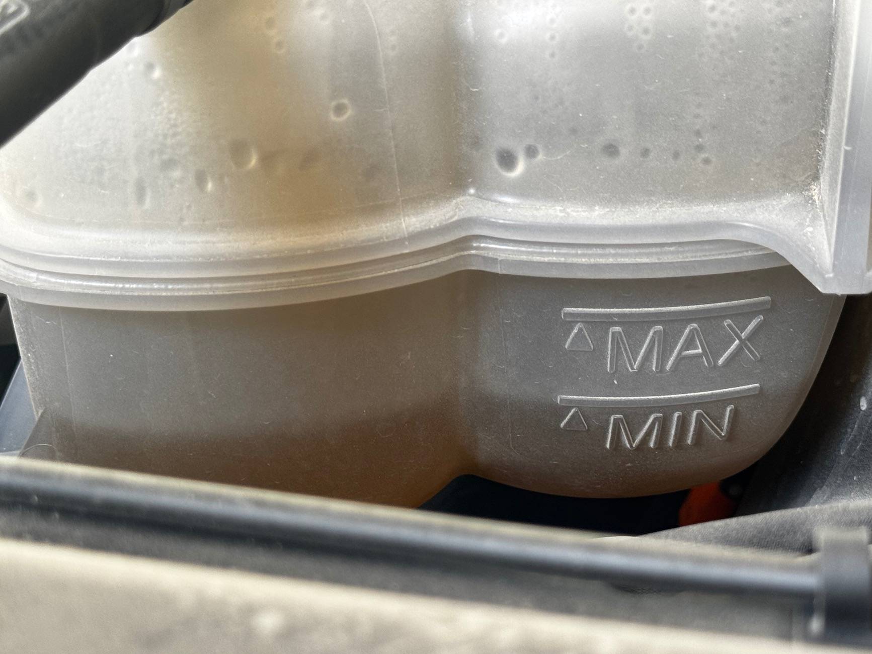

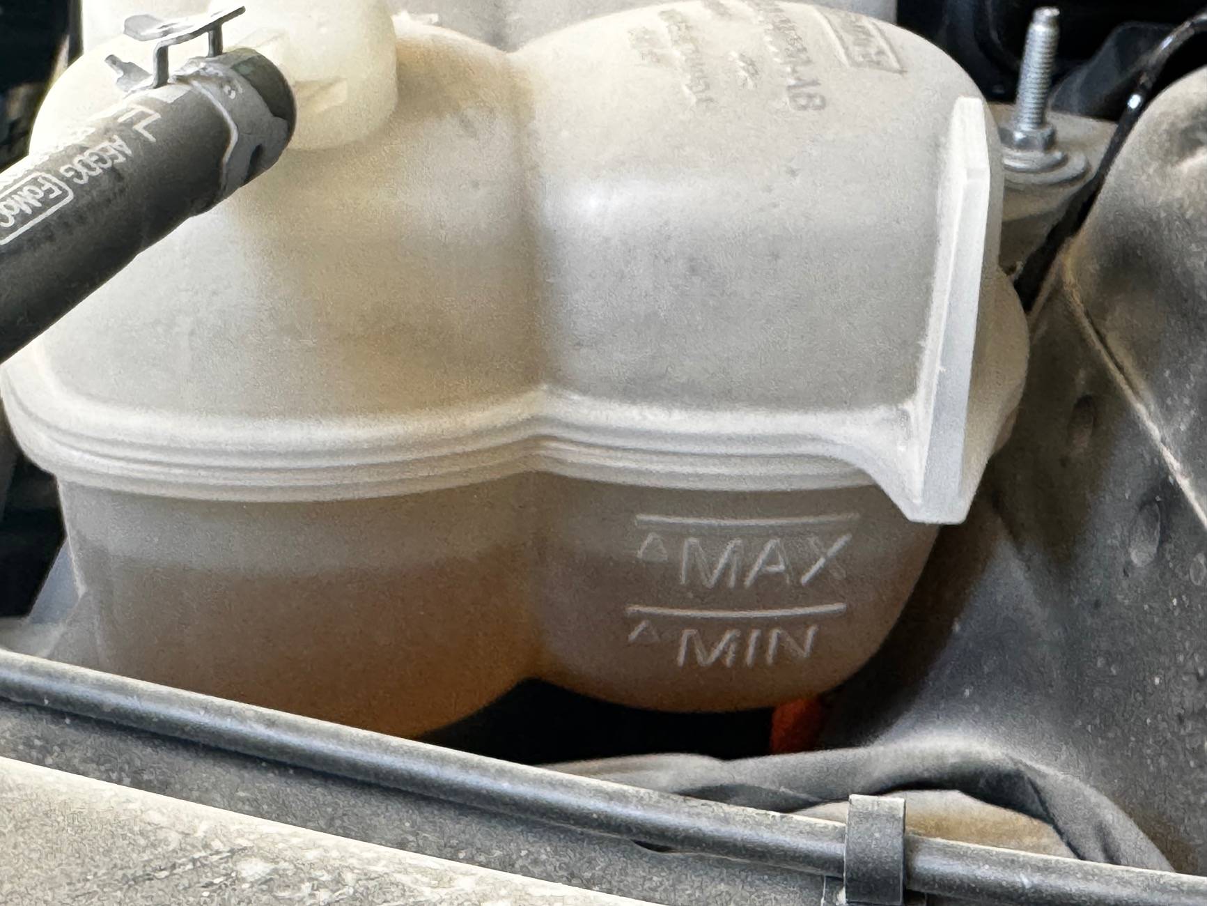

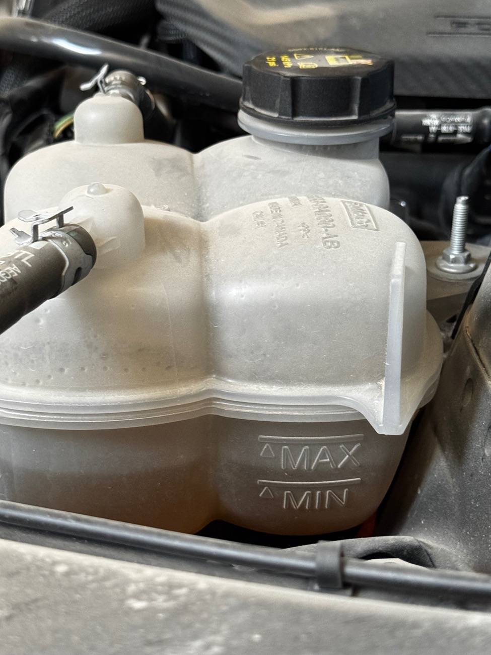

Hello community,
I have suddenly noticed low coolant water under the hood and got worried that there might be a leak, so i scheduled a check up date at the dealer’s main branch next week to fully check the car, however today i went to a sub branch and they checked under the car and told me there is no leak. The following photos are when they added more water and the next photo where water got reduced the next day immediately. The below minimum is where i noticed the problem intially.
Should i stop driving my stang temporarily till the scheduled maintenance date? Thanks in advance.

Did they add water when the engine was warm/hot?
If so, this is why it's down when cold.

Raise the hood, check the level (top off if needed), start the car, let it get to operating temp, check the level, if below low add coolant while engine is running, let engine continue to run, watch engine temp to make sure it does not continue to climb, check level, reinstall coolant lid, shut off engine, let sit for 30 minutes, recheck level. If level is above low, coolant level is sufficient. If level below low repeat a second time, if coolant continues to stay below low check under car for fluid or watch for white smoke from the exhaust. Little bit of condensation steam in the morning or upon first start is normal but shouldn’t last more than 30 seconds or so unless outside temp is below freezing.

Even if you can’t see a leak, smell under the hood after a run. It may be vaporizing from a poor fitting or something. (Just see if you can detect it, don’t be huffing under the hood…lol. The fumes are not good.)

Thanks everyone, I am still a few days ahead of my dealer schedule, but i went to a popular mustang workshop and the mechanic told me it is normal and proceeded to open the coolant cap while the car was warm. He opened it for a few seconds, water boiled and went straight up and it was between Max and Min suddenly. so I am suspecting that there is air going in because of the cap itself. I am glad the issue became smaller, now when the car is cold it is a bit below Min, and when car is warm it goes up but I will update on the dealer inspection.
However I took the car for smaller driving trips, and temps were very normal just like the day I received the car. I have to note that we have very hot dry weather :p

Hello Community, just wanted to update on the situation. They have checked the cooling system and no leaks at all were found (no fault), the suspected issue was the cap was not closed in fully or in a good way so air came in and made the liquid go way down. now I have been driving the car for 10+ days and things are 100% okay.
