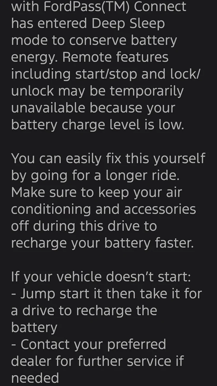

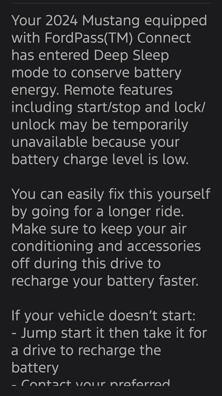

Got this message on my phone last night. First time I've ever seen it.
S650 Mustang Another low battery issue... Screenshot_20251026_201214_Ford
S650 Mustang Another low battery issue... Screenshot_20251026_201219_Ford
I hooked up my battery tender and charged it over night.
This morning on my way to work, I got the chime again on startup, instead of the heartbeat.
On my way home everything was normal and got the heartbeat on startup.
I am now convinced that the periodic chime instead of the heartbeat that everyone seems to get, indicates a low battery message that happened on the previous cycle.
After this and the update issue due to low battery, I am apparently going to have to start charging my battery once a month even though it's my weekly commuter. I do have a very short commute. Only about 4 miles that only takes 10-12 minutes and no freeway. So I know that's not much charge time. But still, I have to wonder if these cars have a parasitic drain, or just inadequate batteries.

What is your bulid date? Early job one cars sat when the line had issues. There where many compaints with battery problems that got replaced. These AGM batteries are suppose to charge fairly quick. Maybe 4 mile trip isn't quick enough.
3,875
5,463
The issues seems to be the batteries on these car aren't getting fully charged on a regular driving, or they are draining way to fast due to the electronics. My guess is the latter. There are tons of people on this forum who couldn't get the latest update due to a low battery condition and didn’t know it.

All good points. I'm sure many modern cars aren't charging 100%. And to be clear, I'm not worried about a dead battery necessarily. I've never had a hard start or voltage warning in the car. But, when you are getting these messages, and you can't perform software updates, it seems like either the battery/charging system isn't quite adequate, or there is a drain somewhere. I agree about all the sensors and noise it makes. I can't even walk to the fridge in my garage without things clicking in the car.

I've never checked the draw when starting, but some engines could take as much as 200A of current to spin over. Once running, the alternator assumes the load (ever higher in modern vehicles) and charges the battery. But at four miles and ten minutes, that's not a lot of time.
When I was studying one power-related topic, I encountered a sea of similar threads: different makes and models, the owners expressing concern how quickly their batteries could be drained.
These vehicles are busy, even when sitting and not running.

IMO, load shedding and/or battery preservation in Fords can happen two ways:
I've seen that, connected to a tender or not, my car will alert me to sleep mode at about the two week mark. Consistently. Always has. This aligns with some of the verbiage in my owners manual. I believe Ford has a timer set to two weeks in the 6G. If not driven in that time, sleep or deep sleep is implemented. The car doesn't know when you'll be back. It's something of a safety latch. Just in-case.
The other way is when the battery is actually draining. We've discussed the parasitic losses. At a given point, the vehicle will begin turning down some features. It's been watching the battery's State of Charge and wants to ensure there's something left to start the car. Driver features or background processes are temporarily disabled as a result.
Edit,
To those considering Li batteries, like an Anti-Gravity, batteries like these will actually disconnect from the car to preserve charge. This can matter if using a tender, or for the uninitiated, attempting to start the car, but nothing, like 0 voltage, is present. Resets can be simple enough. There are some unique operating and charging characteristics to be aware of. Installation guides and owners manuals are available at the maker's web site.
