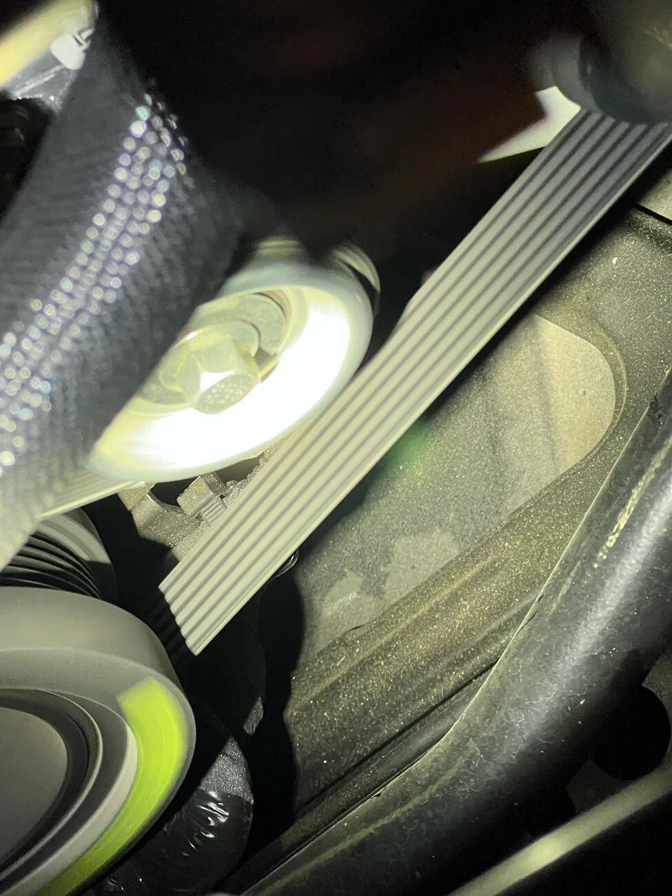

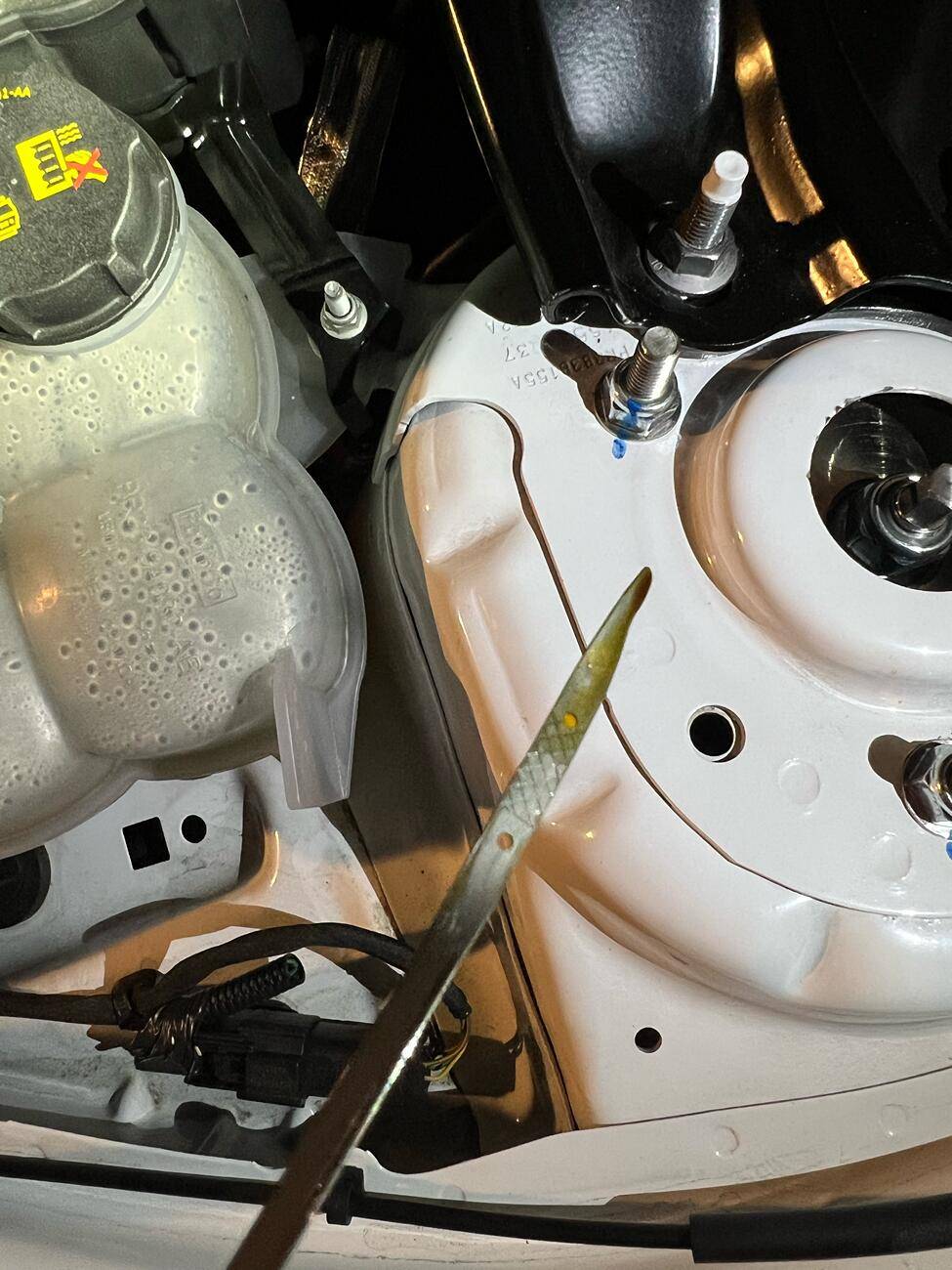

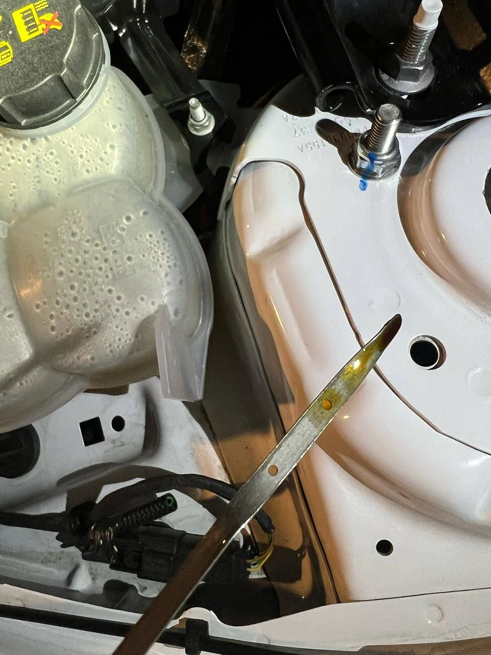

Got it. Thanks. I checked the oil level after having it parked overnight. This is what I see. It's within the hatched area but towards the low end...Also I noticed an oily area in the tray...not sure if it is leaking oil or its an oil spill form the last change...car has almost done 4300 miles since last oil change. Total mileage is about 15600 miles. I tried to look underneath in the oil pan and filter and around the ending bay, but did not see any visible leaks....will probably get a new oil change by end this month and will find out....

Nothing to worry about here.
When oil changes are performed, most techs spill a bit when taking off the filter. Looks like it just didn’t get wiped up very well. Does not look like a current leak. Using that amount of oil more than 4k miles after a change is outstanding. Make sure you use full synthetic oil, and change it as often as you can afford, but never past the recommended mileage. Just for fun and future knowledge, you could go ahead and put in half a quart and see what difference it makes on the stick.
