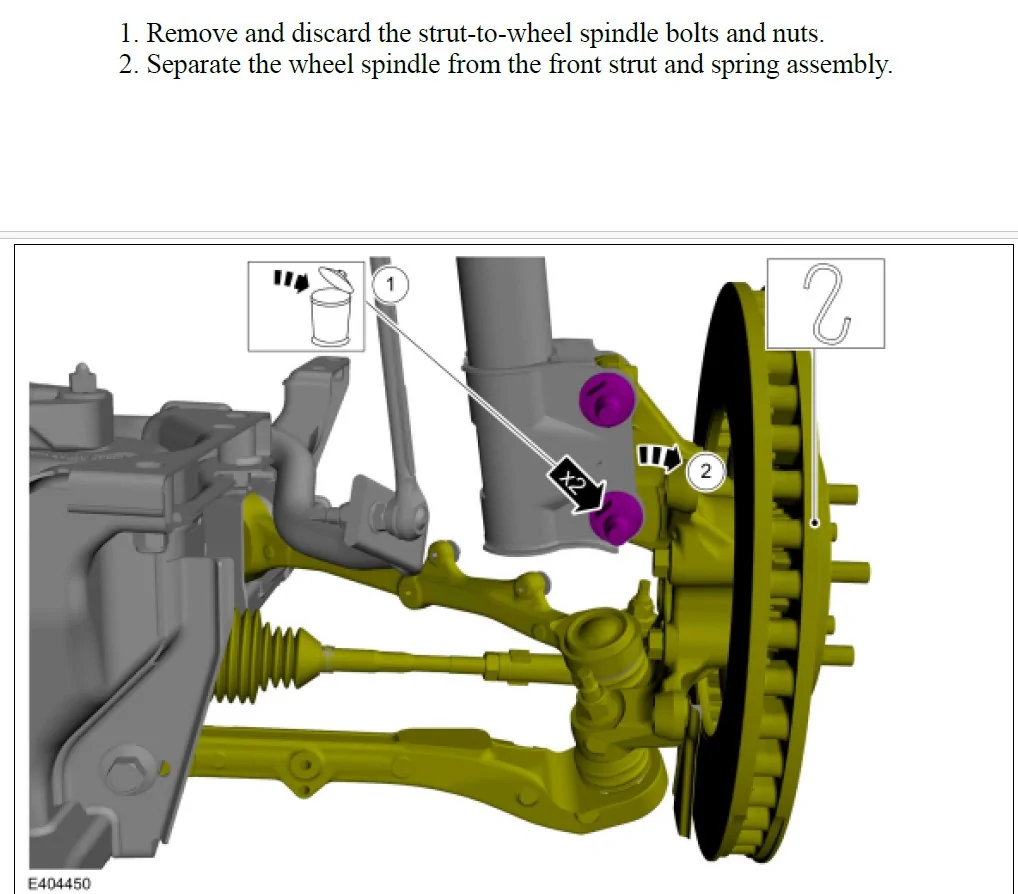

Does anyone have a list of what bolts are one time use from a service manual? I have found entire kits, but I need to know what bolts specifically are one time use when going from stock springs front and rear to ford performance so that I can order the appropriate items.

Ford for legal reasons lists All Suspension bolts and nuts as Remove and Discard in the service manual.
They show you a nice pretty picture of that.
I have re-installed the original bolts once and never had a problem but that doesn't mean the bolts wont eventually snap or the nuts work loose ...
S650 Mustang 24 GT Ford Performance Track Springs Install Remove_and_Discard
So is it just the strut to wheel spindle nuts? Nothing else is one time use?​

2004-2006 GTOs are the same way, nearly every bolt is listed as one-time use, especially the ones with loctite on them from the factory. The best explanation we got it at that GM would rather have a mechanic install a new bolt with factory loctite on it than cleaning the original bolt and re-applying loctite. I've only replaced a couple bolts out of caution, the rest were re-used and fresh loctite installed.
