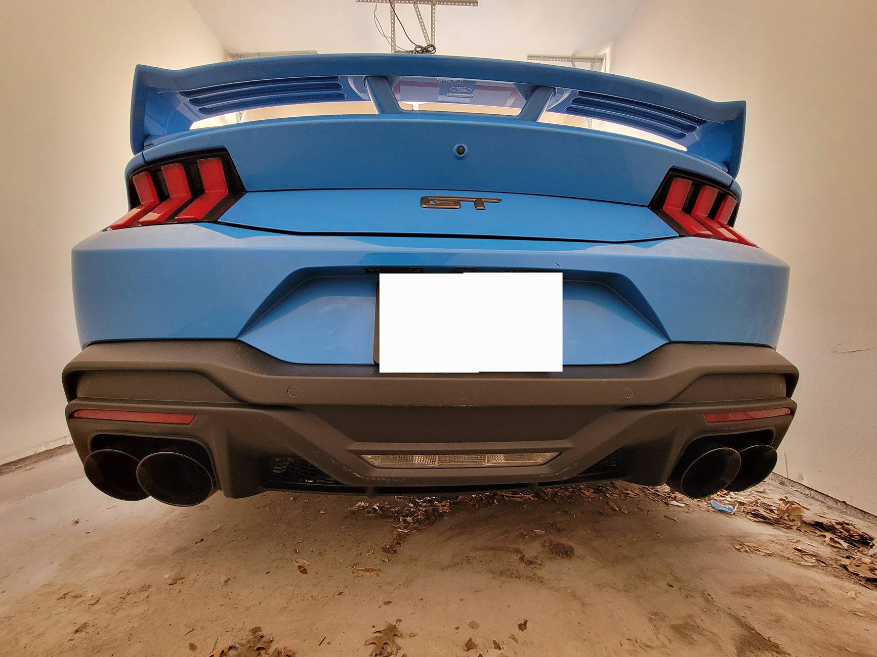

I am sure we must know this by now right? Does a dark horse rear valance fit a GT? I would like to swap one onto my car too.

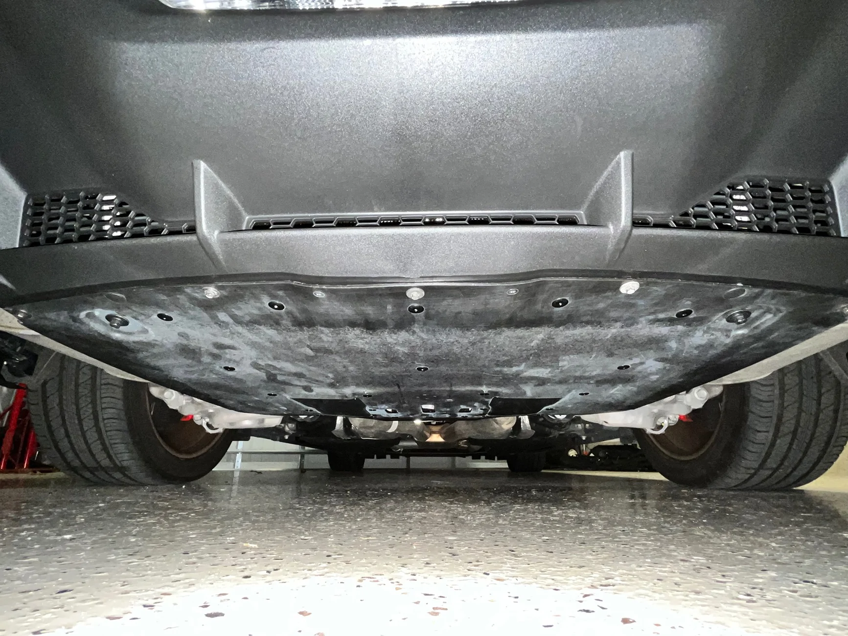

If you add a diff cooler, say the Steeda kit or even the Ford parts, you need the DH or DH style bumper because it has the required ventilation.
3,682
5,091
I'm adding the Ford diff cooler. Will this valance work?
I believe there is a strake under the valance that directs air to the diff cooler. I'd imagine it's part of the DH valance but could be wrong.

what is the permanent modification and to which replaceable part?
theres a plastic brace between the bumper and rear valance that has a couple bits that need to be cut off completely to properly install
Cool66
Jan 12, 2025
70
Fernandina Beach, Florida

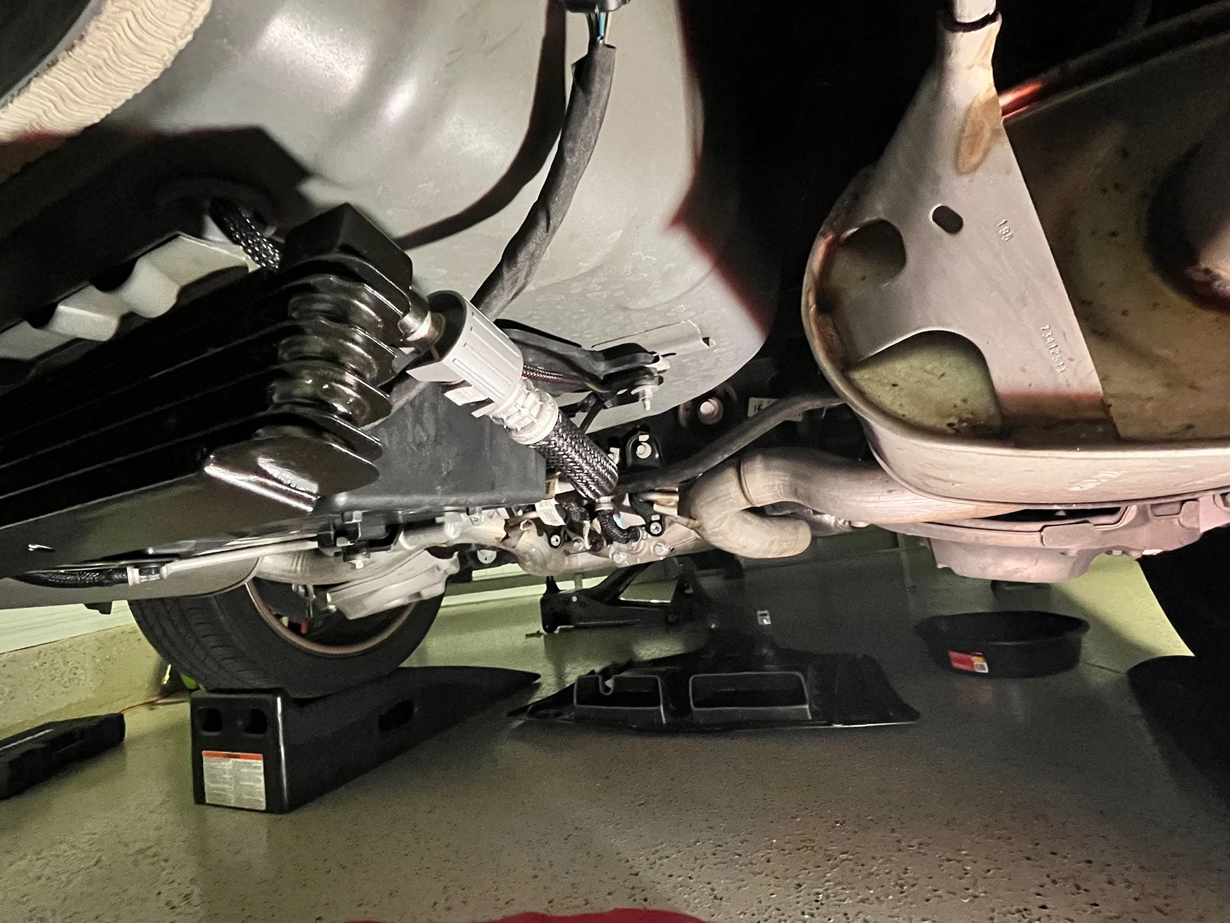

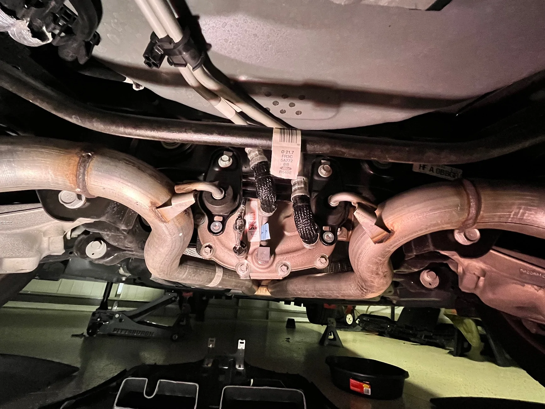

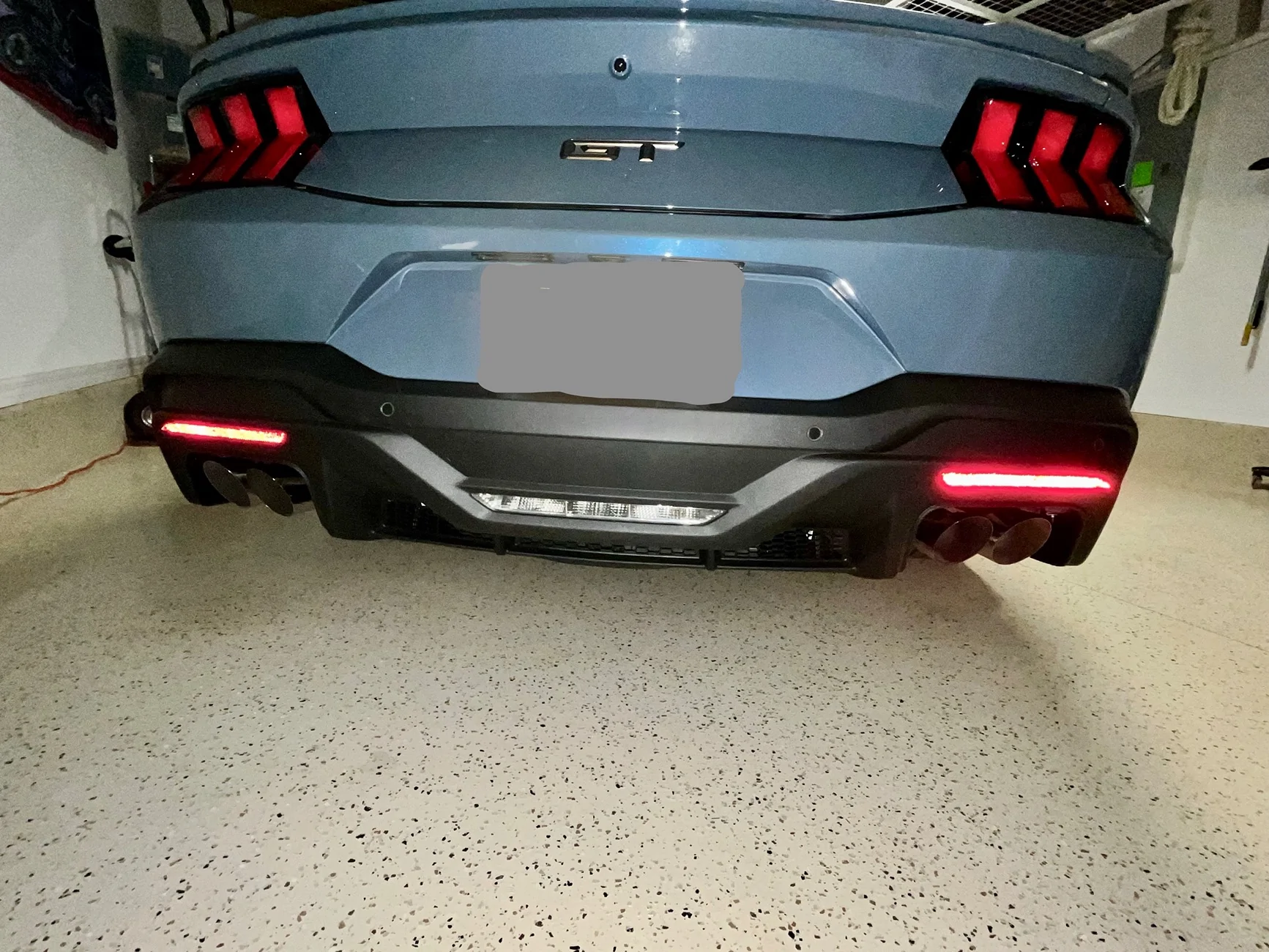

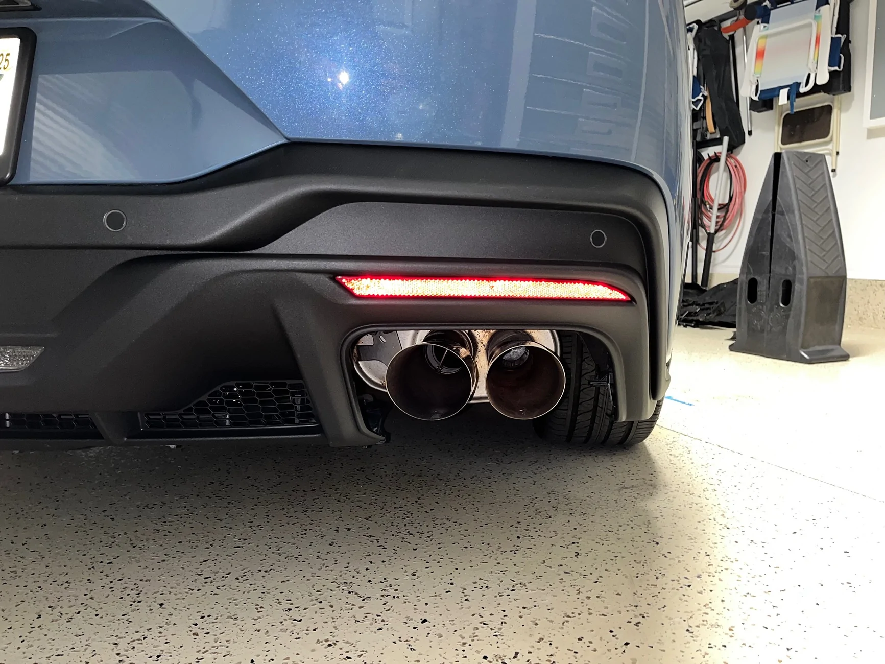

The absorber has two arms that are used for support of the lower valence and belly pan. Those arms will have to be removed for the new lower valence and belly pan to work. Finished rear diff cooler install last week. All OEM parts to down to the bolts except for the thermal switch. Easy install and straightforward. Just looking for the correct DH exhaust tips now.
I see agreywolfe has the larger DH exhaust tips installed. Any advice for the tips?
