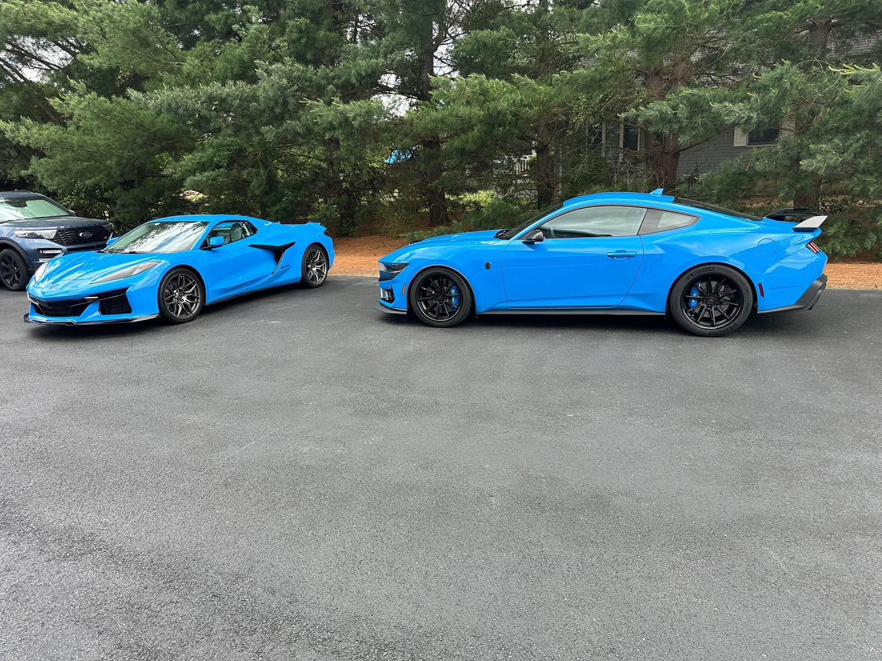

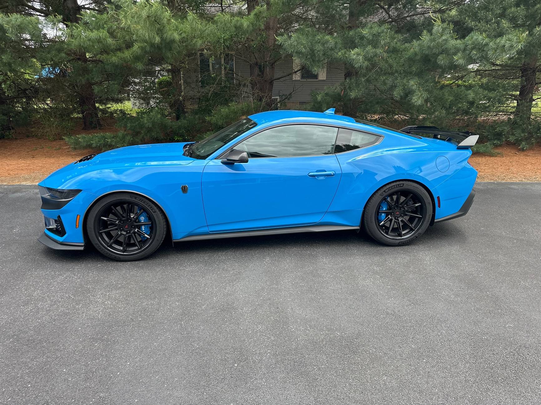

285/35/20 +28mm offset
305/35/20 +50mm offset
Michelin Pilot 4 All Season
Stock suspension
No rub. Ride is fine.
Speedometer lower than GPS
2 mph at 25-30 mph
5 mph at 55-60 mph
Check tirerack.com specs for your chosen tires to be sure section width & tread width don’t stick out past body.
S650 Mustang 19" or 20" wheels image
