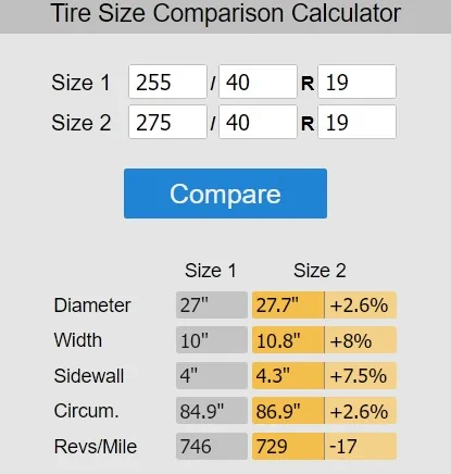

Thought about posting in the 'other' thread about tire sizes but figured to start my own. First of all, I'm replacing my stock PP wheels/tires (19" X 9" (F) 19" X 9.5" (R), 255/40R19 (F) 275/40R19 (R)) with new 20x9 square wheels and Continental DWS 06 Plus ExtremeContact tires. I am not looking to get into a conversation about summer/winter vs all-season tires or staggered vs square setups.
The Ford stock option (non-PP) 20x9 wheel option runs 265/35R20 tires. I did some research on tiresize.com:
Here's the difference with stock PP 19" front vs stock PP 19.5" rear

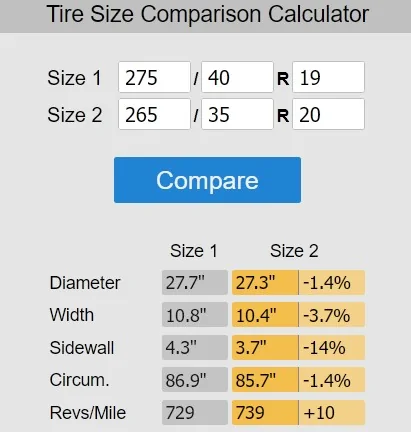

Now let's compare stock PP 19" front with Ford option 20" wheels:
S650 Mustang Tire width on 20x9 wheels (coming from 19" PP) ScreenHunter 120

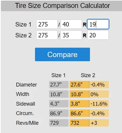

And stock PP 19.5" rear with Ford option 20" wheels:
S650 Mustang Tire width on 20x9 wheels (coming from 19" PP) ScreenHunter 121

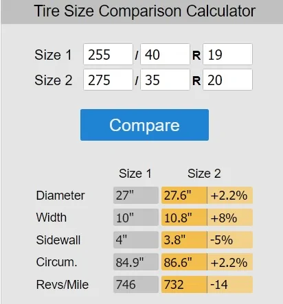

Onto my question. I was thinking 265/35/20 on my new wheels (to mimic the stock option). However, the 275/35/20 option is $300 cheaper (weird, right?) plus I think it looks better. The manufacturer claims that a 275 on 20x9 wheel should be okay. Here are some measurements vs the 19" PP stock:
Front PP vs new 20"

Rear PP vs new 20"

Front: +1.1% (+0.3")
Rear: -1.4% (-0.4")

Front: +2.2% (+0.6")
Rear: -0.4% (-0.1")
To me, both 265/275 options vs stock PP should be fine. Thoughts?
