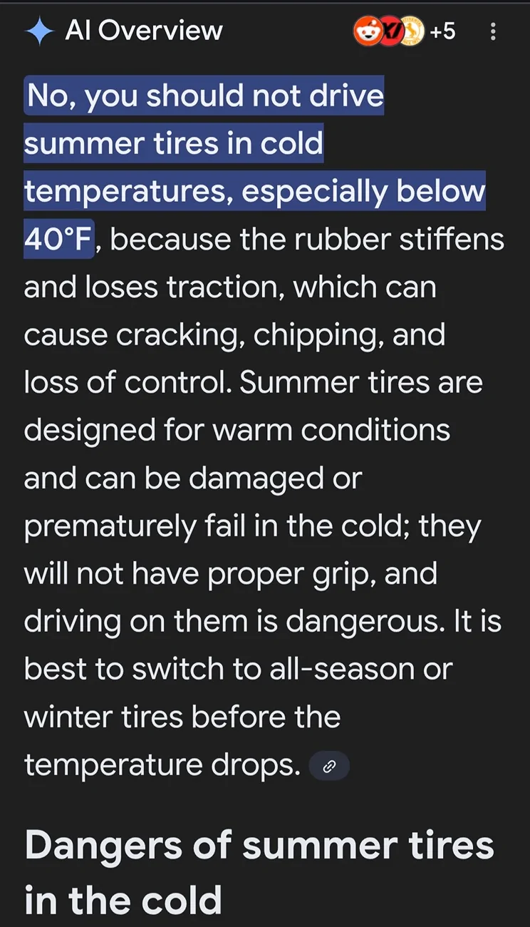

As for the temperature question, If you do a Google search there is a ton of information at your disposal including videos. It is widely known that summer tires get hard and lose grip in cold conditions. GM even did a tire recall a few years back because they discovered micro cracking in their summer tires due to low temperatures. Again lots of info is out there if you just do some research.

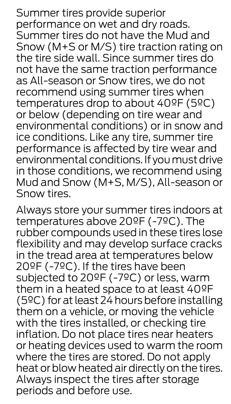

for keeping stock size, yes 4S could be an improvement. Winter depends entirely on what you experience in your local area. since everyone seems too lazy to just see what Michelin themselves say here you go.
