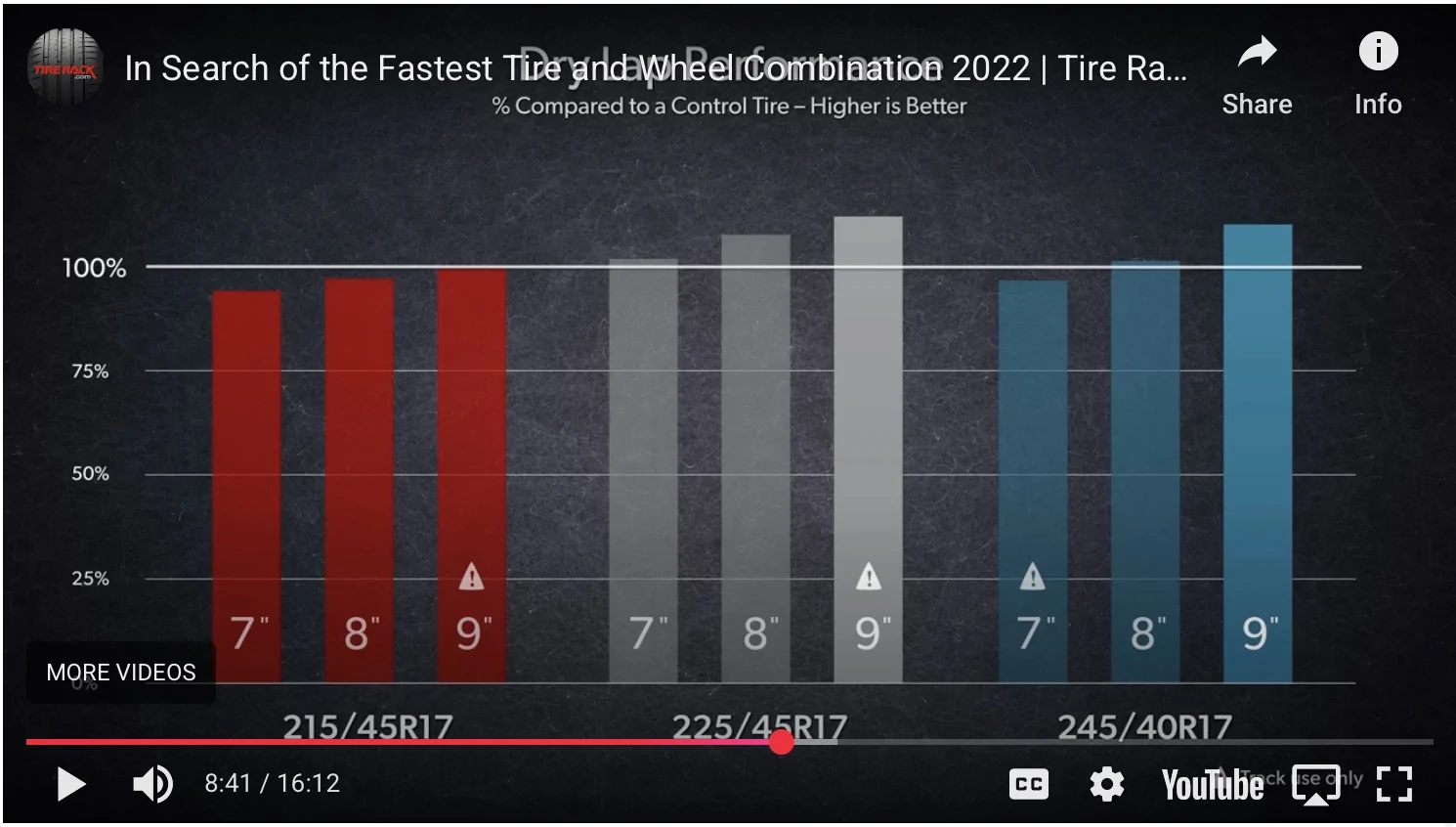

Junkyard Dog
Jun 3, 2025
2,970
2,469
I prefer the wheels are wider than the tires... in fact, Ford does too... they use the same 255 F and 275 R on the DH with wider wheels than the GT.
It is not just a preference. I posted a YouTube video somewhere here where the proved it using different tires and wheels.
Wider tires on a narrow wheel (pinched) actually slow the car down on track.
Found it! See next post.
Junkyard Dog
Jun 3, 2025
2,970
2,469
9 tests in total, three different tire widths on three different wheel widths.
Adding tire width reduces lap times, up to a point. Increasing wheel width for the same tread width reduces lap times again.
Watch this and see what you think.
Which tire size was fastest?
What was more significant, tire width or wheel support (wheel width)?
They also test in the wet toward the end of the video.
