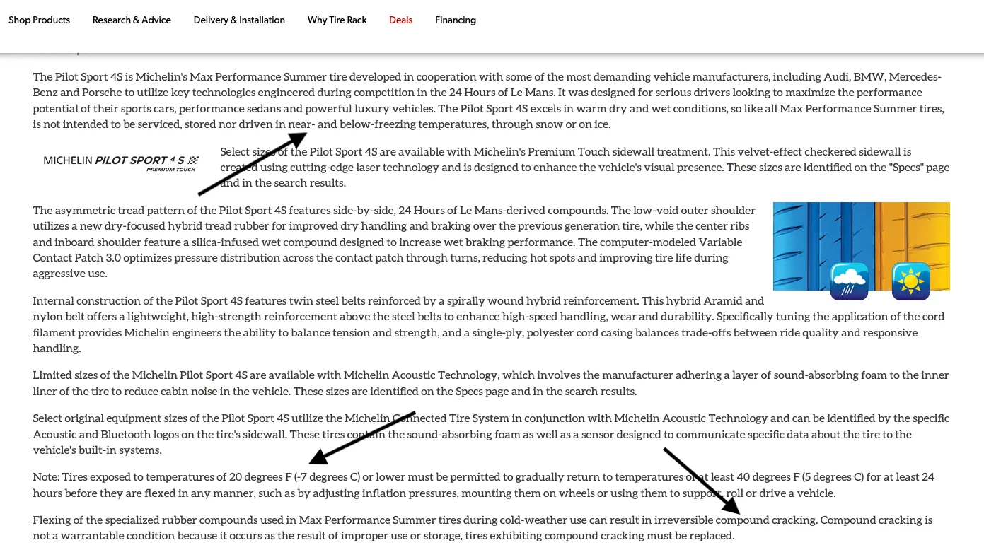

Did you read the link you posted and referred too?
https://www.tirerack.com/tires/michelin-pilot-sport-4s
0C is freezing....
+7 C the compound will get harder, the closer to 0 you get the more like a hockey pucky the tires become, the ps4s also have no siping needed for snow and ice.
parked or stored tires below -7C need to be brought back up to temp (+5c or more) before being driven on to prevent cracking as they flex, you also get alot into chipping on fozen summer compounds.
Spent 10 years working for a company producing rubber gum for Michelin, Bridgstone and others, the cold durometer testing on compoounds between summer only and all weather/snow compound is quite alot just from 0C to -20C
The Pilot Sport 4S excels in warm dry and wet conditions, so like all Max Performance Summer tires, is not intended to be serviced, stored nor driven in near- and below-freezing temperatures, through snow or on ice.
Note: Tires exposed to temperatures of 20 degrees F (-7 degrees C) or lower must be permitted to gradually return to temperatures of at least 40 degrees F (5 degrees C) for at least 24 hours before they are flexed in any manner, such as by adjusting inflation pressures, mounting them on wheels or using them to support, roll or drive a vehicle.
Flexing of the specialized rubber compounds used in Max Performance Summer tires during cold-weather use can result in irreversible compound cracking. Compound cracking is not a warrantable condition because it occurs as the result of improper use or storage, tires exhibiting compound cracking must be replaced.

Read it and quoted the relevant parts, yes. I feel like at this point I am still repeating things from pages ago.
I did not recommend it as a snow tire, or for you to drive in Ontario in January.
I merely corrected your 7° Celsius claim with -7°, which you have now quoted, so I assume we are on the same page, finally.
AND to be clear, I am not recommending it to the OP, since I see he lives in NY, but I posted that and already quoted it (reposted it), so, for the third time, I am not recommending the 4S for cold winters.
I have driven them through Georgia winters and not experienced any cracking issues or any other problems. I have also used the All Seasons.

The cracking issue comes up "when exposed to temperatures of 20 degrees Fahrenheit . . . or lower," see bottom two arrows that wesg79 drew.
Nowhere does it give any other rating like 40 degrees, much less "might actually be 50."
There is a statement of intention about snow, ice, and "temperatures near - or below - freezing." That is sort of a "duh" statement. Nobody is recommending them as intended for that purpose.
