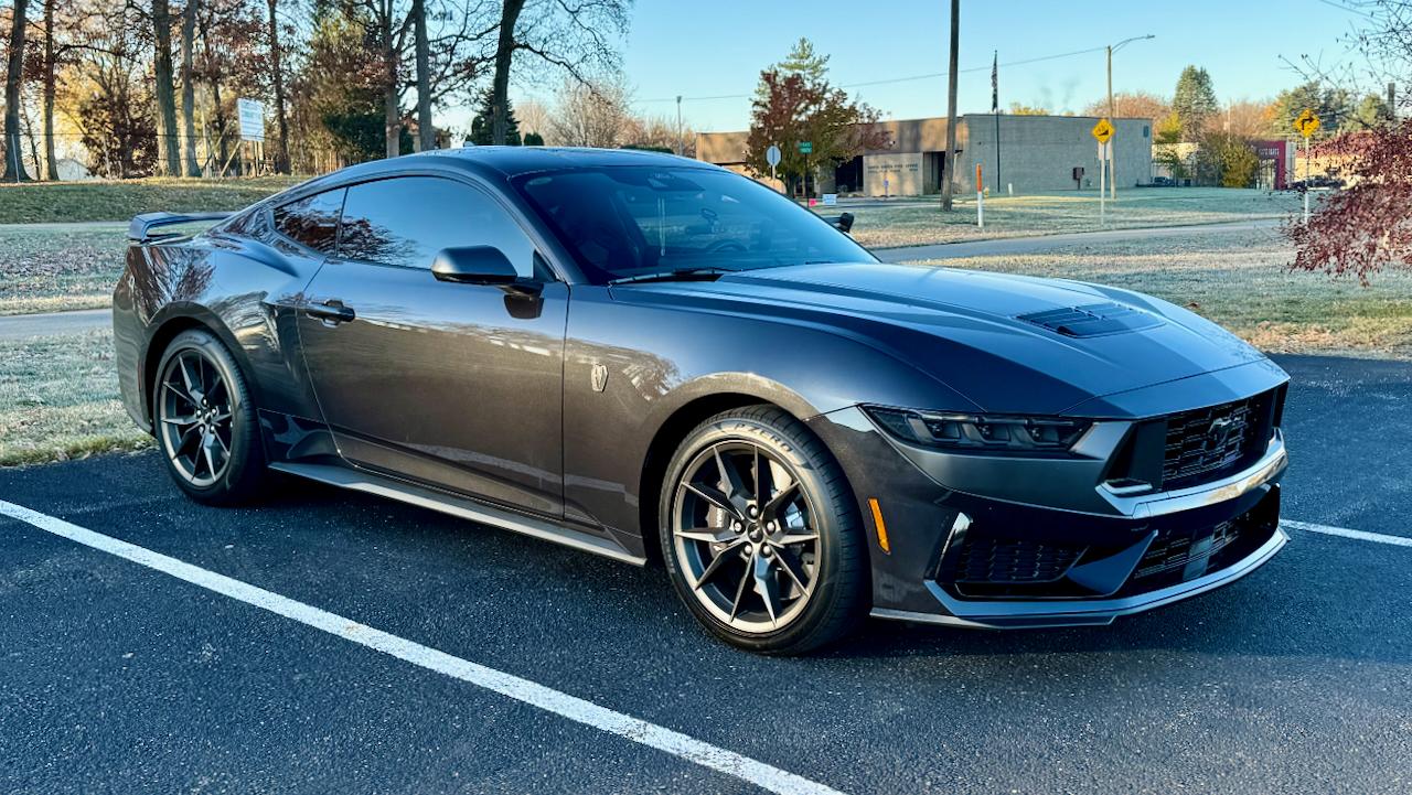

I'm sorry if this has been posted already (I tried searching but had no luck).
I have a Dark Horse Premium (Non-HP), and I'm considering putting some new tires on the car since I live in northern Indiana.
Stocks are 255-40-19 Front and 275-40-19 Rear.
Question: Should I stick with the stock tire size or bump it up? If I should bump it up, what are the widest tires I can put on these wheels?
This is my first Mustang, so I'm just trying to care for her as best as possible.
Thanks for the help!

I would go 275/35/19 front and 285/35/19 rear. Mich PS4S or the new Contis. Those would be a perfect fit. The 9.5"wheel supports a 275 tire and the 10" supports a 285" perfectly. I wouldn't go beyond that.

Thank you. This is exactly what I wanted to hear. Take care!
