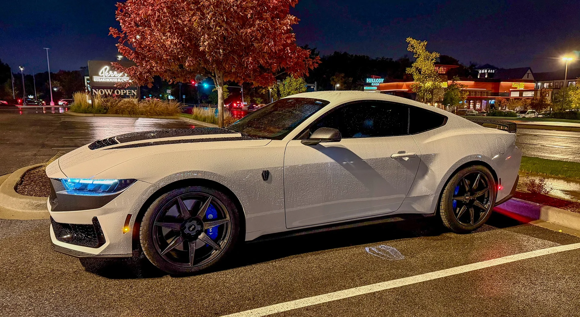

I’m in Chicago burbs and drive year round when I want to, so not when the streets are messy. Have been doing this my last 3 coyote’s . I find dedicated all-seasons for November-April to be perfect if you still want the car to handle well.
Then back to Summer tires for the other 6mos.
This time I tried 20” fatty DWS’s
Loving it!
S650 Mustang Yes, I know it's best to get winter wheels/tires for the GT, but how many opted for UHP All Season instead? IMG_0007
