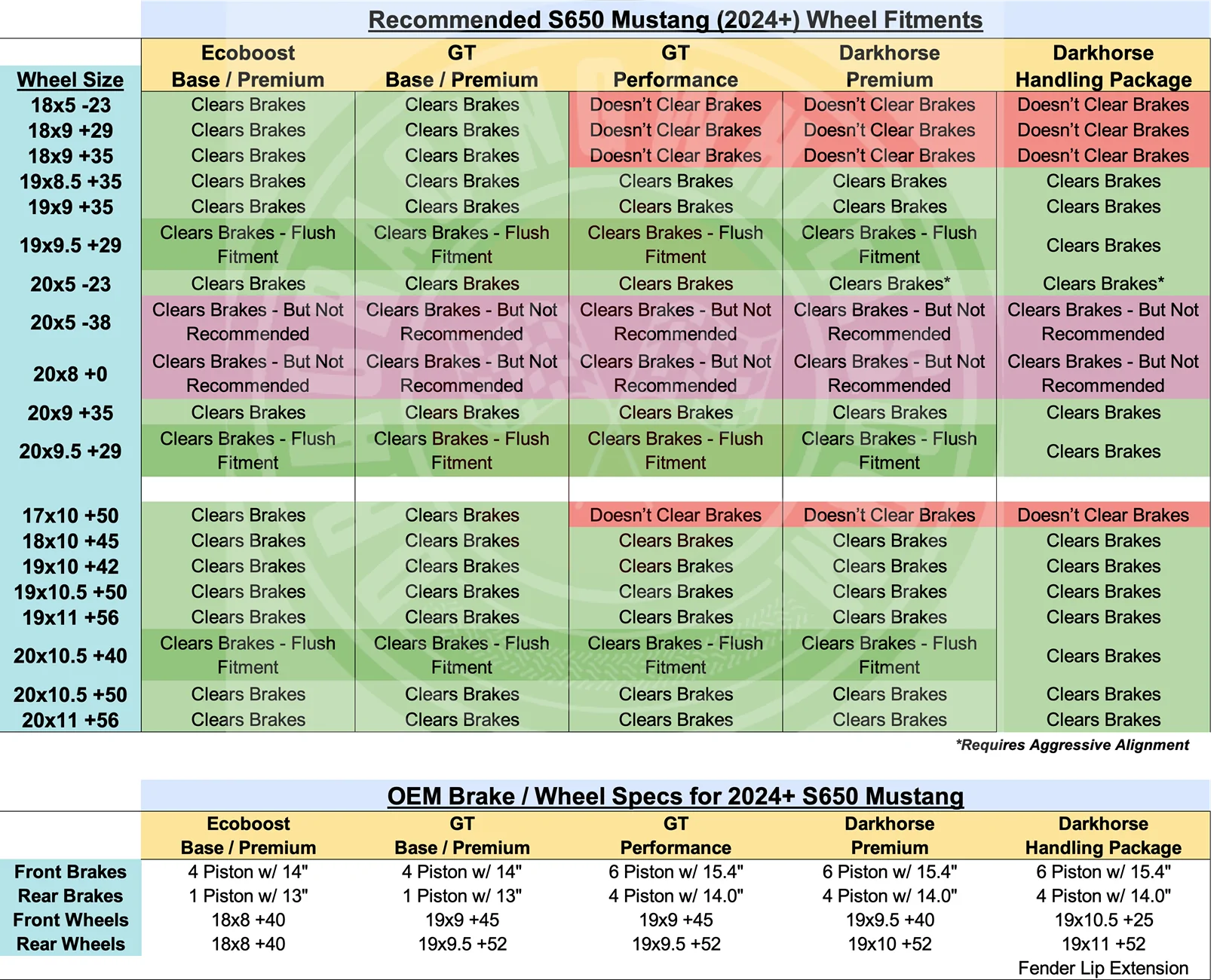

Attached is a tool with rim size and offset for the factory rims. It was created by the folks at https://dragracingwheels.com/ , a sponsor of this site.

I'm attaching some reference links. These are not DH-specific, but will have feedback from others.
https://www.google.com/search?q=mus...HcKaM0oQrQIoAnoECBkQAw&biw=1470&bih=747&dpr=2
The circumference of the tire can vary larger or smaller, to a point. Going beyond a limit, shift points can change, ABS can be affected, along with other electronics.
https://www.mustang7g.com/forums/threads/pre-collision-assist-cruise-control-problem.170023/
The idea of going from a 19 to a 20 is not an issue. The idea of going from a 18 or a "short" 19 to a "tall" 20, could be.
Going to a taller tire, to stay close to the original, many go from a 35 profile to a 30. With that, the ride is generally harsher.
Road conditions will be a factor. If you live in an area with good roads, it might be a nice change. With poor roads, you might stick with the 19s.
This is a good site for reviewing differences in sizing: https://tiresize.com/comparison/
