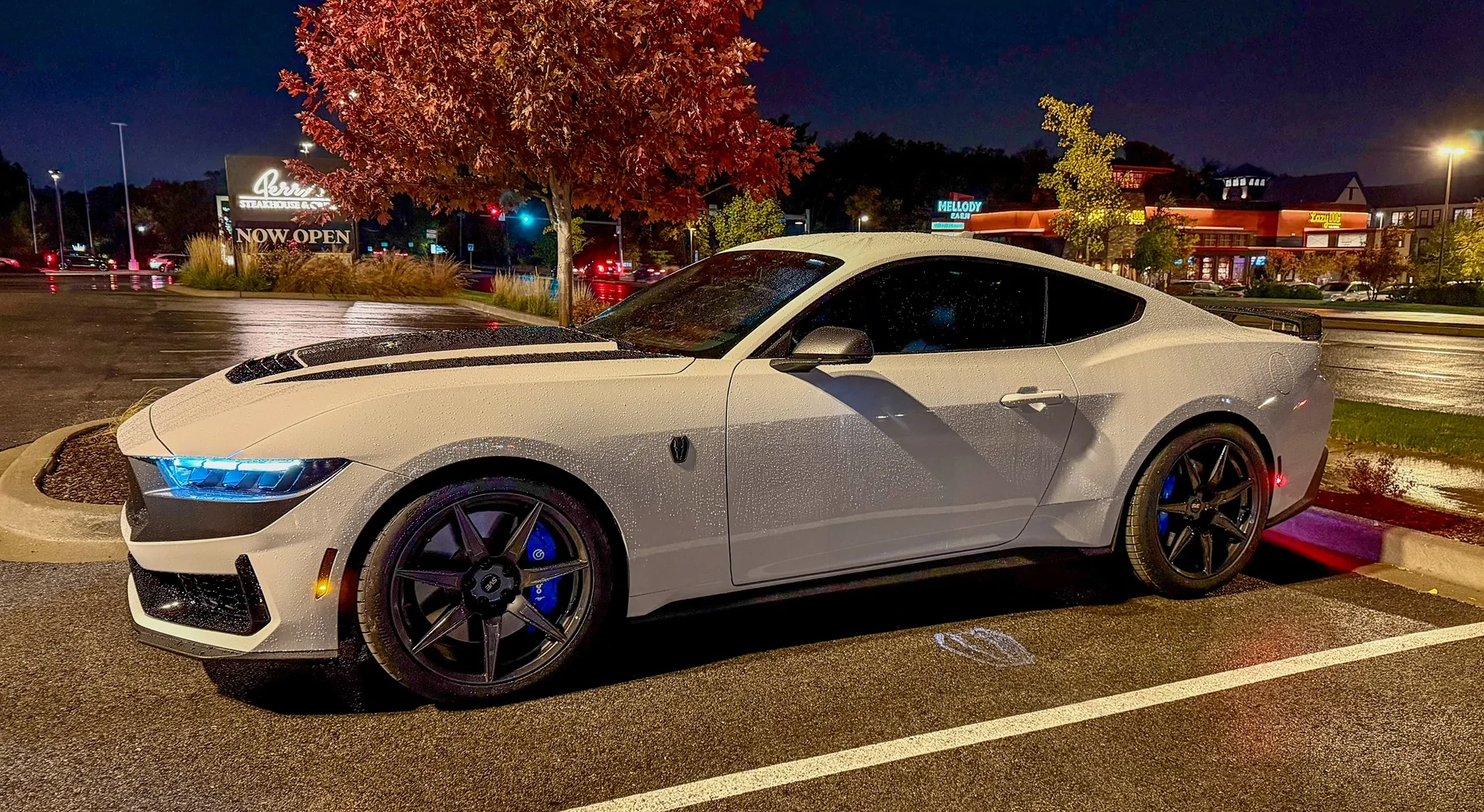

I wanted some all-seasons for my non-hp Dark Horse so I switched to 20's with 285/35 & 315/35 staggered Continental DWS Sport 06's
I'd say with this size it absorbs bumps in the road better.
Looks way beefier than stock too. since it's 1" in diameter bigger it also raises the car 1/2" but fills out the wells nicely.
I'm happy with it for my winter setup.
