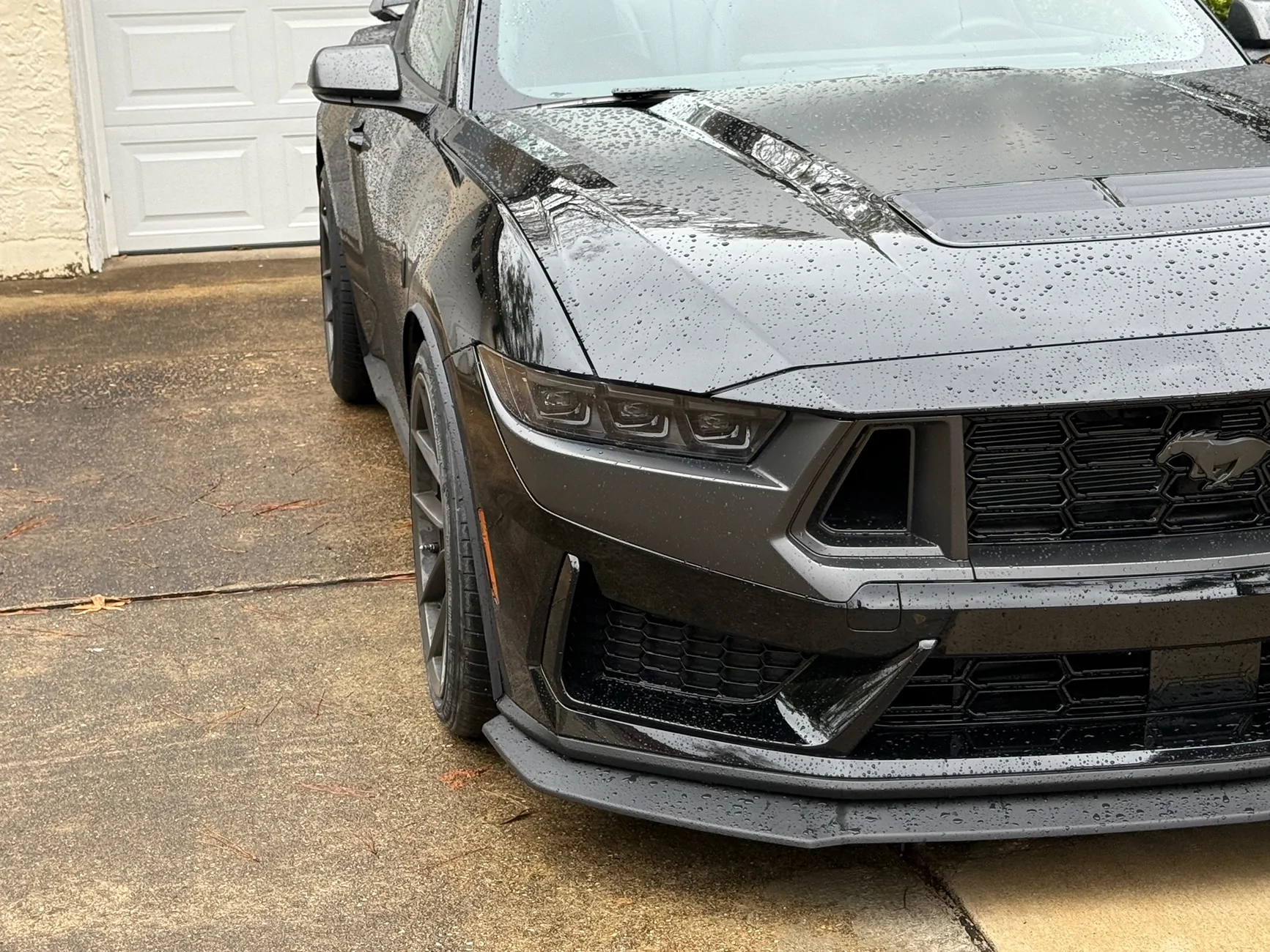

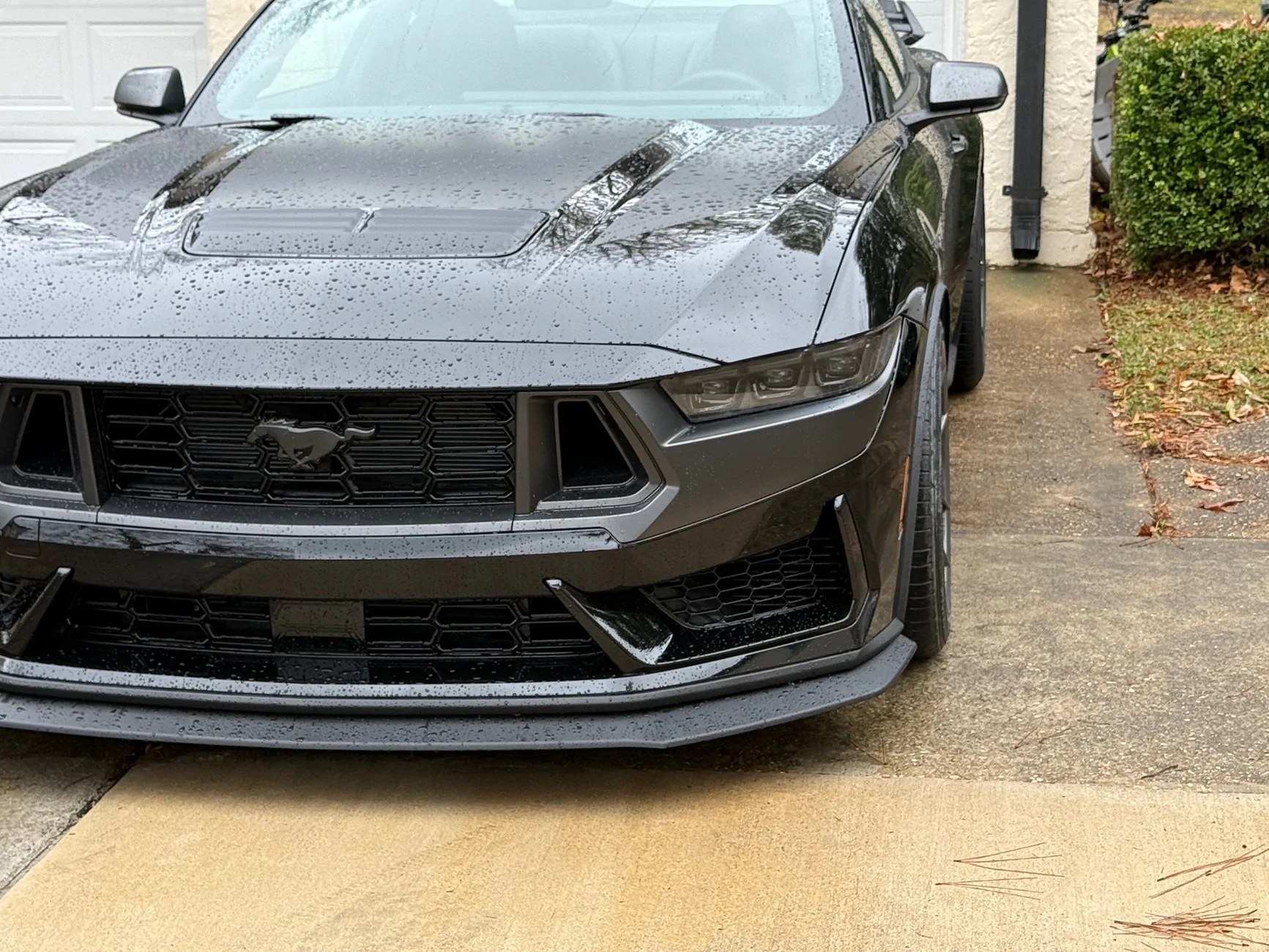

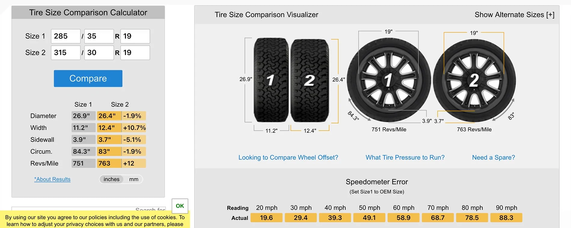

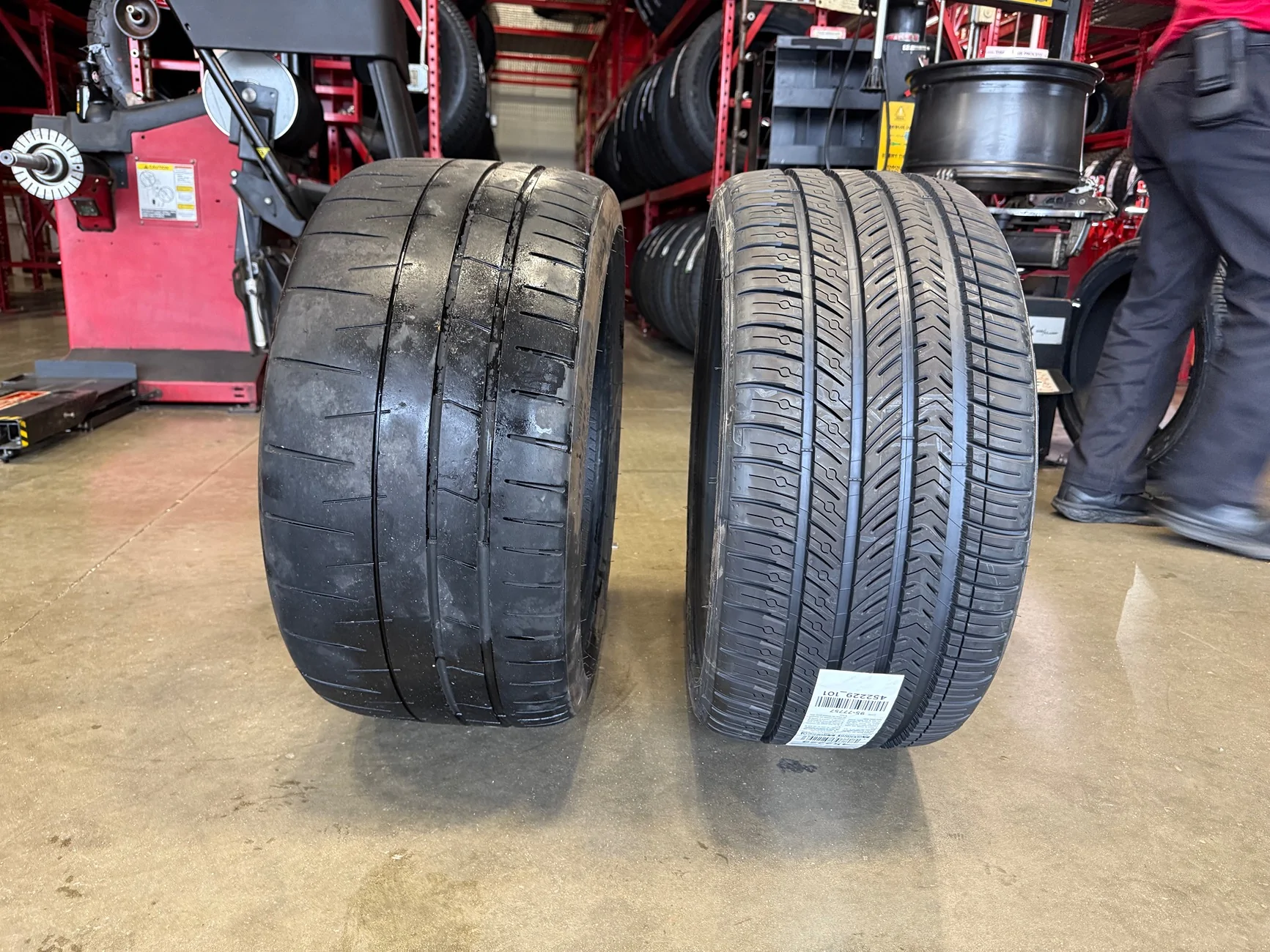

As requested, here’s a few pics, as well as a side-by-side of the front tires off (305s next to the 275s). I ended up going Michelin 4S All Seasons, 275/35/19s-F, 285/35/19s-R, factory rims. Still some poke as you can see from the pictures, factory HP DH rims definitely are more exposed but because the stock Trofeo’s are rounded, it’s only a very slight actual tread difference. Zero tramlining now, doesn’t throw as many rocks (you can literally see the small cuts in the trofeos if you zoom in, and that’s with only a few hundred miles). For dry roads there’s no beating the Trofeos, I’ll put them back on in the summer. Cheers!
S650 Mustang Dark horse HP winter tire question (275/35/19s-F, 285/35/19s-R) IMG_1211
S650 Mustang Dark horse HP winter tire question (275/35/19s-F, 285/35/19s-R) IMG_1212
S650 Mustang Dark horse HP winter tire question (275/35/19s-F, 285/35/19s-R) IMG_1209
