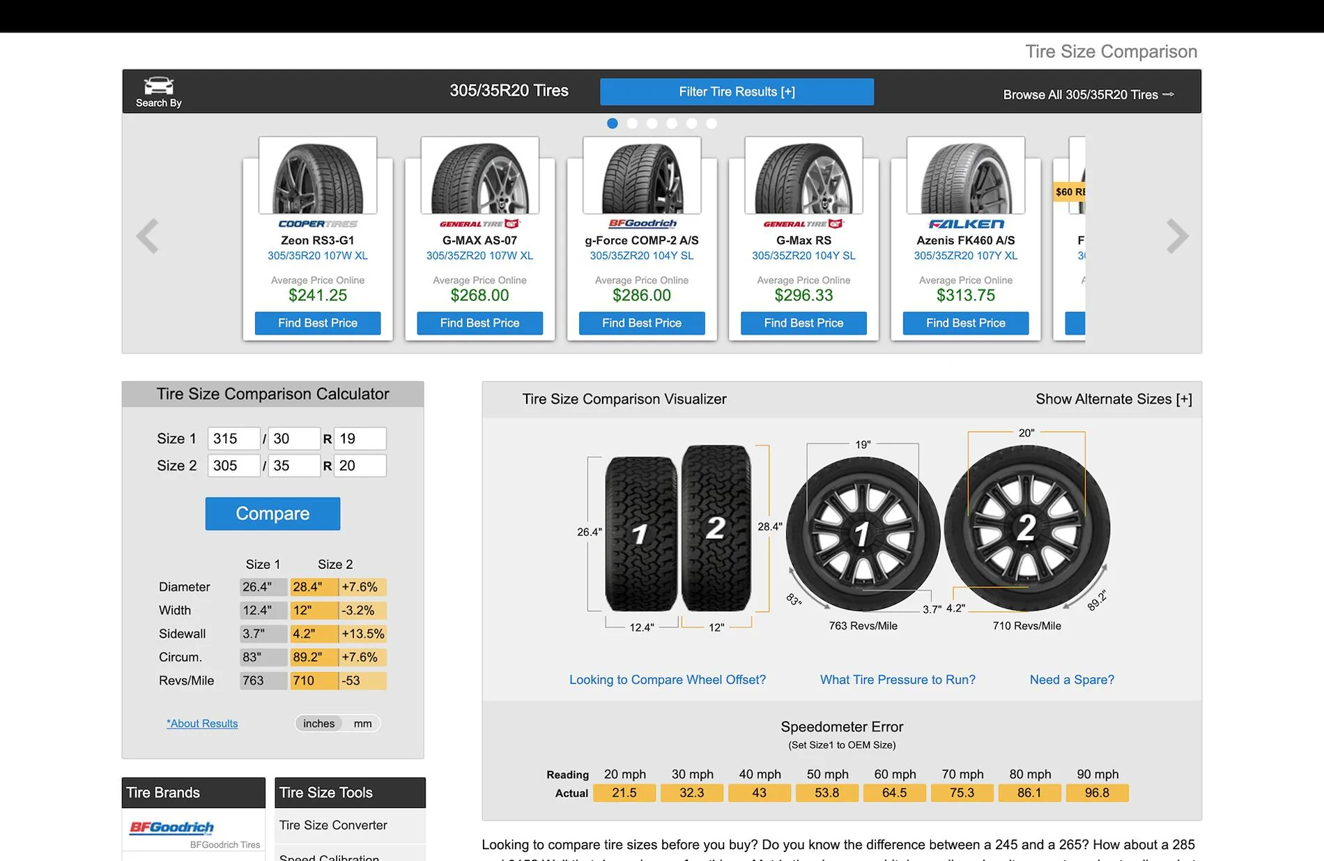

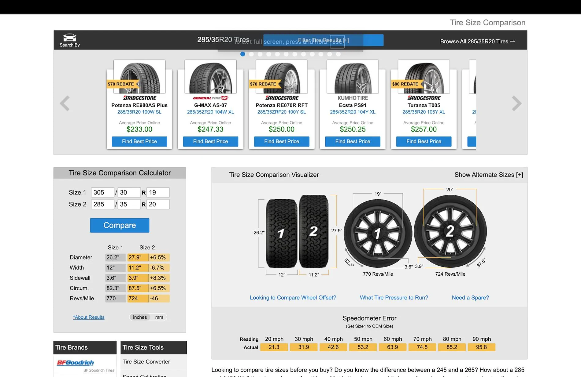

I'm attaching some screenshots, comparisons of your before/after tire and rim selections.
While I do not know what the limit is, the circumferences of your tires are more out than I'd be comfortable with.
In my example, I'm within 3%. In yours, you're more than double out. This gives weight to the Dealer wanting to put the car back to baseline before going further.
I cannot explain the delay in logic, why the car is struggling now. And the tire size difference might not be the issue. But we do not have data to say otherwise.
Hopefully, someone with a similar change will see this thread and offer feedback. Unfortunately, I suspect the Dealer will continue to want to operate with a known baseline, before proceeding.
A general rule to follow is to keep the circumference of the new set within 3% of factory. Otherwise, speedo, shift points, ABS, etc., can change, sometimes, not for the better. The vehicle is programmed for one thing, while the Owner has effectively changed the gearing to something else.
I cannot explain the delay in logic, why the car is struggling now. And the tire size difference might not be the issue. But we do not have data to say otherwise. We know what the factory programmed the car for, not what the limits of the sensors and logic are.
People can and do exceed limits all the time. Without issue. Maybe yours is a problem. Maybe not.

thanks Skye. If I change the rears to 295/30/20, the diameter is 27” & revs/min are 770. Much closer to stock. Would I need to change the fronts too
