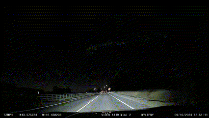

My wife was in a rear end collision, which was her fault. She was entering a roundabout and was scanning the traffic entering the roundabout when the vehicle in front of her slammed on her brakes. The lady indicated she likely had time to enter the roundabout but decided to slam on her brakes. At any rate, when my wife looked back from scanning for traffic, the vehicle ahead was stopped and she ran into the rear of the vehicle. Our vehicle has a camera, which recorded the accident. The GPS on the camera indicated our vehicle impacted the other vehicle at 25 mph.
My question to those with knowledge of the Pre-Collision Assist/Automatic Emergency Braking/Air Bags systems. Should the systems have been deployed?
Our vehicle alerts did not go off nor did the automatic emergency braking activate. Also no air bags were deployed.

That was about to be my comment, if you're already on the brakes for the roundabout it will assume you're awake and in control and will not intervene.
Also looking at the vid, the vehicle ahead is not directly in front until the last few moments. The systems tend to have quite a narrow field of view when travelling above a set speed as to not trigger by events in other lanes

NO Pre collision alerts activated. I have had the pre collision alerts work in the past tho. As indicated she was scanning the roundabout for traffic and when she looked back it was too late. I think the lady in front had her brakes slightly applied to slow her speed to enter the roundabout but decided she did not have time to continue so she hit her brakes hard which she did admit too. Still not her fault my wife could have been more alert to the situation. Just trying to understand why the system did not work
