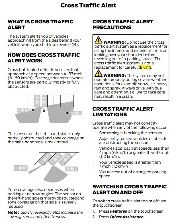

It's a little misleading to call the rear "pre-collision" sensors. What they're referring to are the little radar "pucks" that help figure out how far a car is behind you when you're backing up. With the use of the BLIS sensors and the rear sensors, the car can determine if there's a car approaching from the left or right of you as you're backing up. I do not see any mention of "active" collision assist i.e. applies brakes for you automatically.

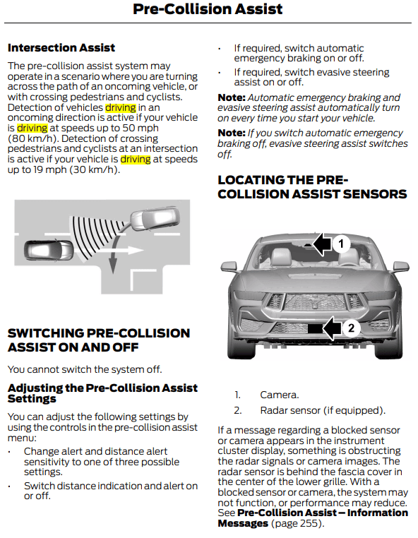

The front pre-collision assist includes both radar and a camera. It is ACTIVE, meaning it can and will apply brakes or steering input to help mitigate a crash.
