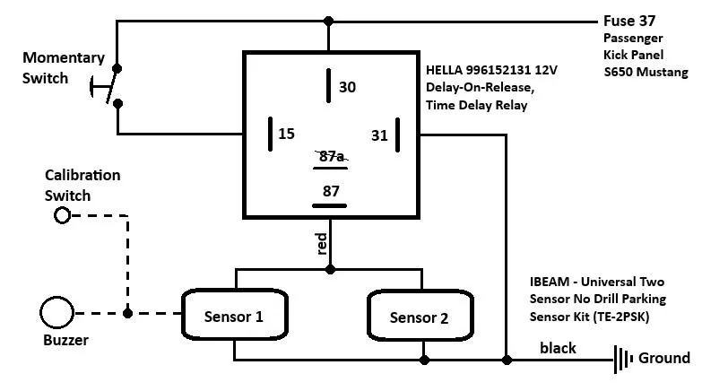

On the relay, run positive supply from fuse #37 in the passenger footwell to terminal 30. Terminal 31 is ground. Terminal 87 connects to the red power wire in the sensor harness and is powered for whatever length of time you set (15 to 20 seconds should be enough to park). To adjust the time delay, I wired up a light bulb on the bench and tinkered with the dip switches and little screw till I got it to about 20 seconds before installation (which also helped confirm the terminals). Terminal 87a is not used. For the momentary switch, run positive to one pole and the other pole connect to Terminal 15 on the relay, that's your activation.

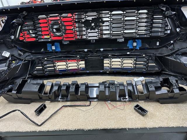

Below shows the sensors themselves mocked up in position inside the front bumper cover with blue painters tape (measure thrice, cut once kinda thing). Also, I cut off two of the soft plastic nodules from the impact absorber thingamajig to make room as you see the scraps lying on the table.

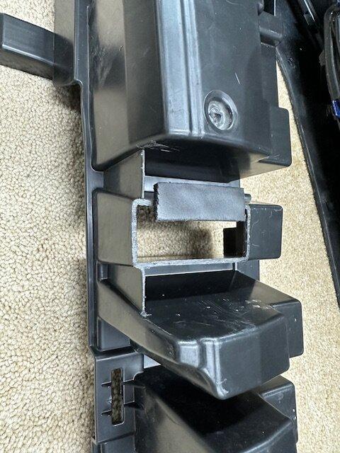

Also, before reinstalling the impact absorber thingamajig (it sort of snaps into place with a half dozen or so little locking tabs), I put in a little piece of quarter inch foam insulating tape on the back of each sensor, which serves to help hold the sensor in position in case the small surface of double-sided tape that holds it to the inside of the bumper cover doesn't last forever. I couldn't really get a picture of the foam installed due to poor lighting, but shown below is where the sensor winds up positioned relative to the impact absorber and the foam approximately where it sits installed.

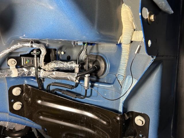

Under the left front fender there is a wiring loom boot/grommet that actually had space for two looms to pass through but stock only had one. I.e. cut off the little nipple and pass a second loom through. Possibly on a GT or Dark Horse, that second space already has another loom for additional features, I don't know. But it was available on this Ecoboost anyway. Ford saw fit to put heat shielding on the existing wiring loom in this position, so I followed their lead and put the same sort on my parking sensor loom. The provided ground wire reached just about that far so I found an unused hole in a nearby bracket to the upper right, scraped a tiny little bit of paint off around it and grounded it there.

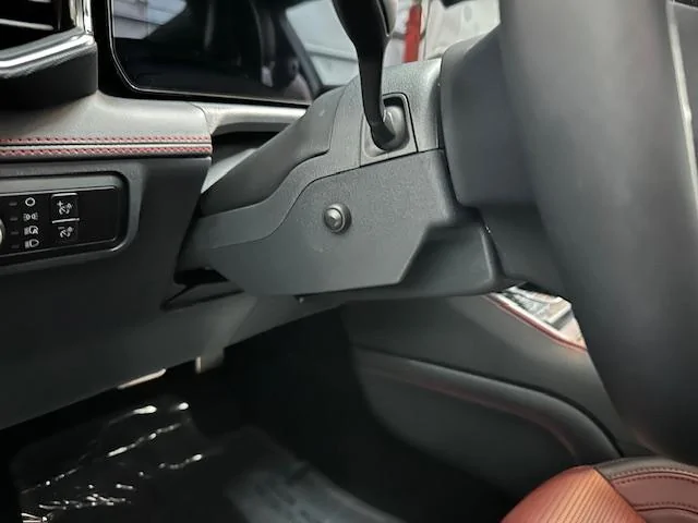

Here is where I put the momentary switch for activation. Very convenient! I chose a plain black button, but one that kinda sticks up just a little so that it would be easy to locate just by feel. If you didn't know, you'd think Ford put it there. Just had to make sure that the wires didn't foul on the steering column locking lever, but as I said in the previous post, there's like a quarter of a cubic foot of room inside that steering column housing.

And here's the wiring diagram. The dashed lines are just part of the harness. Find a place to put the buzzer and calibration switch and run the harness there, but you don't have to think about the wiring for those. The only things to figure out are the red + and black -, where you are going to pull keyed power from, your activation button and relay as I've diagrammed how I did it below.
