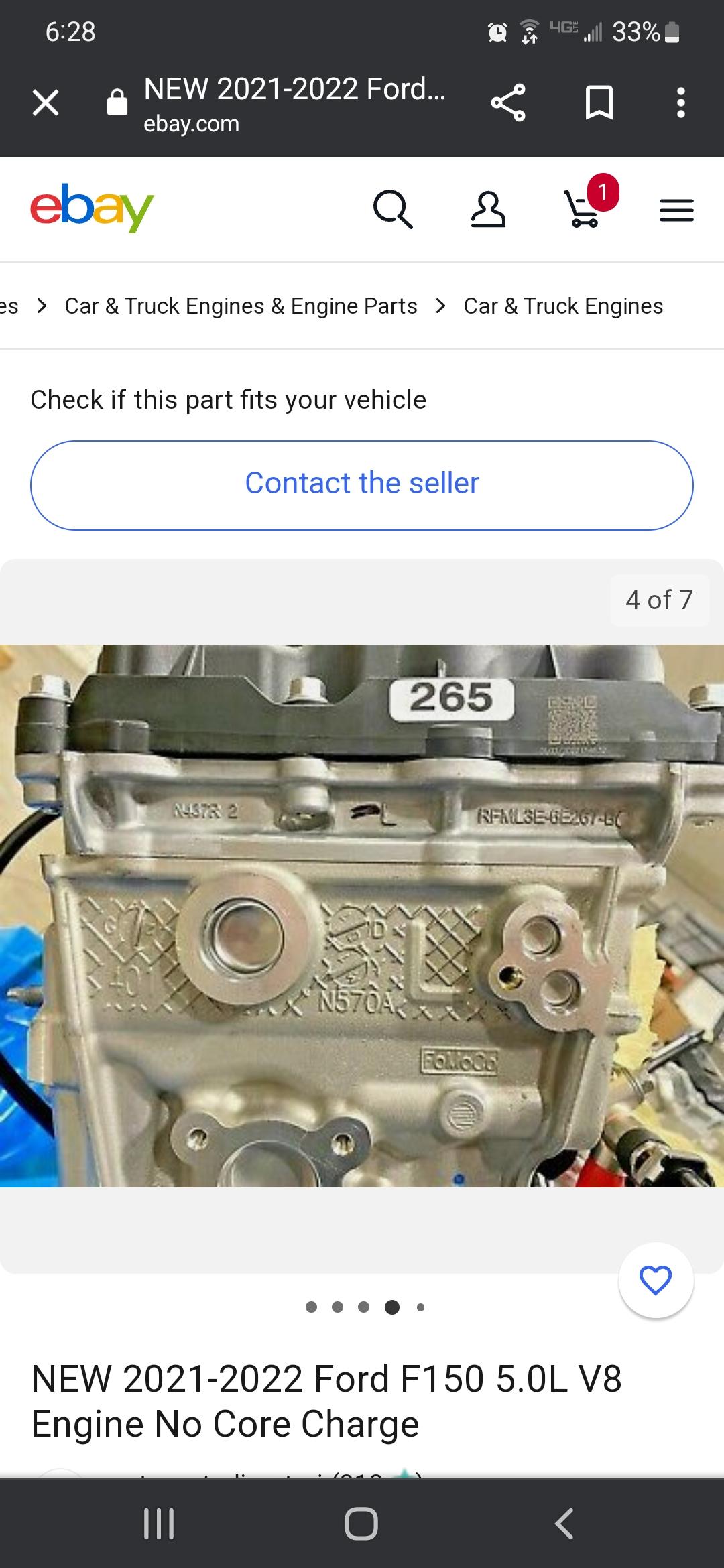

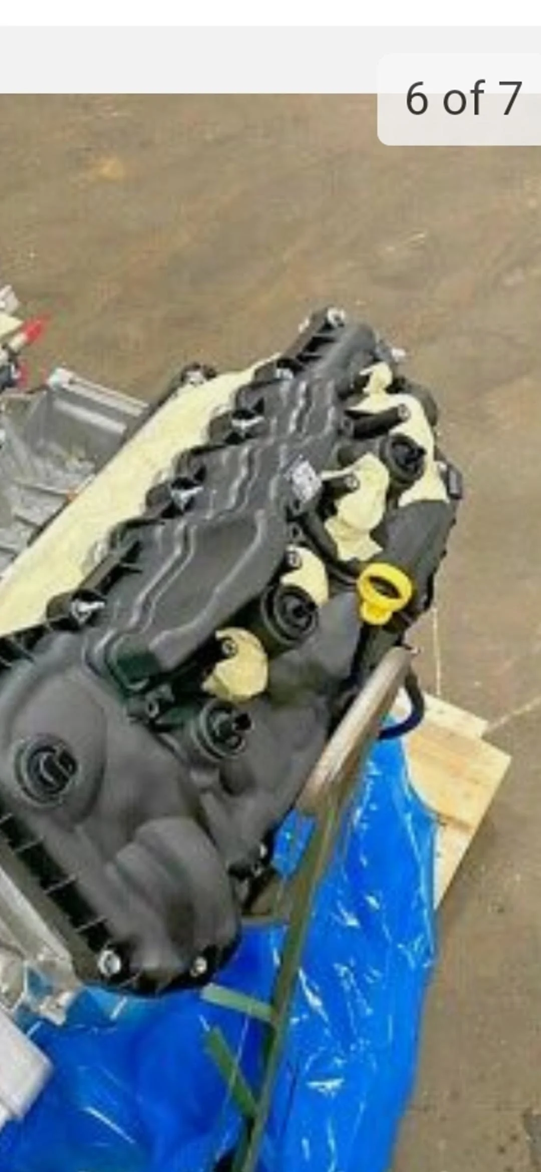

here you can see the solenoids between cyl 5 &6 and 7&8 and a spacer plate between the valve cover and head most likely used to divert oil away from the lash adjusters to bleed them down like the ls and lt

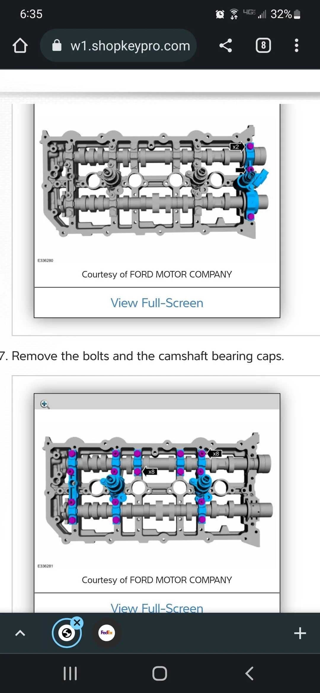

the cams no longer bolt to the heads like a normal 5.0 they go on the spacer plate

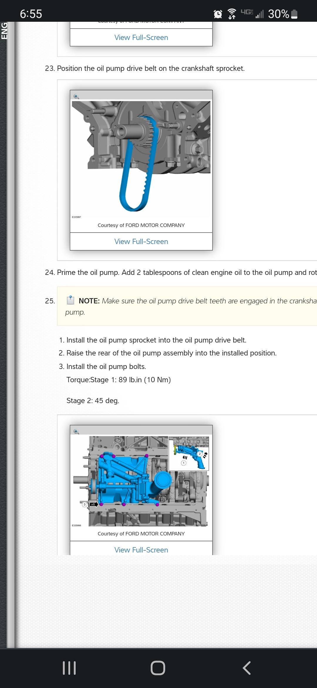

and it looks like they may have fixed the oil pump gear issue

A lot of the f150 boys consider it to be a gen 4 coyote and it kinda is. They changed a lot of stuff in 21 on the 5.0. External oil pump, cylinder deactivation and some VCT changes it’s really more like a 3.5 generation
