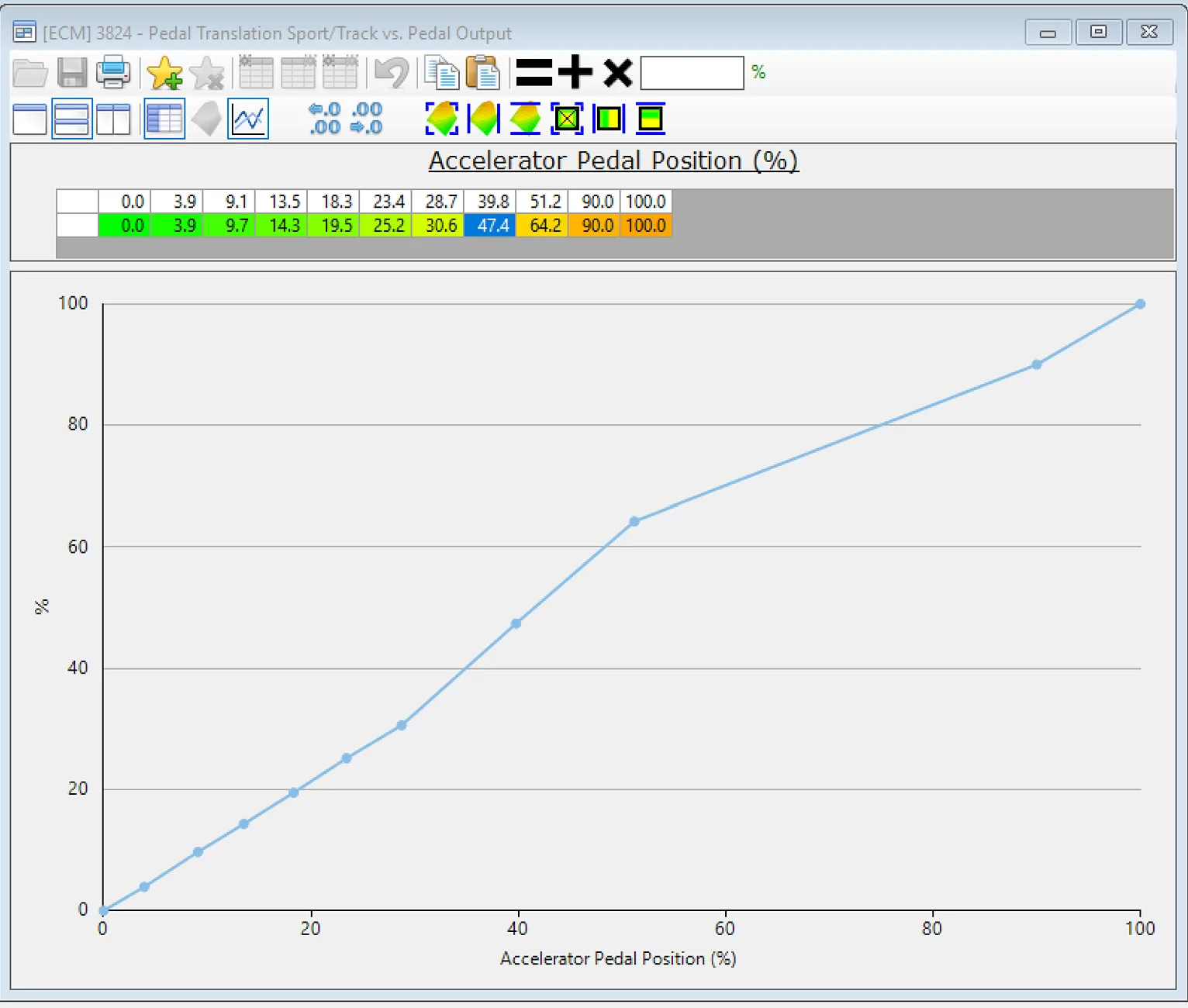

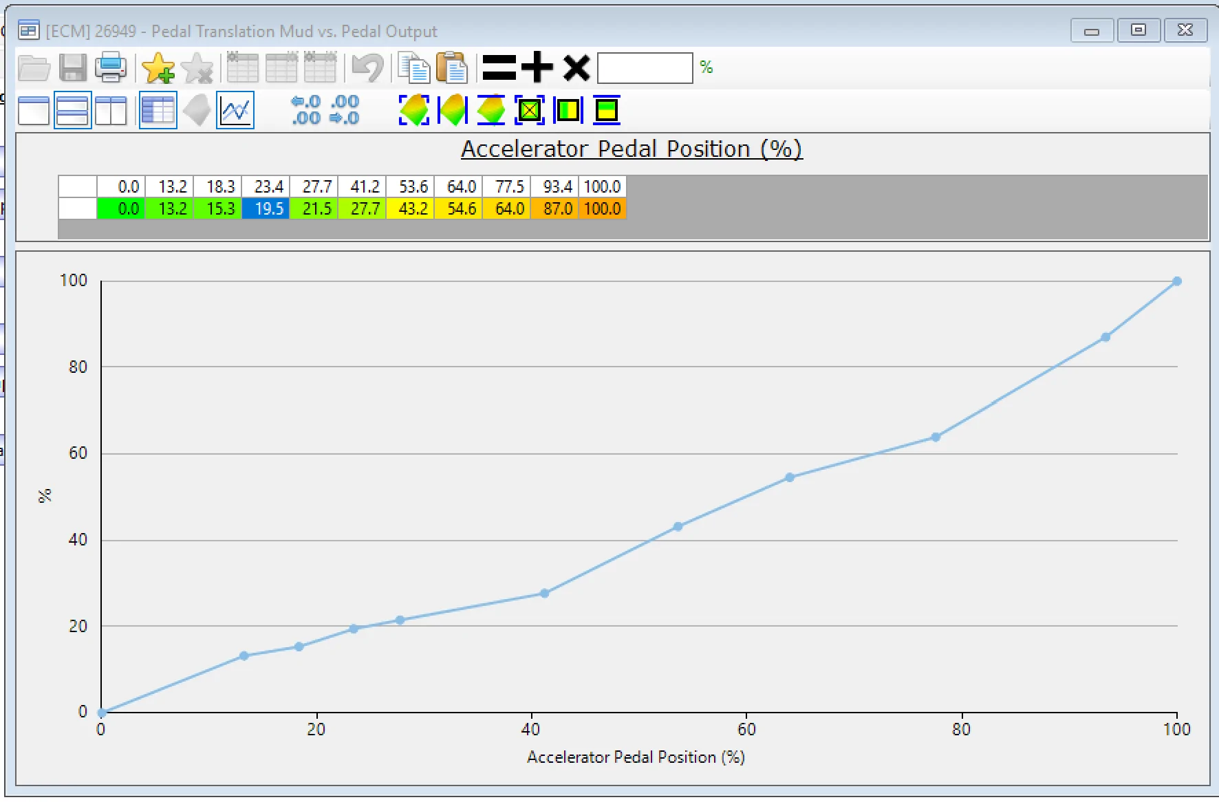

I plan to try out your tunes. I find the throttle is so laggy specifically in track mode with the manual…. Way laggier than sport
This is your track mode pedal map. Pretty weak. Needs to be beefed up in the low/mid range to get that car moving under part throttle.
S650 Mustang Who’s got the spiciest tune? 1772507842521-0c
Compared to sport.
S650 Mustang Who’s got the spiciest tune? 1772507903369-bt

Which explains why on a race track you should be in Track Mode.
Pushing hard on the brakes prior to entering the turn, off the brakes, turn the wheel, roll gently onto the throttle, hopefully late turn in and late apex, and as you pass the apex and begin unwinding the steering, you are rolling harder onto the throttle.
The goal is to be on the throttle as early as possible, as hard as possible, but without turning sideways and going off the track backwards and into a wall.
As the rear begins to lose grip however, you will need to adjust your throttle input.
There are two issues the Track Mode pedal map addresses. The first is not losing grip due to not having aggressive throttle mapping at part throttle, e.g. in Sport Mode. The second is being able to better adjust the throttle without having to lift completely should the car begin losing grip. Just keep the pedal right where you need it with small adjustments, maximum throttle for the grip available.
If you look at half throttle (pedal position 50%) for Track and Sport on the maps ZX Mustang posted, you see the difference immediately. Track is at less than 40% throttle opening (like high 30s). Sport has whacked that throttle open to over 60%. You can see why that sudden throttle opening might be less than desirable when at maximum cornering grip trying to get a high exit speed off a turn and onto a long straight away.
Also that range at partial throttle means you can make tiny little adjustments to the throttle with larger pedal inputs, whereas Sport means bigger, sudden adjustments even with less movement of the throttle.
(ZXMustang already knows all this - the post is not addressing him. I just quoted his post because he put up those maps on which I am commenting - and he is the only member to ever post the pedal maps for us, so thank you)
