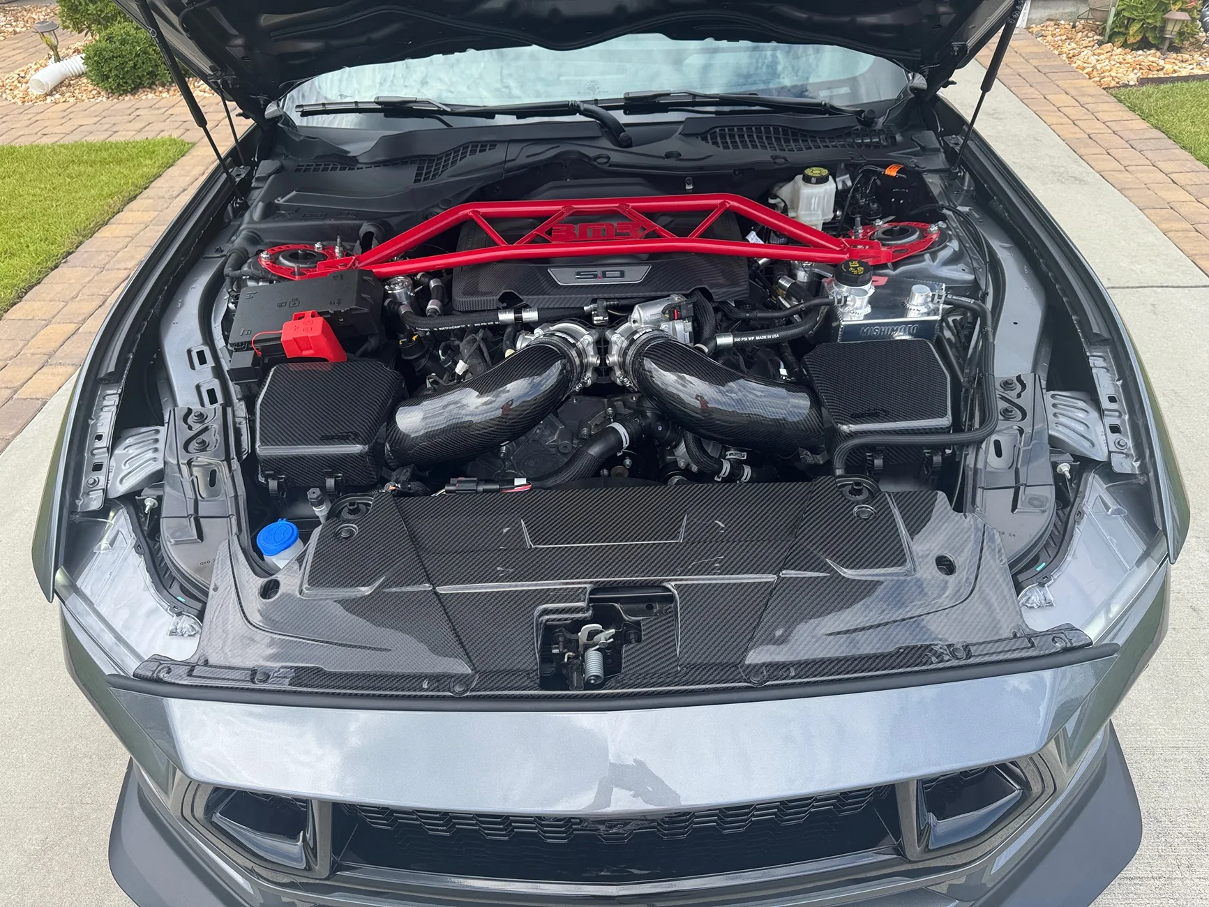

I just installed the PSE Motorsports cold air intake
S650 Mustang CAI & Tune gains? IMG_5544
