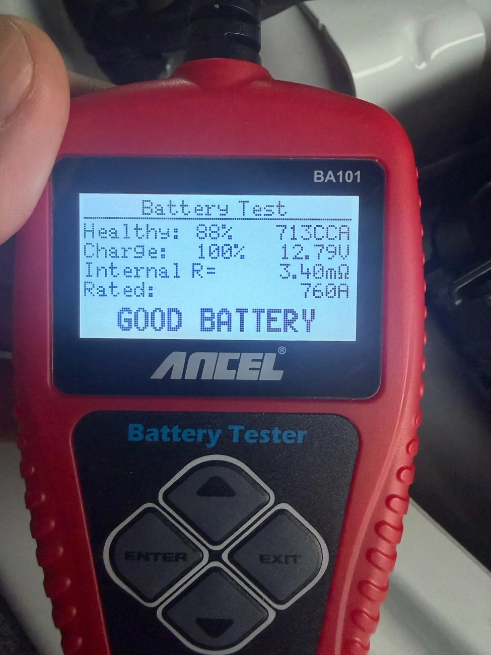

I did a battery test and it's 72% life so its bad and should be covered under warranty.
They want me to bring it in but I don't trust dealerships so I'm trying to do the Mobile tech thing

If it gets out of sync with the bms it will display messages incorrectly. By chance did you try charging the battery independently (disconnected from the car) and then resetting the bms?

I read how to reset the BCM for new battery but have not done it on the existing battery.
I did hook my Noco smart charger up around noon yesterday and did another test this morning to see where it's at... what do you think?
I’m not gonna say the numbers don’t look decent (who knows what’s on the other end - not pointing just noticing) but that’s where i’d start. Get ‘your’ numbers, charge, reset bms, get ‘your’ numbers and then monitor according to your established baseline.

I'm just saying in general, updates are released without testing properly in all different fields these days. Especially in the field I work in .. Motorola releases updates and breaks shit all the time and then we wait months for a fix. humans are the test monkeys rather than dong proper beta testing,
Anyways, after disconnecting the battery like they asked ( which took literally 3 minutes ) the problem came back .
Also my battery tester went from 72% to 88% and back to 72% so its all over the place.
Mobile tech is coming Thursday afternoon with new battery as it may be a bad cell.
I still haven't decided if I want to do a software update as I'm tuned and don't want to reflash.
Thanks for the Mobile tech idea... I do not want to bring my car into the shit show of a dealership I have here locally and risk a mistake by some monkey in there.
