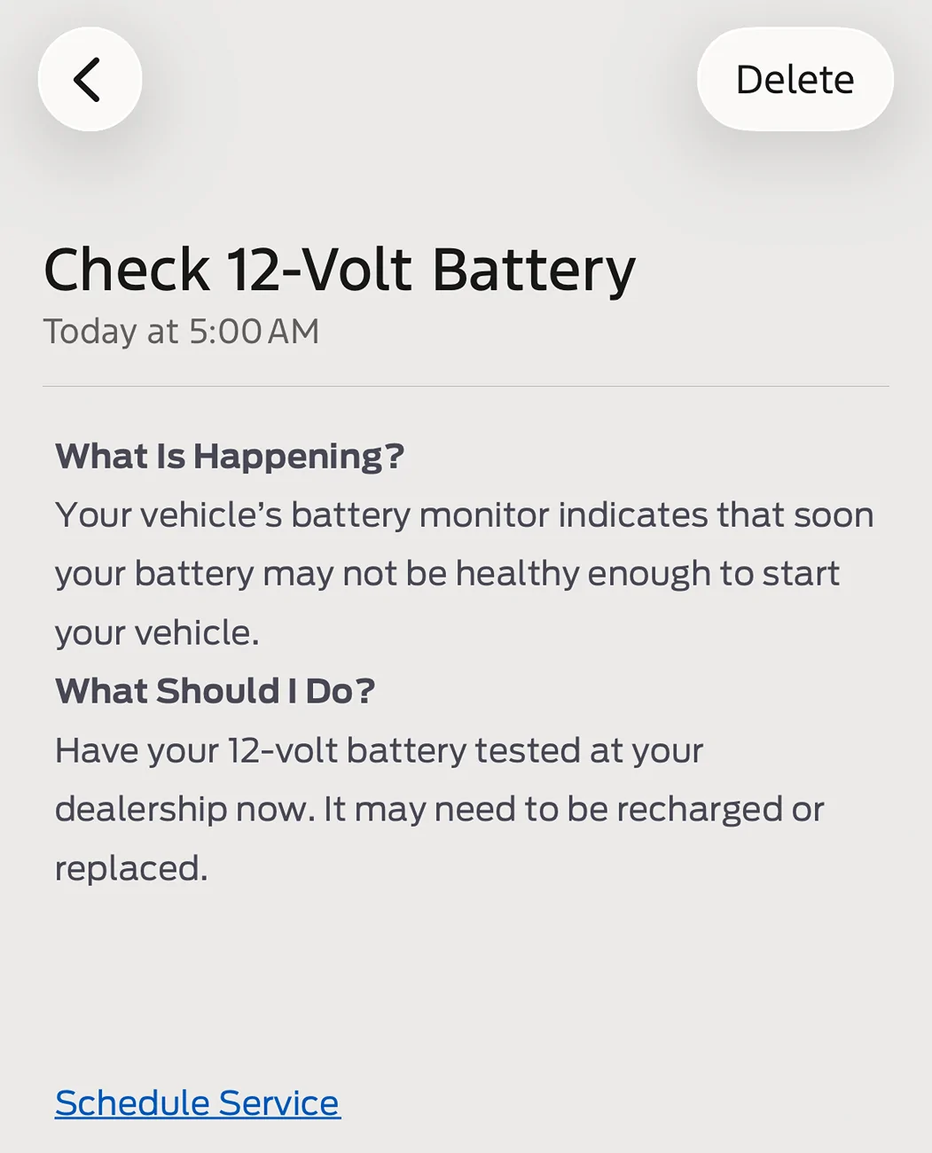

Anyone else gotten this message before? This is the original battery on a car that's less than 2 years old. Hoping I can get it replaced under warranty.

Take it to a dealer. They'll do a diagnostic. Then a determination can be made.
You can also test the battery and charging system yourself if you have a multi meter. It won't be as comprehensive as what the dealer can do but it can give you a general idea of battery and charging system health.
If you have any aftermarket equipment like an amp or anything tapped into your wiring there could be a short. (If applicable)?

Just had my GT in for a test last Thursday (4/9/26). I've had a few battery warnings/prompts on my screen ever since our bad cold spell in February. Free test as noted above; my battery is OK; though a bit low.
BTW: My dealer said if the battery goes under spec, or croaks during the initial 3 year/36 K mile OEM warranty it's covered under warranty.

Confirming this is the case. Dealership said it didn't pass their tests and replaced it under warranty.
