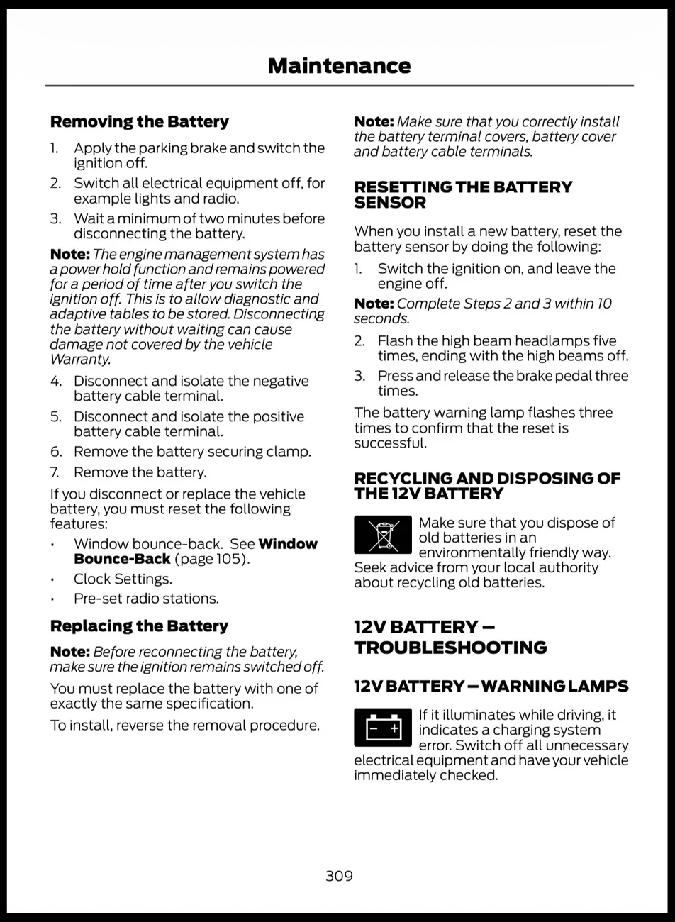

Don’t forget to reset the bms

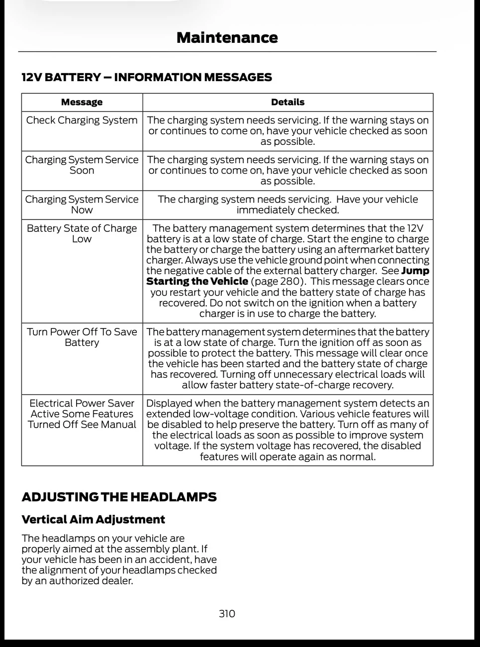

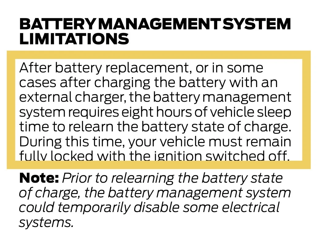

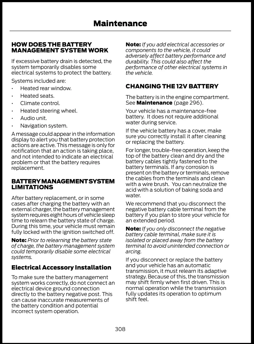

Is that the Forscan option to clear the codes?
S650 Mustang Battery Voltage Question IMG_8492
S650 Mustang Battery Voltage Question IMG_8489
S650 Mustang Battery Voltage Question IMG_8490
S650 Mustang Battery Voltage Question IMG_8491
