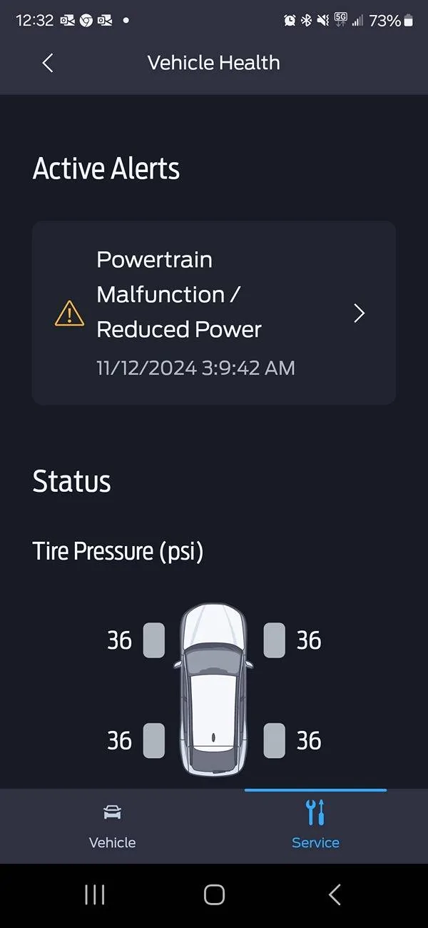

I am having same issue, mine does it just sitting in the garage
S650 Mustang Voltage fluctuation issue 1000002733
I bet the battery will test fine, im going to have it check

By chance have you tried a recharge and bms relearn?
